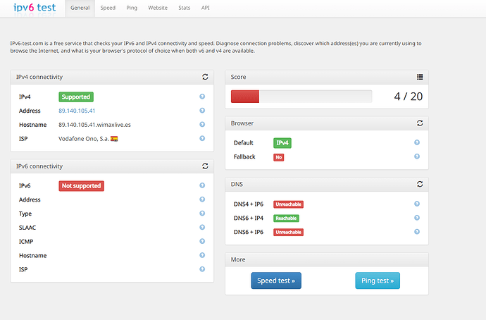

Yes, you are right, that address there was just a desperate test. At the beginning I put there my router ip. Anyway, I tried to test my ipv6 connectivity with an online test and I guess I dont have it. I tried leaving blank the field you told me and repeated the test and the situation didn’t change a bit…
I mean: I repetead the tests on the server!
