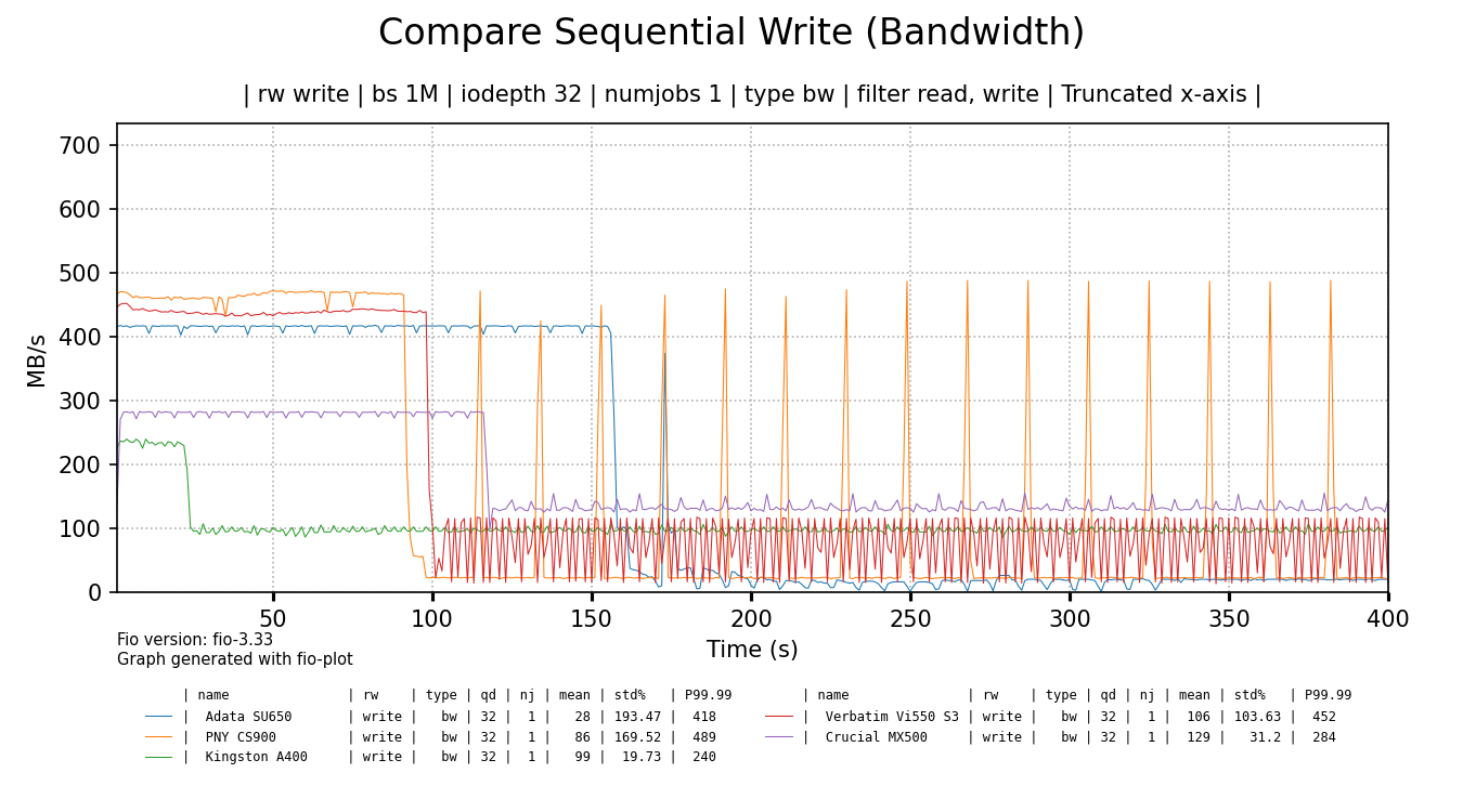

It doesn’t even have to be sync writes to see this behavior. Less-expensive consumer SSDs like the BX500 and that Emtec often employ pseudo-SLC caching behavior, and when that internal cache runs out or needs to be flushed, you see the drag on performance:
Image source: Benchmarking cheap SSDs for fun, no profit (be warned)
