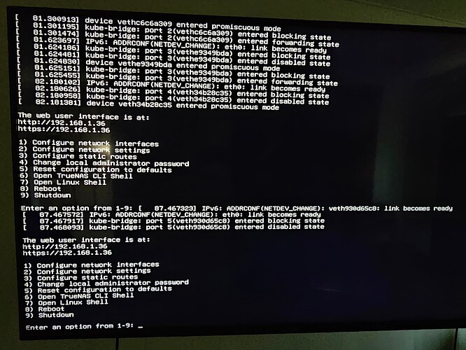

The server boots up normal and gives me the normal screens. The 1-9 options dont know if i need to reinstall truenas but i cant access my storage drives on the server through my windows pc remotely at all. When i get off work ill post some screenshots

Does it show a WebUI IP address?
What do u mean?
Yes mine looks exactly like that
So to confirm the IP address shown does not connect when you put it in the browser? Just checking you are not using a hostname to try and connect

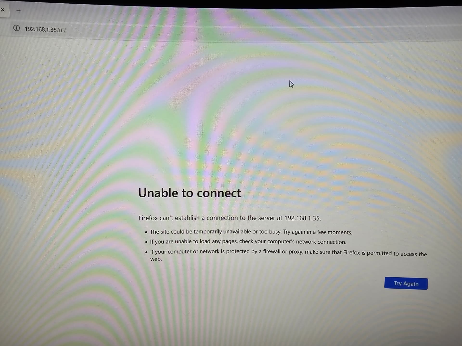

So when i log onto my server on my network drive it comes up with the enter network credentials with the right password an it tells me the network password is not correct and trying to log into the server through firefox it says unable to connect firefox cant establish a connection to this server
The address shown there is 192.168.1.36; the Firefox screen shot shows you’re trying to connect to 192.168.1.35. That isn’t going to work.
