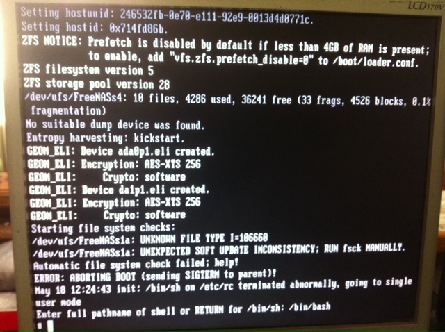

I recreated the FreeNAS installation, but the pools could not be imported or seen as I think they were changed by the prior TrueNAS importation.
