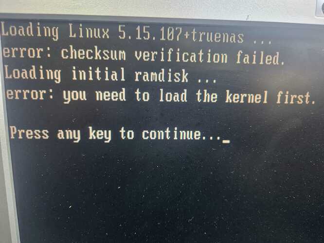

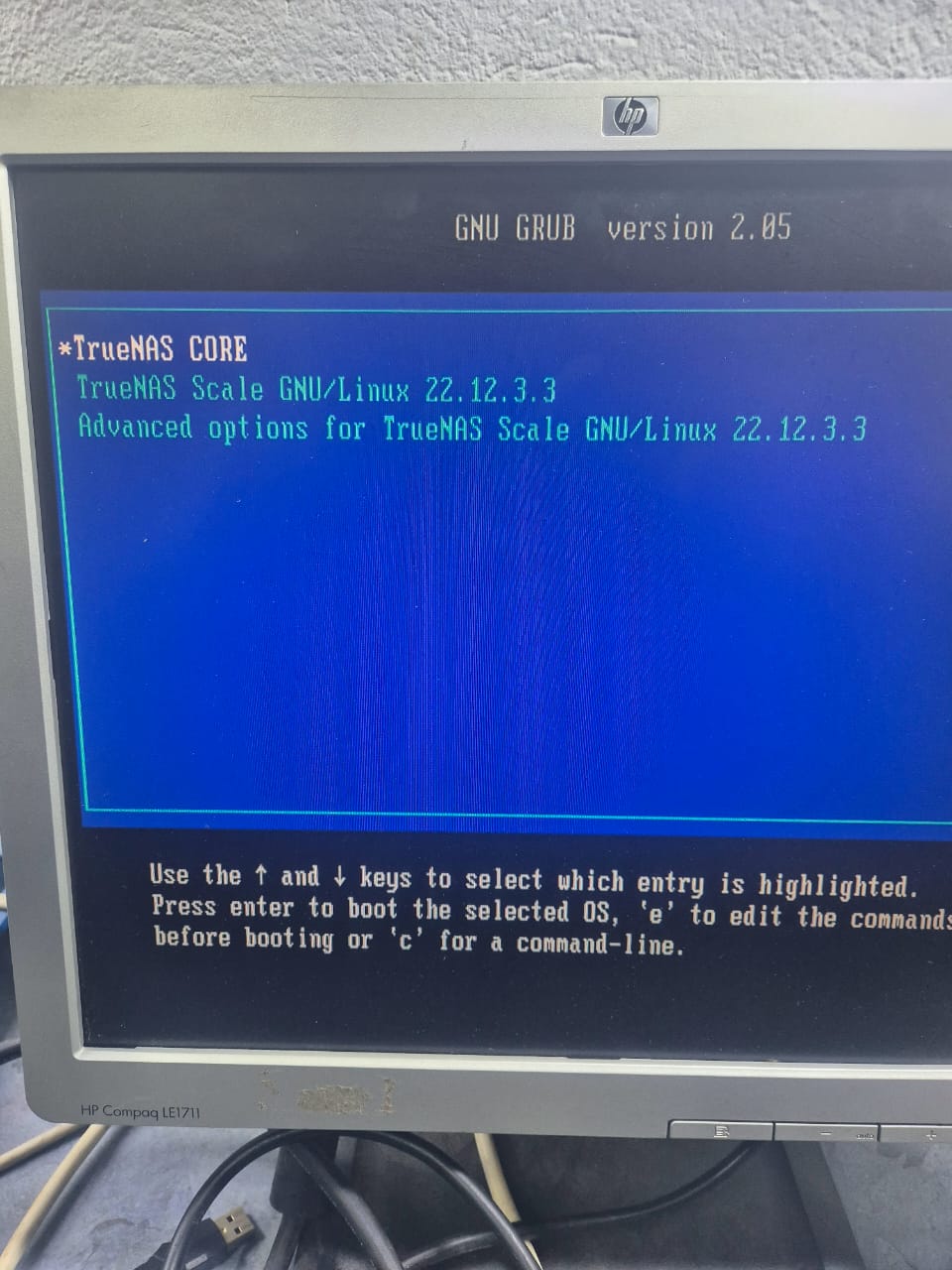

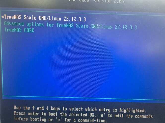

One of them is now acting up, it looks like after an update or something it will not boot (go past the GNU screen, no matter what option I choose) - even TrueNas CORE same error…
Linux 5.15.107+truenas
error: checksum verification failed
Loading initial ramdisk ...
error: you need to load the kernel first

If I had to guess, you or someone else probably ran zpool upgrade -a or zpool upgrade boot-pool at some point. What you are seeing looks very similar to what I’d expect to see.
See: FWIW: When it says "Don't upgrade the boot pool", they are not kidding! | TrueNAS Community

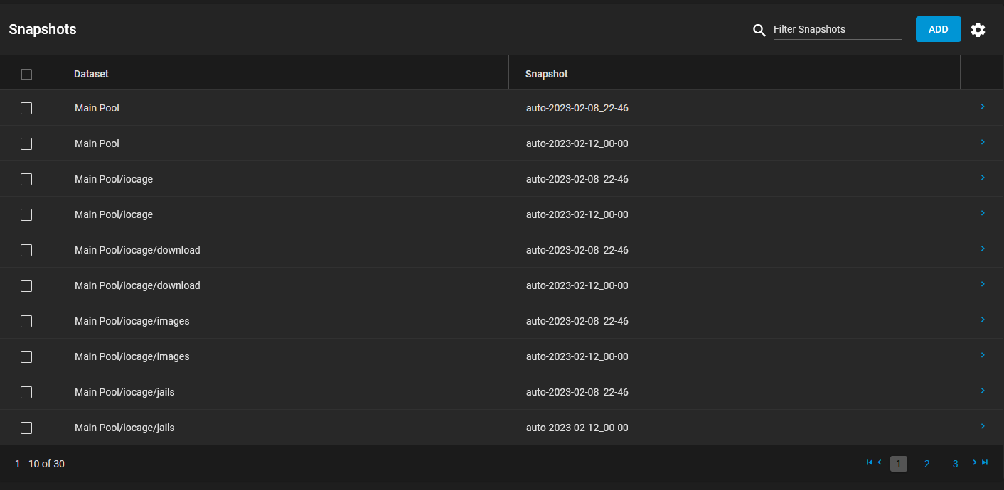

  3. I have SNAPSHOTS, can I delete these? They are from 2023 and lastly how do I re-setup the SNAPSHOTS… Once a month or so…

Here’s an excellent basic primer on snapshots from @winnielinnie . Whether or not you want to delete them is up to you. I have a daily scheduled snapshot task and I store them for two weeks.
