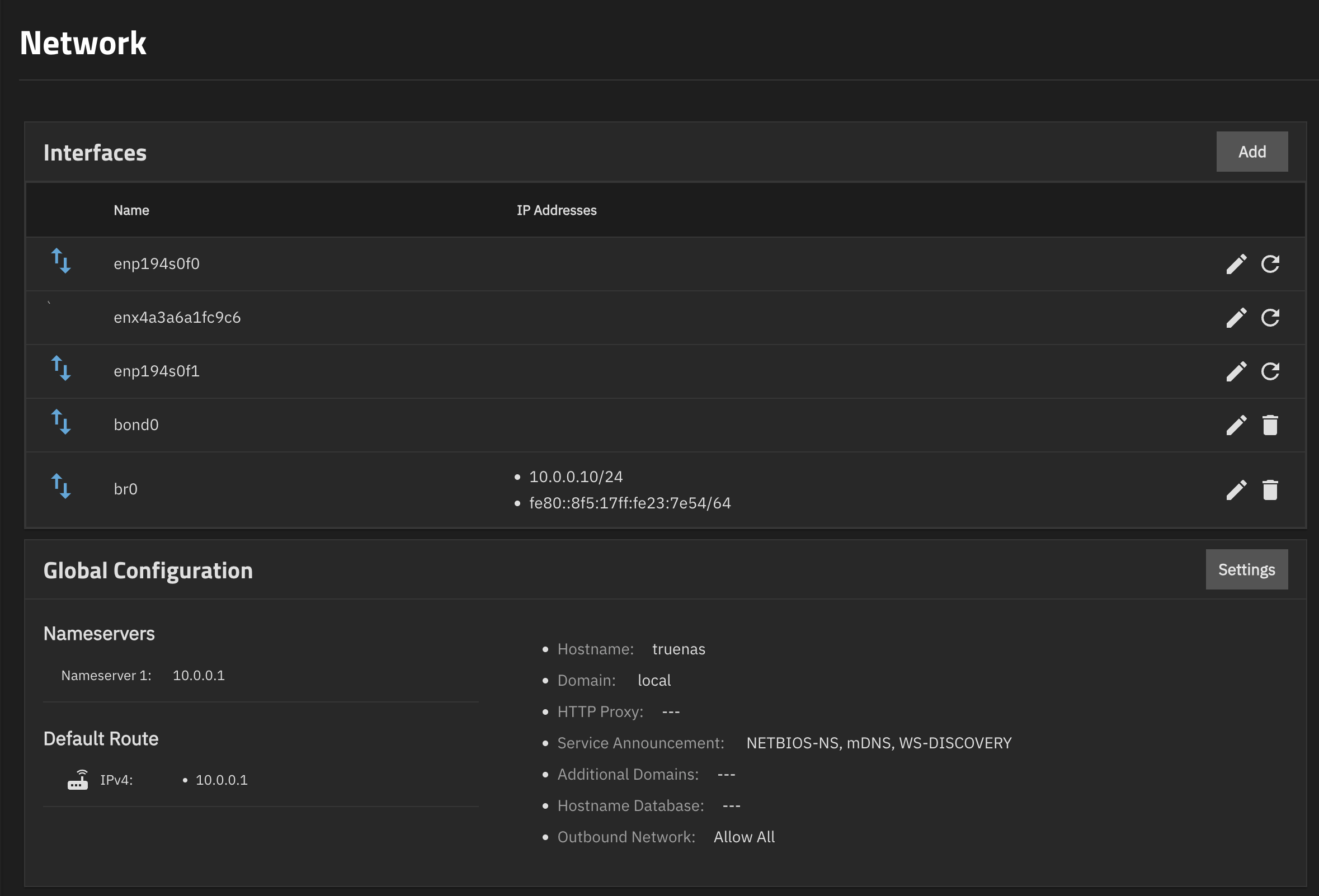

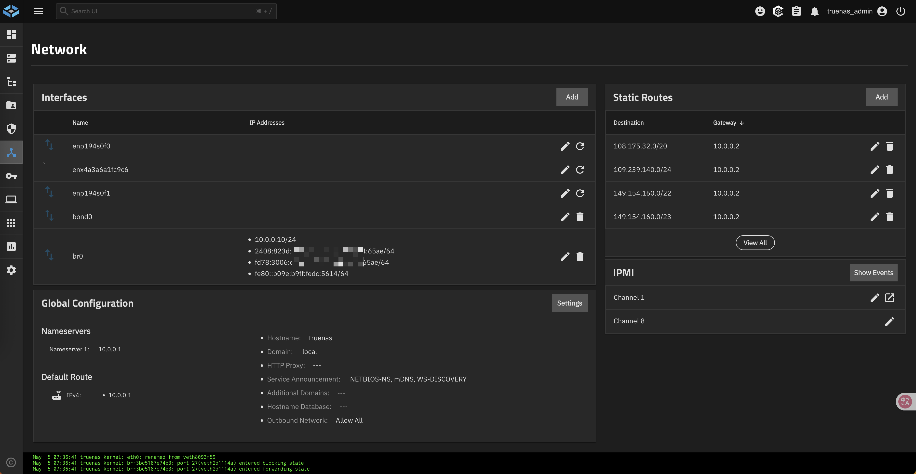

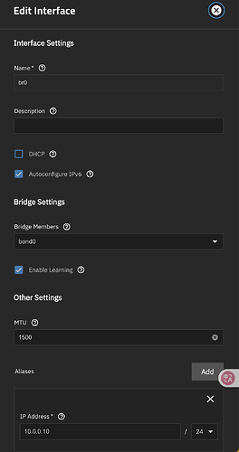

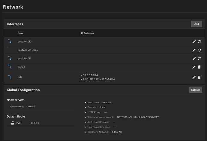

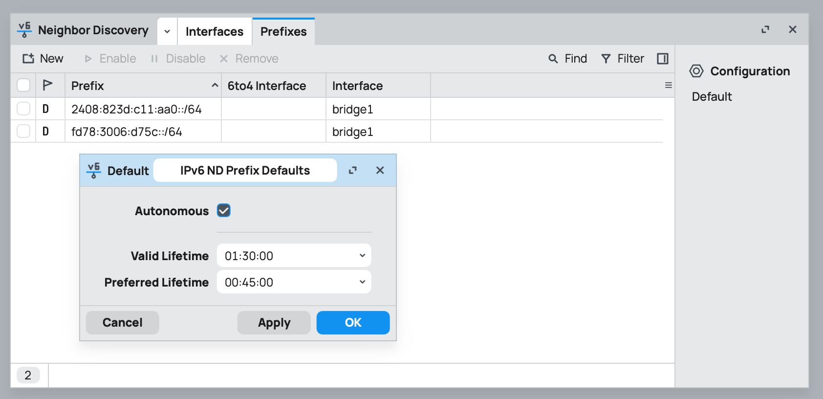

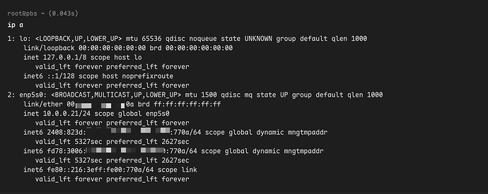

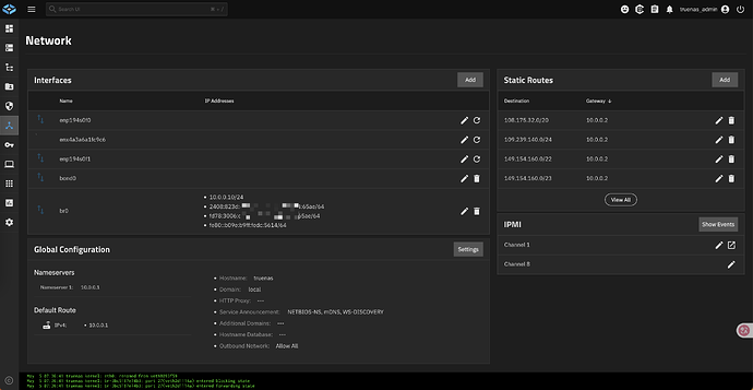

I encountered a rather peculiar issue. My routing system is running Mikrotik’s Router OS, which configures IPv6 via SLAAC. The router has correctly obtained the IPv6 prefix, with the maximum Valid Lifetime for IPv6 addresses set to 90 minutes. The NAS system is running version 25.04.0, and its network configuration includes a br0 interface configured with a static IPv4 address and the “Autoconfigure IPv6” option checked. Upon system startup, it correctly acquires a GUA (Global Unicast Address). However, once this address expires, the system fails to obtain a new IPv6 address, leaving only the IPv4 address and the FE80 link-local address. Interestingly, the IPv6 addresses of the Instances using the same bridge do not exhibit this problem.
Do you all have any suggestions? If more information is needed, I can also provide it.

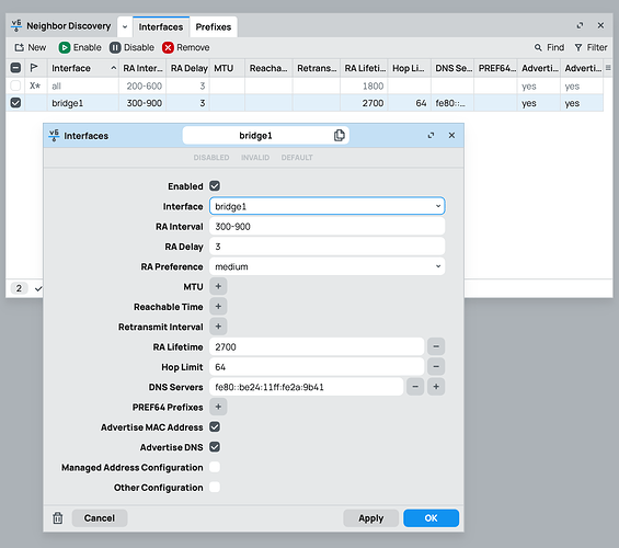

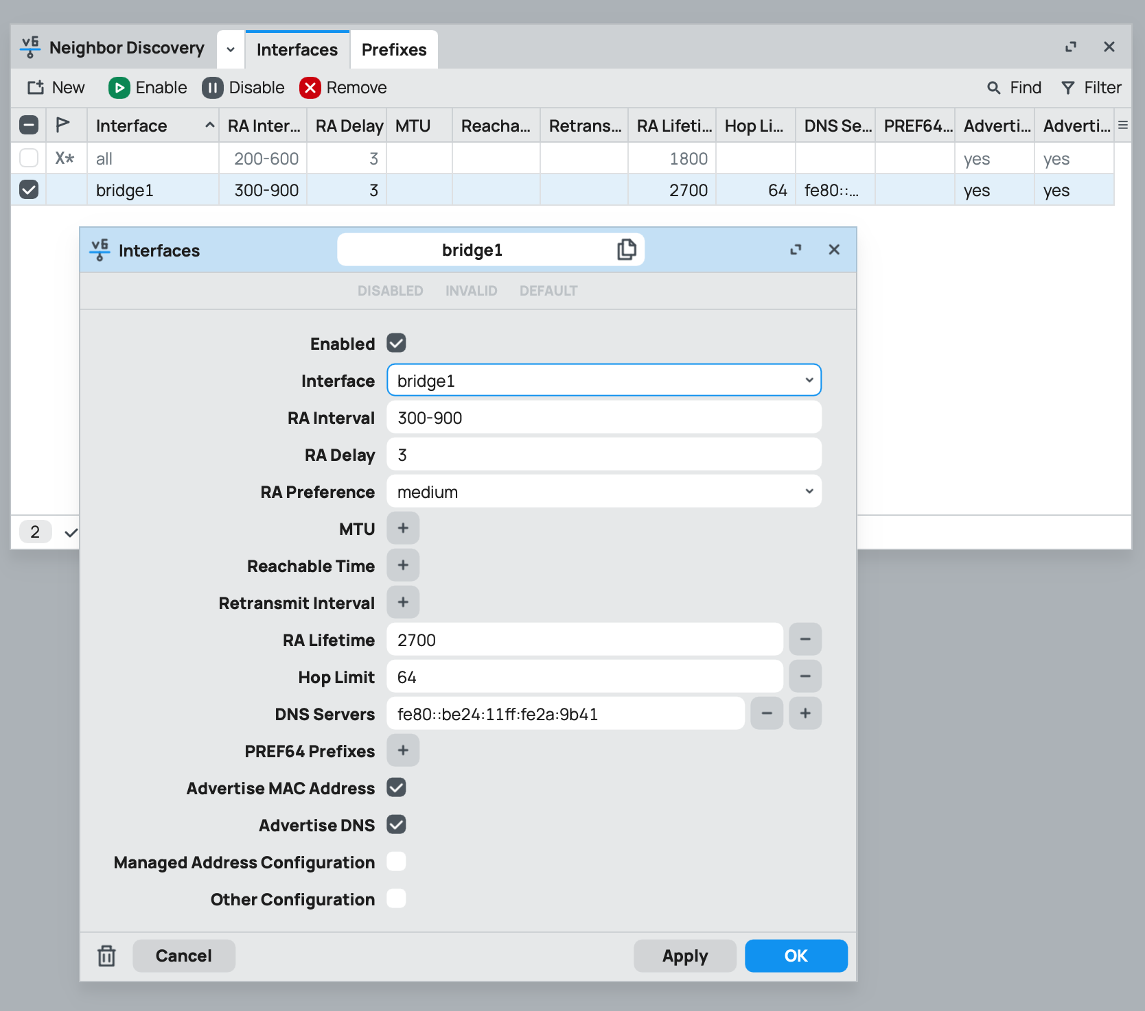

Below is the IPv6 configuration on the router.
Network status after restart

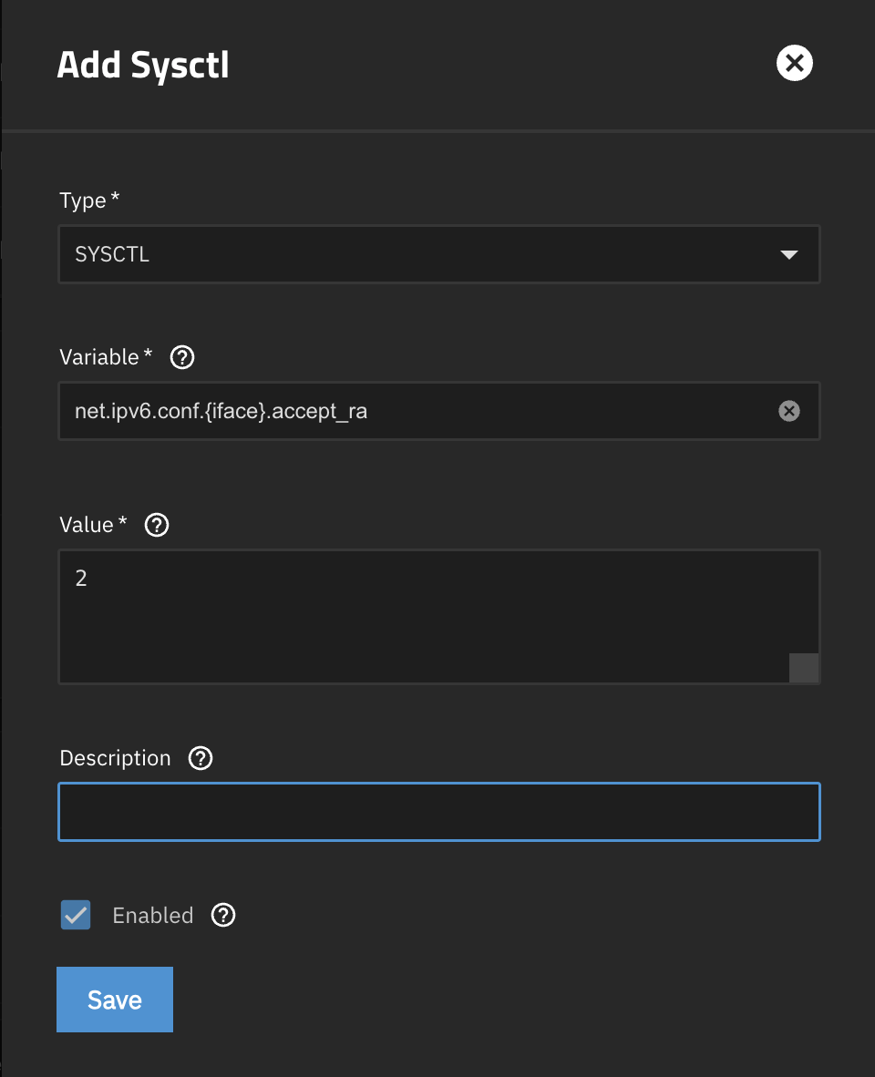

After comparing the IPV6-related sysctl parameters, only one parameter, net.ipv6.conf.{iface}.forwarding, differs. The normally functioning machine does not allow forwarding, whereas TrueNAS permits it by default
Possible values are: 0 Forwarding disabled 1 Forwarding enabled
FALSE (0):
By default, Host behaviour is assumed. This means:
  1. IsRouter flag is not set in Neighbour Advertisements.
  2. If accept_ra is TRUE (default), transmit Router Solicitations.
  3. If accept_ra is TRUE (default), accept Router Advertisements (and do autoconfiguration).
  4. If accept_redirects is TRUE (default), accept Redirects.
TRUE (1):
If local forwarding is enabled, Router behaviour is assumed. This means exactly the reverse from the above:
  1. IsRouter flag is set in Neighbour Advertisements.
  2. Router Solicitations are not sent unless accept_ra is 2.
  3. Router Advertisements are ignored unless accept_ra is 2.
  4. Redirects are ignored.
Default: 0 (disabled) if global forwarding is disabled (default), otherwise 1 (enabled).
So the temporary solution is:
System → Advanced Settings → Sysctl → Add
net.ipv6.conf.{iface}.accept_ra = 2
I also submitted a bug report to ix.
https://ixsystems.atlassian.net/browse/NAS-135715
