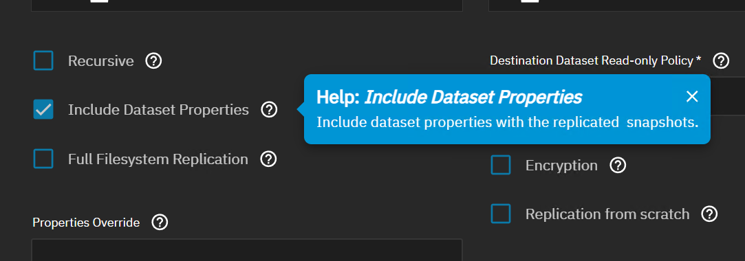

Thanks for the hint @NickF1227 - zfs send/receive does the trick
Edit: I noticed the zvol had a Provisioning Type: Sparse after using send/receive to restore it. I was able to set it back to Provisioning Type: Thick using zfs set refreservation=auto pool/zvol
Lol its funny that you mention that. This is an example of where TrueNAS GUI defaults differ from default ZFS. Sort of a guard rail because sparse can be dangerous.
This box should take care of that problem for UI supported replications (Basically non “.” folders). There are of course other ramifications (mostly positive) of this, but its checked by default when you use the wizard.
But putting my sysadmin hat on, my Sensei always taught me to “use sparse volumes for all of my storage volumes for everything” and “do the damn math yourself” and “also don’t let anyone else f* with the SAN”. This can be non-trivial for all vendors.
So I actually personally prefer the ZFS behavior because it’s what I am used to after being on the other side… but I understand why the TrueNAS default is different and its better because of it.
