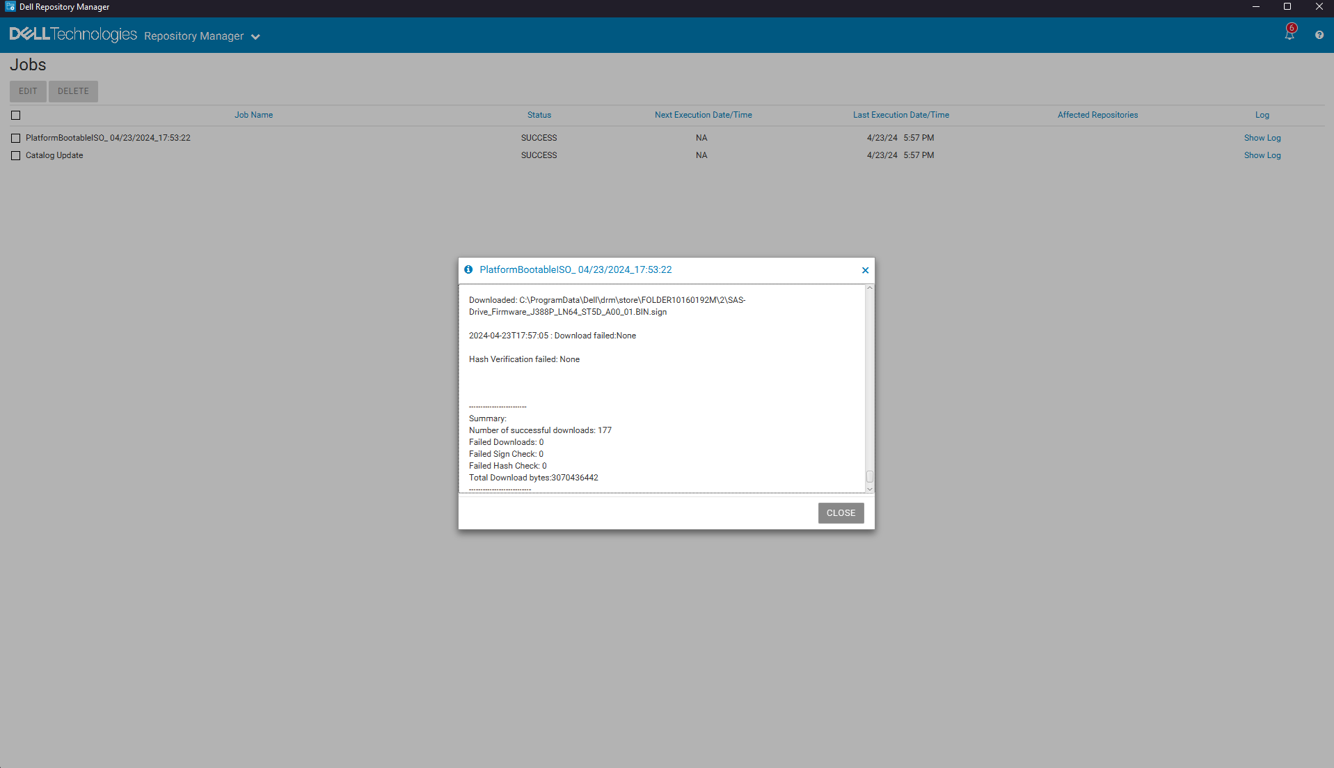

After digging from your recommendation I found that dell has a neat thing called Dell Repository Manager. It’s an installable software and you select the server model you are wanting to update. It creates a bootable iso containing all FW/BIOS updates for that machine. Of course the server being updated might not have all the different hardware included so will get skipped. Created a 3gb bootable ISO and used rufus to burn it to flashdrive. Wish I had known about this a long time ago for my older server.
For those who might also want to use it
https://www.dell.com/support/home/en-us/drivers/driversdetails?driverid=ym3xn

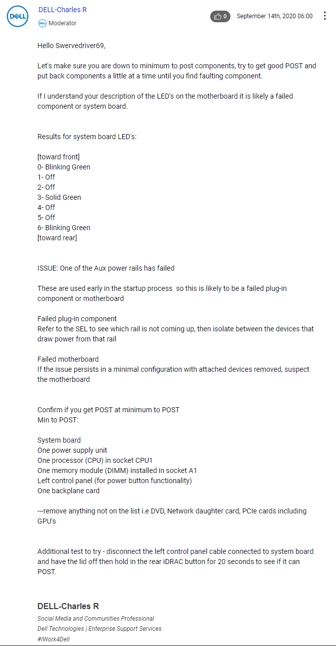

Back to the power fault lights on the MB. I removed everything riser cards, satadom, etc. So it’s the MB or 3 PSU failures. MB will be here tomorrow or Friday.
This is the only post I’ve been able to find that describes to lights I have. I’ve made sure all cables and everything are seated well. So mainboard it is.
Though I did get one error during diagnosis. Doesn’t specify anything though. Unless there is a password jumper cable… /s
