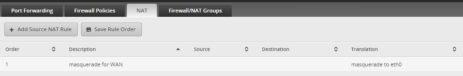

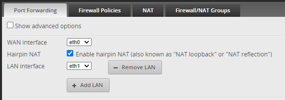

I really just need to be able to use/enable hairpin NAT between WAN/LAN and setup a masquerade for WAN to get around the double NAT issue. Pretty much my only setup needs shown.

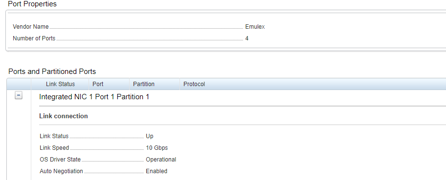

Got in those 10Gtek SFP+ DAC Twinax Cables and plugged a single cable into two ports on the sister card and seems that they are accepted. So that is good news. The cable also states it works with Mikrotik. Then since my ISP isn’t using PPPoE the CRS305 should work as a capable gbit router with its lower powered CPU + offloading.

I can then unplug the ethernet from the PCIe gbit card and everything goes through the SPF+ NIC. I did read that these will operate at ONLY 10gb nothing less. Since data won’t be going through that fast will it matter?
