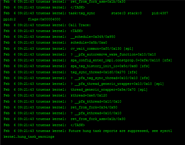

I removed the log vdev from my bool using the GUI, in hopes to use the NVME for L2ARC and use the SSD I was using for the L2ARC for the Log vdev (swap between the two). In hopes to cache metadata files for things like Plex. the removal of the L2ARC quickly removed without issue, but when I selected to remove the Log vdev the removal looked like it started going along well, 20%. However, I waited for a few hours and it had no budged from 20%. I rebooted but its still stuck at 20%. Pretty much nothing is working now, is this recoverable?
and this is the last thing the logs stated.

Removing a LOG / SLOG vDev when the pool is imported, is generally fast and harmless.
However, based on the first picture you showed, it appears to be a Special vDev which can be slow to remove as all the data has to be moved from the Special vDev device(s) to regular data devices.
If you give us the output of this command, we can confirm what is happening;
zpool status
