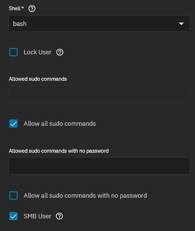

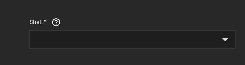

Try checking that your login user has a shell selected… even if its the “nologin” shell.

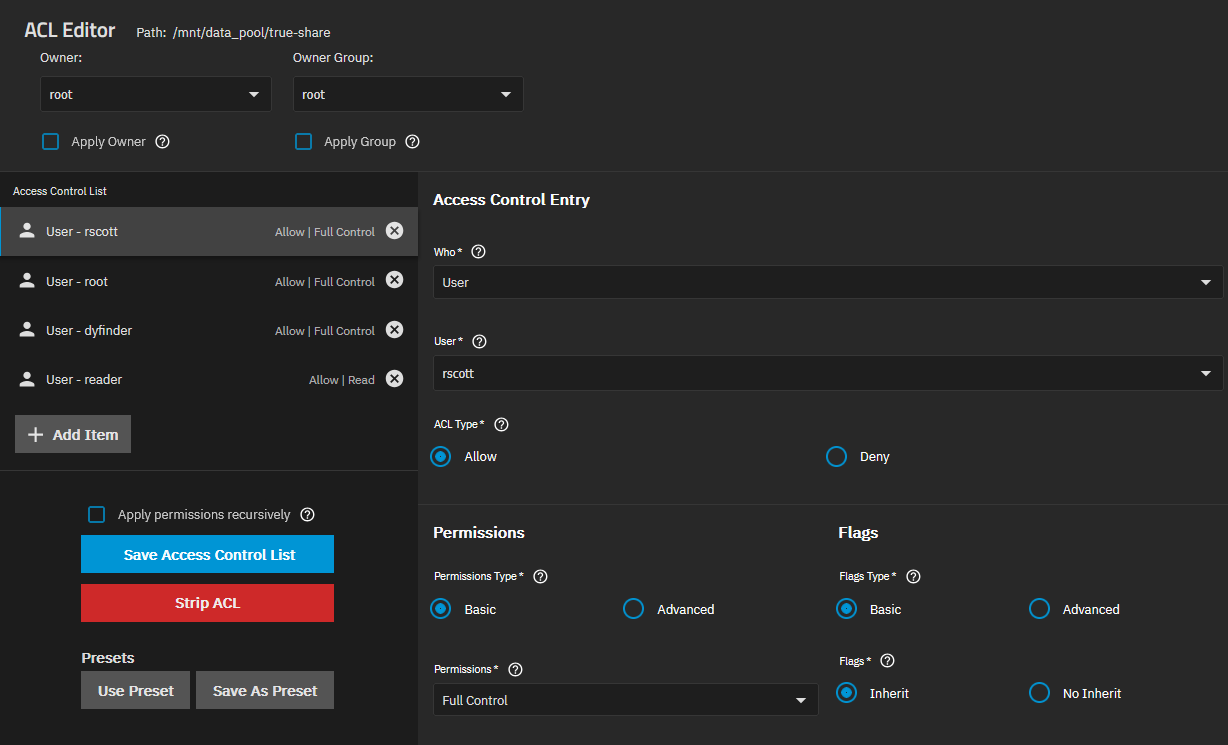

You should be able to post screenshots now. Can you share a screenshot of your dataset ACL.

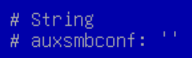

Aux Parameters:
Filesystem ACLs:

Didn’t work unfortunately…

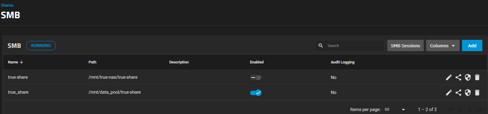

Let’s see full share config. midclt call sharing.smb.query | jq
See attached:

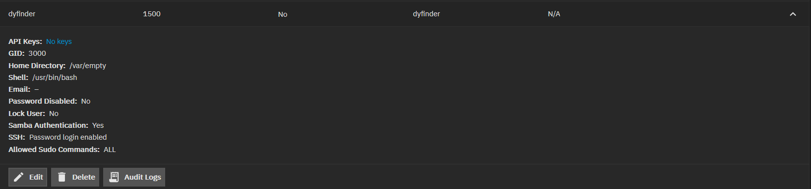

Here is more weirdness from the audit log:

For some reason, it’s acting like the user doesn’t exist…
We had one additional bug filed against RC1 where users had configured SMB accounts with empty passwords (unexpected configuration that wasn’t caught in validation) which resulted in failure to generate samba’s passdb.tdb file. Maybe run command midclt call user.query '[["smb", "=", true]]' '{"select": ["username", "unixhash"]}' | jq and review results for users whose unixhash is "*". If you have one, either turn off SMB for the account or set a valid password.
THANK YOU!!! That was the issue. I had one user that had the unixhash you described as a password. Once I deleted that user, I rebooted the machine (as it still wasn’t working). Once it rebooted, I checked and I can now access my share.
