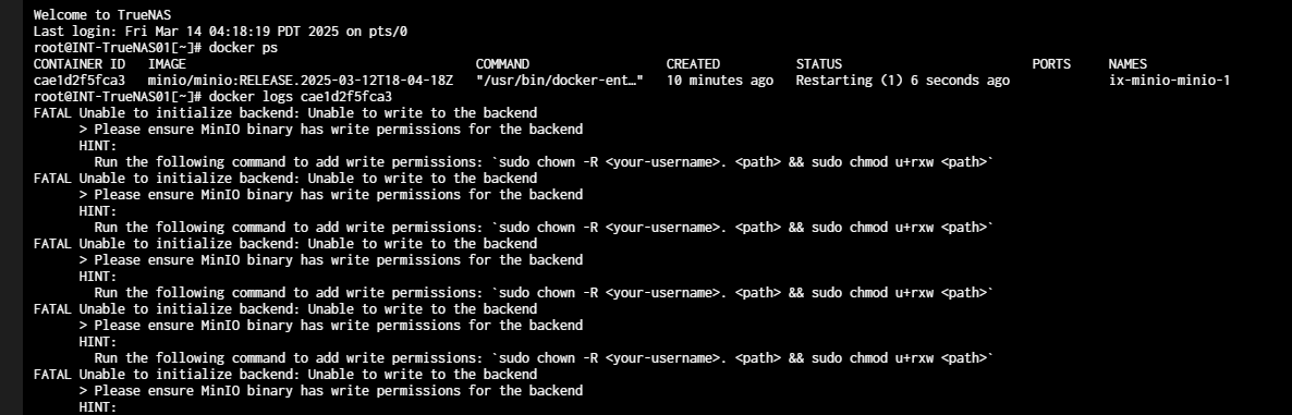

I am unable to use Minio on docker.
Unable to write to the backend, I have given the required permissions for this.

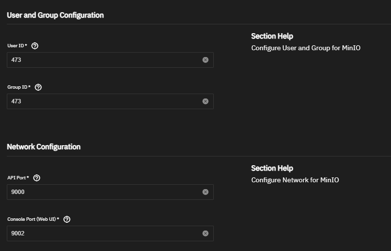

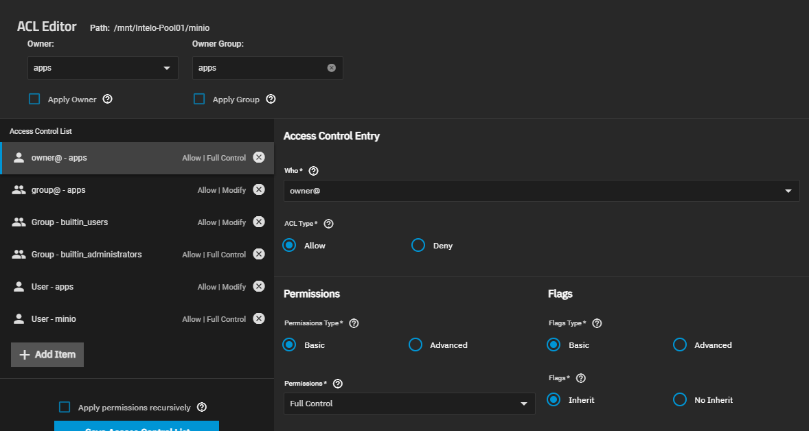

Docker log says unable to write to the backend, Enabled ACL on dataset 473 has full control, with the force option.

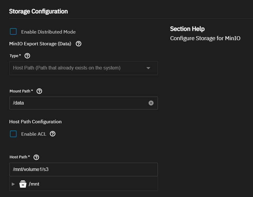

I use /mnt/volume1/s3 mounted into /data

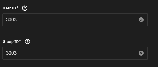

MinIO runs as 3003:3003 - this user needs to have Modify access to /mnt/volume1/s3

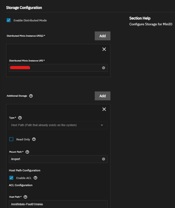

why are you mounting it as /export ?
there is thousands of guides how to setup MinIO in docker-compose this is not truenas specific at all

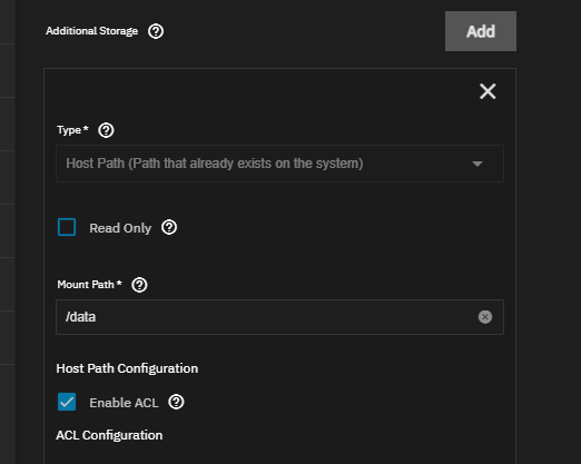

I changed it to /data, still same issue
can you unclick ACL in MinIO / Host Path Configuration ?
I will give that a try.
