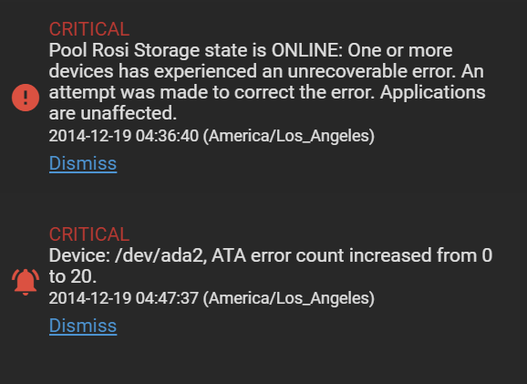

A knowledgeable friend help me set up a TrueNAS installation several months ago. I put 2x18TB hard drives in and set it up with SMB to share with my PCs. It’s been running like a dream until I happened to notice that I had two error messages.
Screenshot 2024-07-08 202220

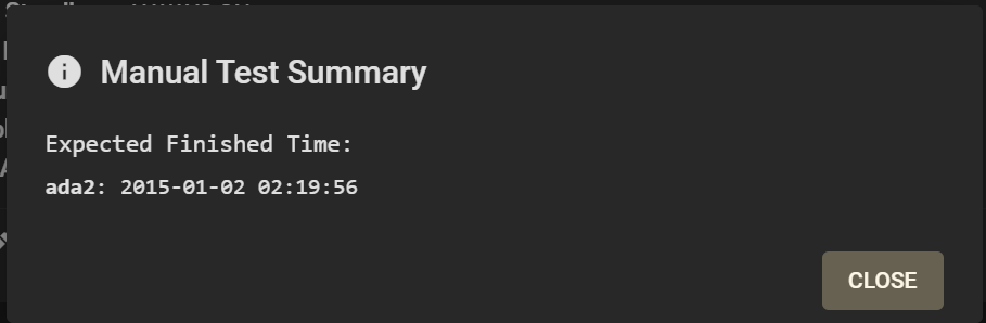

I looked in the Pool at the drives and ran two Short S.M.A.R.T. tests on both drives and they both came back as passing. What was weird was that when I ran the tests, I got this following message, which is a clue that something us up.

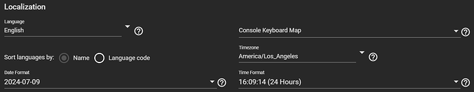

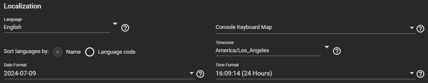

I didn’t think about the time stamp at all until I looked at a file that I had just worked with and it showed the same 2015-01-02 date stamp. And when I went back to the original ada2 error message, it struck me that the date was a 2014 date… huh? Files stored on the hard drives are also showing 2015 dates on them. I looked at the system date and time and it has today’s date and time on it.

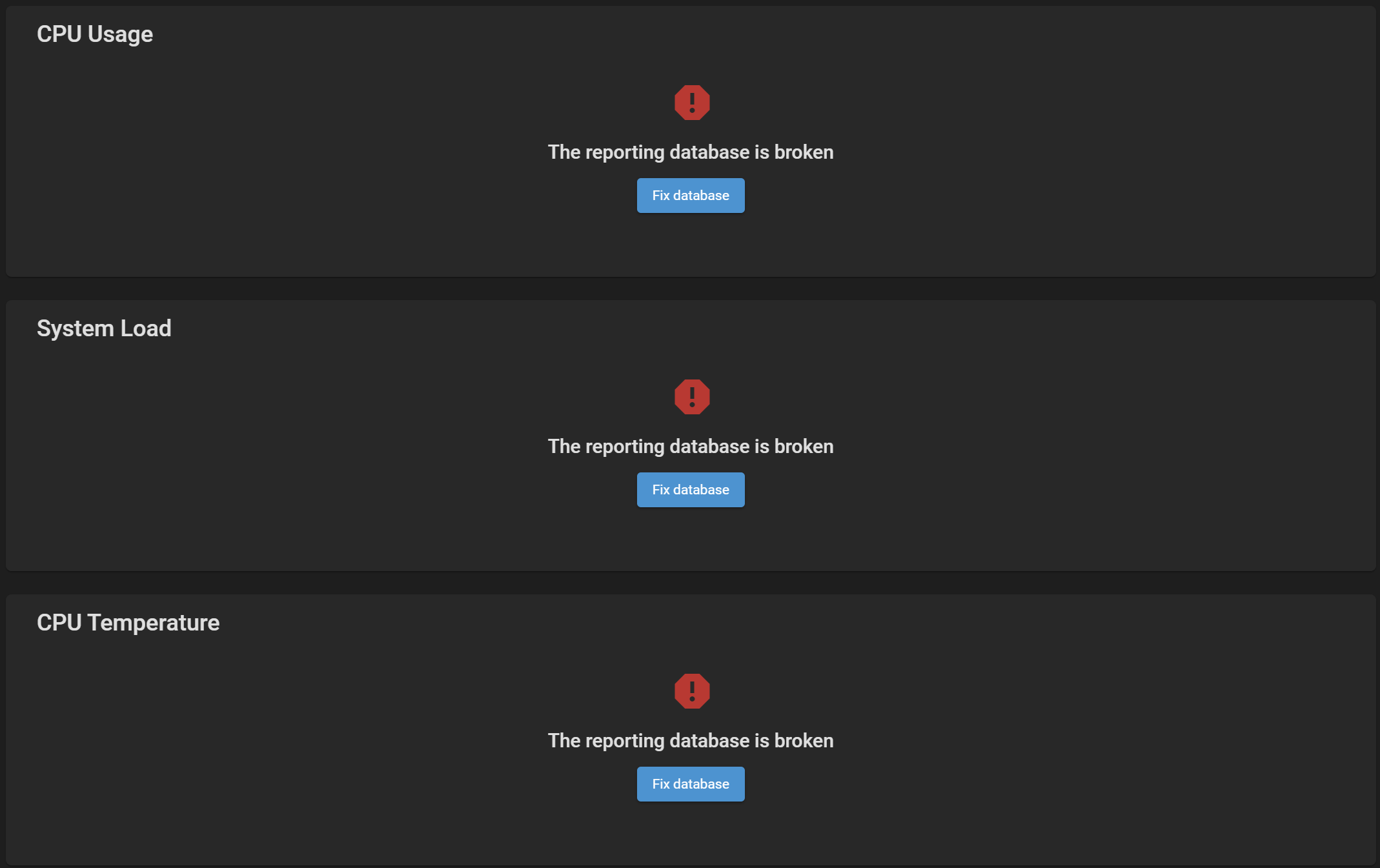

So, I started a LONG S.M.A.R.T. drive test on both drives before I turned in last night and when I logged on this afternoon (16 hours later) the system showed that both tests on the two drives were both still running. Is that normal? That seemed excessive, so I thought that maybe the NAS just needed a good old-fashioned reboot. When it came back up and I tried to run the SHORT SMART tests, they both passed but still had the odd 2015 date that looked like the screen shot I shared above. I looked in other tabs in the NAS and it also looks like the reporting databases are corrupted:

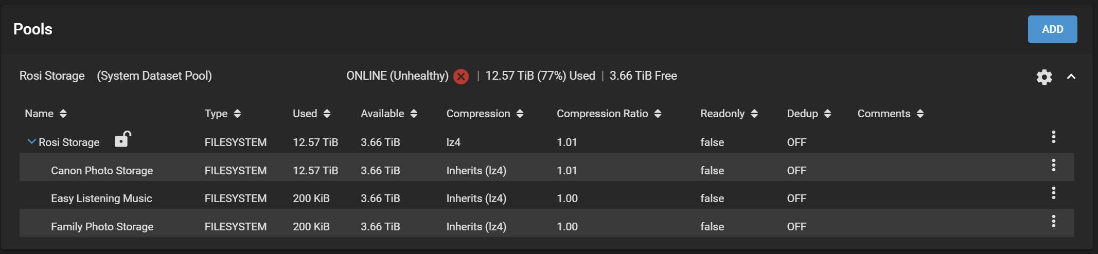

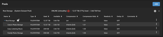

Finally, when I looked at the pools tab, the pool is on line, but shows unhealthy:
So I appear to be in trouble, but do not know exactly what is wrong, or more importantly, what I need to do next. I am running Version TrueNAS-13.0-U6.1. I know some Linux/Unix basics (like enough to run some commands in a shell), but would appreciate someone being able to walk me though the steps I need to determine what is wrong and fix it.

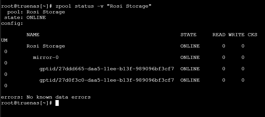

To rule out the GUI, in the command-line (via SSH):
zpool status -v "Rosi Storage"

Winnie Linnie - I got the following response when I ran the zpool command in the NAS Shell (I do not think that is what you meant by SSH, but that’s how I knew to check it):

The pool looks fine.
This is starting to look like a GUI / middleware bug.

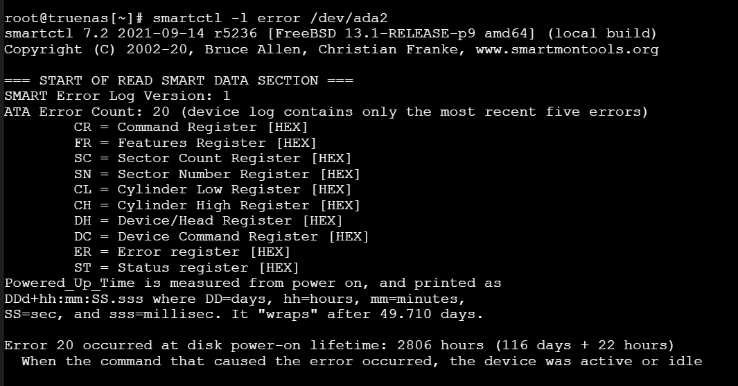

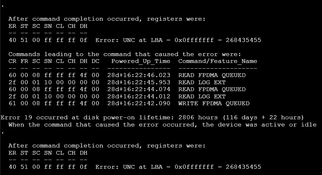

Do you see any errors logged in the drives’ SMART data?
smartctl -l error /dev/adaX
Replace “X” with 1, 2, and 3.

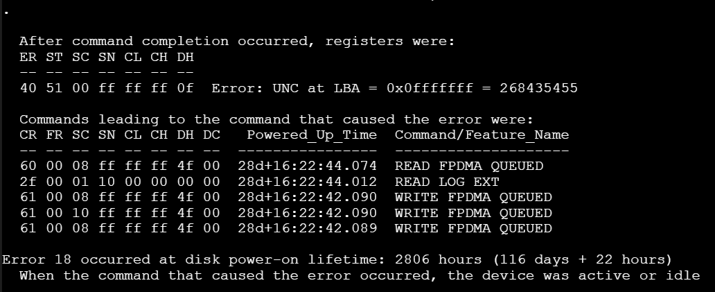

First off, thanks for the follow up. I ran the commands on all thre dries. ada0 and ada1 have no, but ada2 has a log full of 20 errors. Here is the top of the report:
I did some additional digging and I think this might be useful. Something about the data issue was bugging me, so I went into the BIOS and looked as the clock. It was set to 2014 - which makes me think that the computers clock (is that a CMOS clock?) may have reset. The computer that is housing the TrueNAS is a 2015 machine. I am wondering if I have a bad CMOS battery - or one that needs replacing. Could a CMOS clock cause errors like this?

:warning: You need to replace ada2 ASAP.

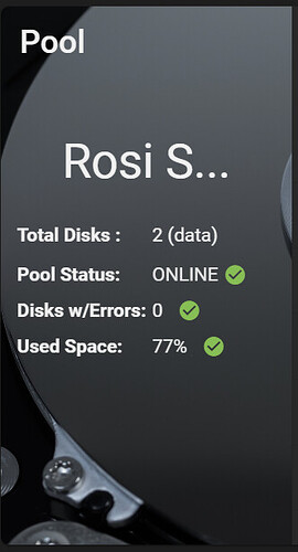

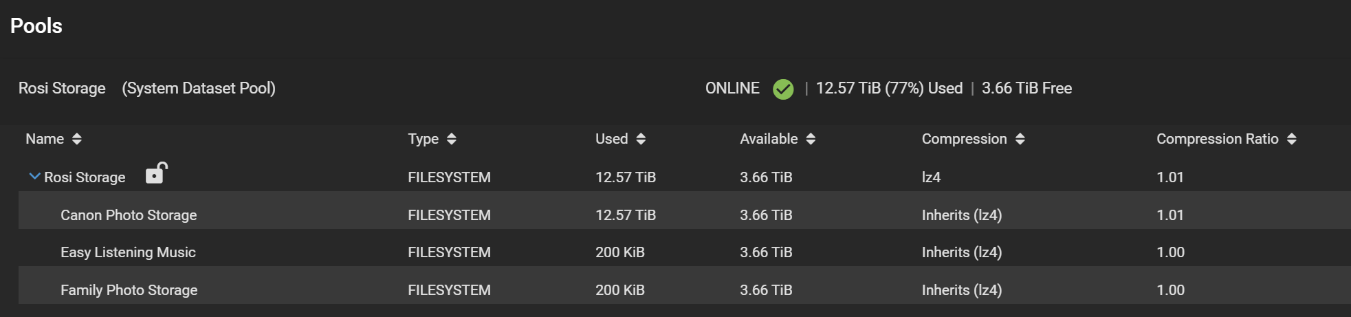

Another data point. After I went into the BIOS and reset the CMOS clock, TrueNAS is no longer reporting any warnings about the pool:
Red
A hard drive with 20 uncorrectable errors needs to be replaced as soon as possible. Even if the GUI reports no issues after a reboot.
At minimum, run a “Long” selftest on ada2.
I appreciate the advice. I am not opposed to buying a new drive - I just did not know if the CMOS clock might be an issue. I did start a long SELFTEST on ada2 last night and will post when I have it back.
