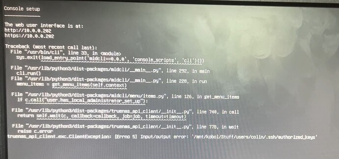

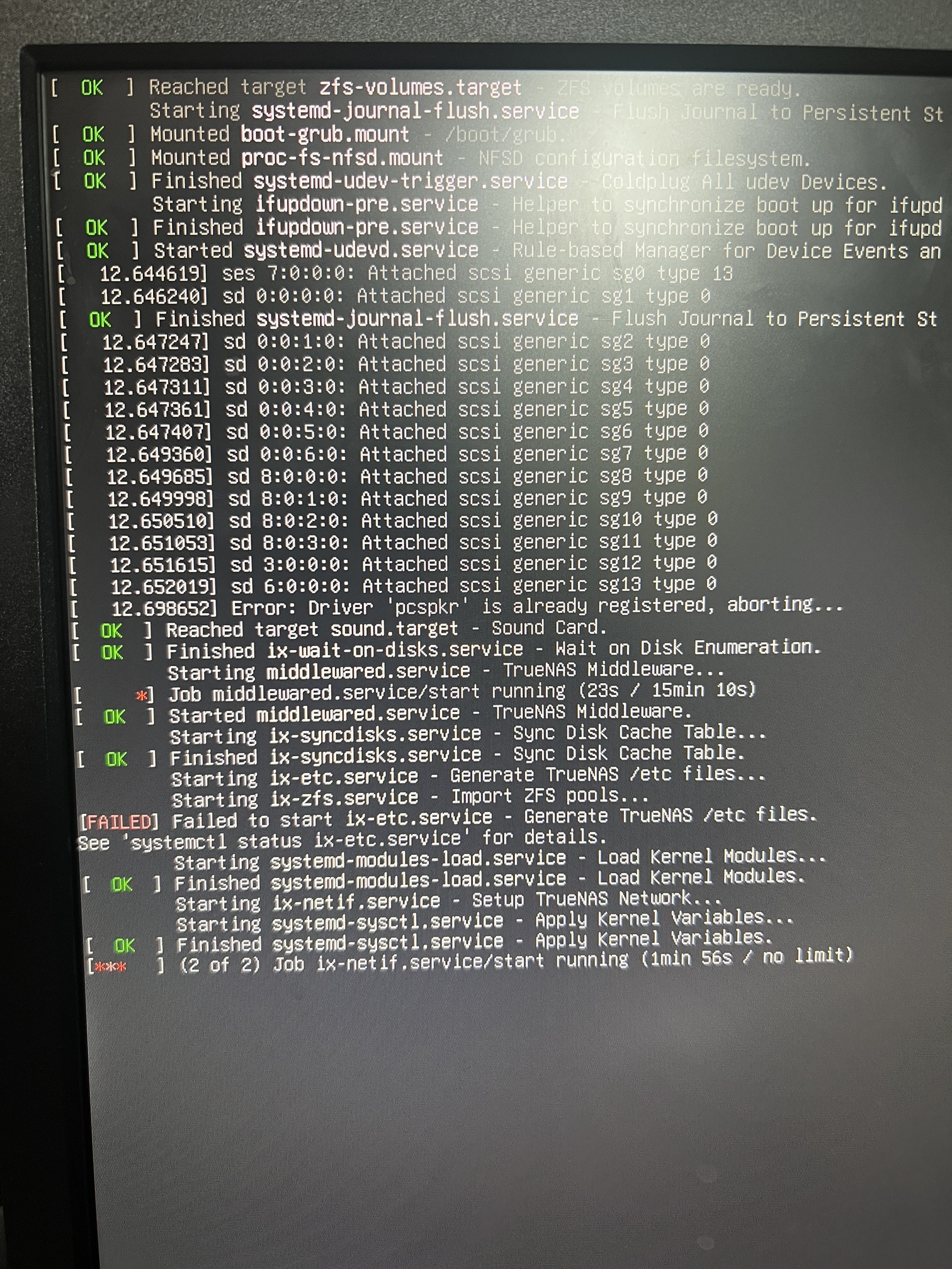

Long story short, my server seems to boot up, with errors, but i can’t log in or use the console.
This is my console screen, over and over, all it does:
[video]: Imgur: The magic of the Internet
[screenshot]:

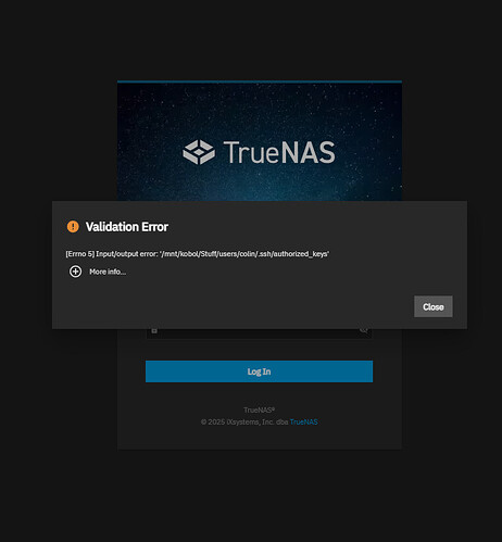

… And I get this when i try to log in on browser:

OSError: [Errno 5] Input/output error: '/mnt/kobol/Stuff/users/colin/.ssh/authorized_keys'
IO/ Errors from your data pool aren’t a good sign. Do you have SSH access to it?
Nope. like a total noob dope, my private key is stored on a pool on the NAS. Lesson learned.
Well, can you provide more information about the pool characteristics / hardware? Getting IO errors from the pools is a sign that something is seriously amiss (this is an unusual situation – you shouldn’t be getting IO errors for filesystem IO).
i wonder if my SAS cards are poorly seated or something, or possible the SAS-to-SATA breakouts are poorly seated on the cards…
[edited for clarity]:
Sure! System specs in signature, and this linked post from earlier this week contains my zpool list and status, and a table of how my drives are installed/connected:
Having I/O errors for filesystem paths is not a UI error. If I were to hazard a guess, it’s hardware-related, but people in the forums will need more information about your actual hardware.
the HW info was why i linked the post, i edited it for better clarity of my intent - zpool list, zpool status, and a table of all my drives and how they are connected - plus my signature has the rest of my system config in it… if anything is missing, please let me know, i do aim to be thorough.
If for some reason you can’t ctrl+c out of the CLI prompt in console, you can switch virtual terminals (ctrl + alt + F2) for instance and try some credentials.
OK thank you - I shut down and checked that all my SAS cards and cables were seated properly. I found one drive with a bad connector on it, it is probably hanging by a thread and maybe was causing the IO issues? Either way my system has booted up now.
