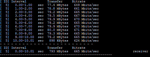

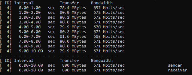

Thanks for the instructions.
Here are the results:
Screenshot 2024-09-28 200721
Screenshot 2024-09-28 201837
Sorry for the confusion, I wrote 1000Mbps but meant 1Gbit/s or 1000Mbit/s. Either way its still some performance I’m missing out, to be exact 55MB/s (1000Mbits/s equals 125MB/s).

So the iperf results show that your perf issue is due to your networking, not the SMB/storage layers.
So that helps refine where you need to look for a solution.
