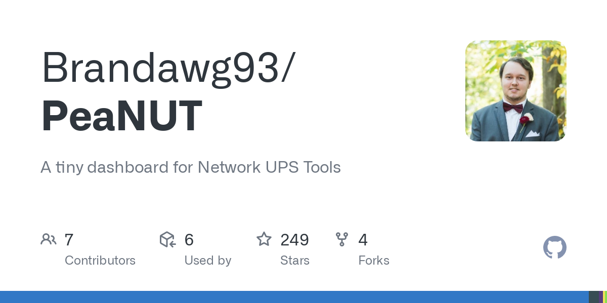

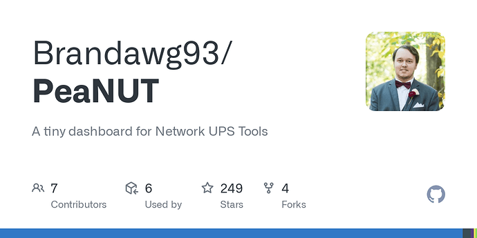

…or maybe just set up a LXC on Proxmox with PeaNUT:
Pass through USB to the container and it should be do the trick. Lots of ways to skin this proverbial cat.
