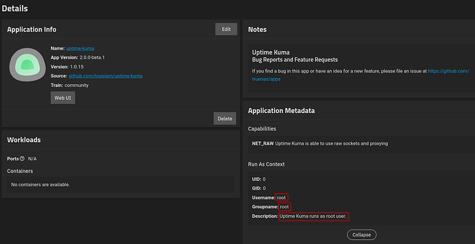

Can you post what your configuration of the actual app looks like? I just tried installing using an iXvolume, not logged in a root, and it came up no problem, which makes me suspect a configuration error.
The permission denied error is for accessing the docker logs. You just need to use sudo before that docker command.
And that Runs As Context widget refers to the container run as user, so which account you use to access the UI is not relevant.
