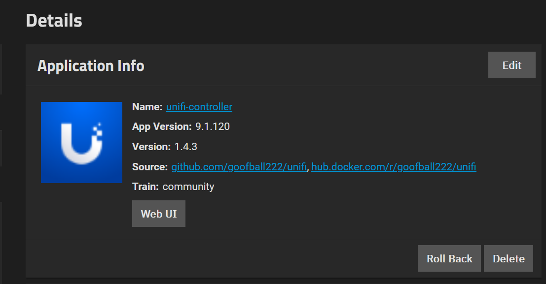

I’ve had it working for last couple of years - is there some known issue? Because seems fine :open_mouth:
Thanks for this. I haven’t been able to get it working and was discouraged by other reports I had seen.
Are you using the app found on Github that’s linked from the GUI?
Just straight up the one from Community catalogue on the GUI - I remember there was a minor hurdle on adopting the devices, but it just required assigning them static ip on the router, SSH’ing into them & tweaking… something (I can’t remember the something - it was just a line or two of cli that I had previously found on unifi forums)
Hopefully that is of use
Thanks, it’s of use!
I had “just moved on to other life demands” - I’ll put this one back on the list of soon to-do’s.
If you should recall the “something”, please post a clue…
I checked my emails because I remember reaching out to unifi before I figured it out; I then let them know they can close the ticket because I fixed it with set-informed - I’m guessing that is the command that lets the devices know the controller IP/Port… sounds right per quick google search.
