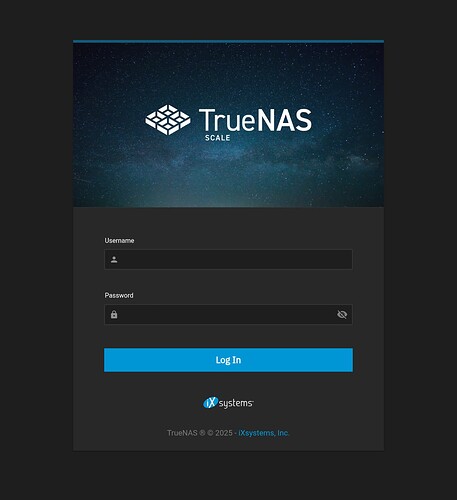

User field in login page not recognized by password managers
When I try to log into the TrueNAS (Scale 24.10) interface, password managers are not recognizing the user field. Password fields are recognized, though.
Has anyone also run into this issue?

For me, it’s not working in Firefox. I have noticed, that the user field is marked as text (type="text").
Maybe changing it to type="email" will fix it?

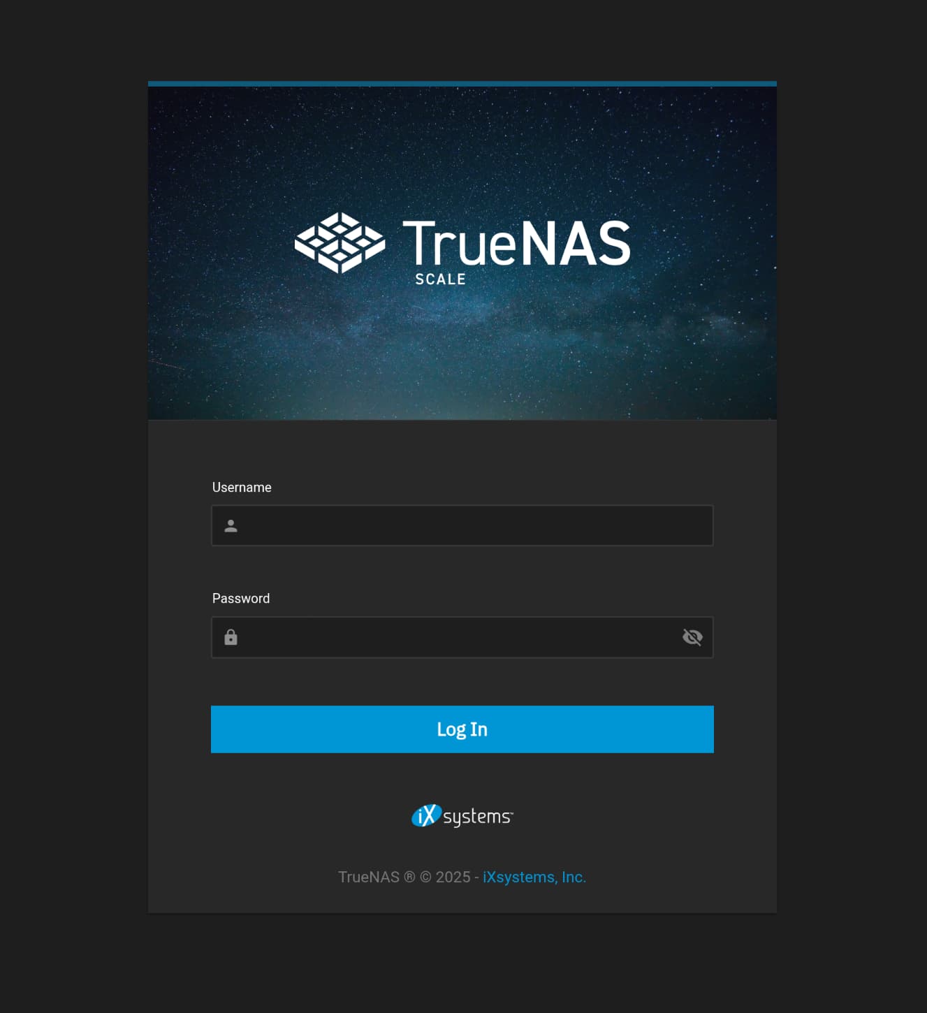

I am also having an issue with this, My password manager (Dashlane) isn’t autofilling the username or password fields. I am running all the latest versions of Dashlane and Chrome.
Not sure if their is anything I can do to fix on my end, had a google search and it maybe related to how the site is coded or maybe the loading times. I’m not sure, not something I know anything about.

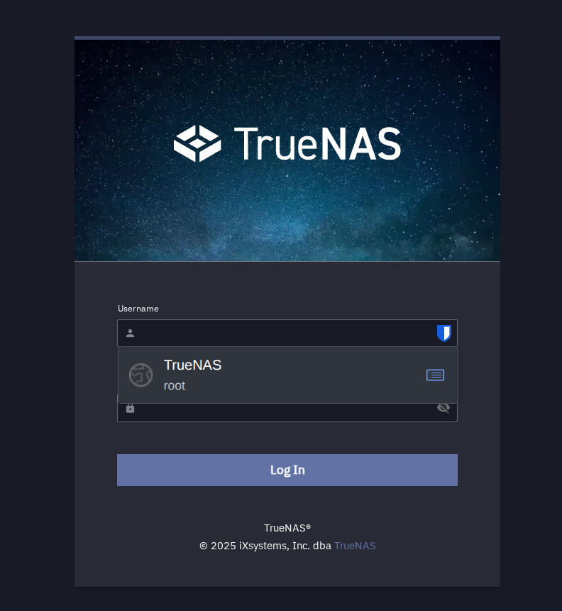

Just added to bitwarden and it seems to work fine:
Would be good to know which password manager is having issues (I see dashlane mentioned, which I’ll test now).
The fields already use the "username " and “current-password” autocomplete input attribute:
autocomplete="username"
autocomplete="current-password"
Which should be more than enough for a password manager.
Edit: Just tested with Dashlane on Brave and it autofilled no problem.

OK the username gets grayed out until I click the password then back to the username field. Only then I can use the password manager to fill in the credentials but Only in the password field.
I guess this is somewhat intermittent.
