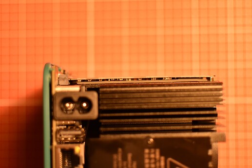

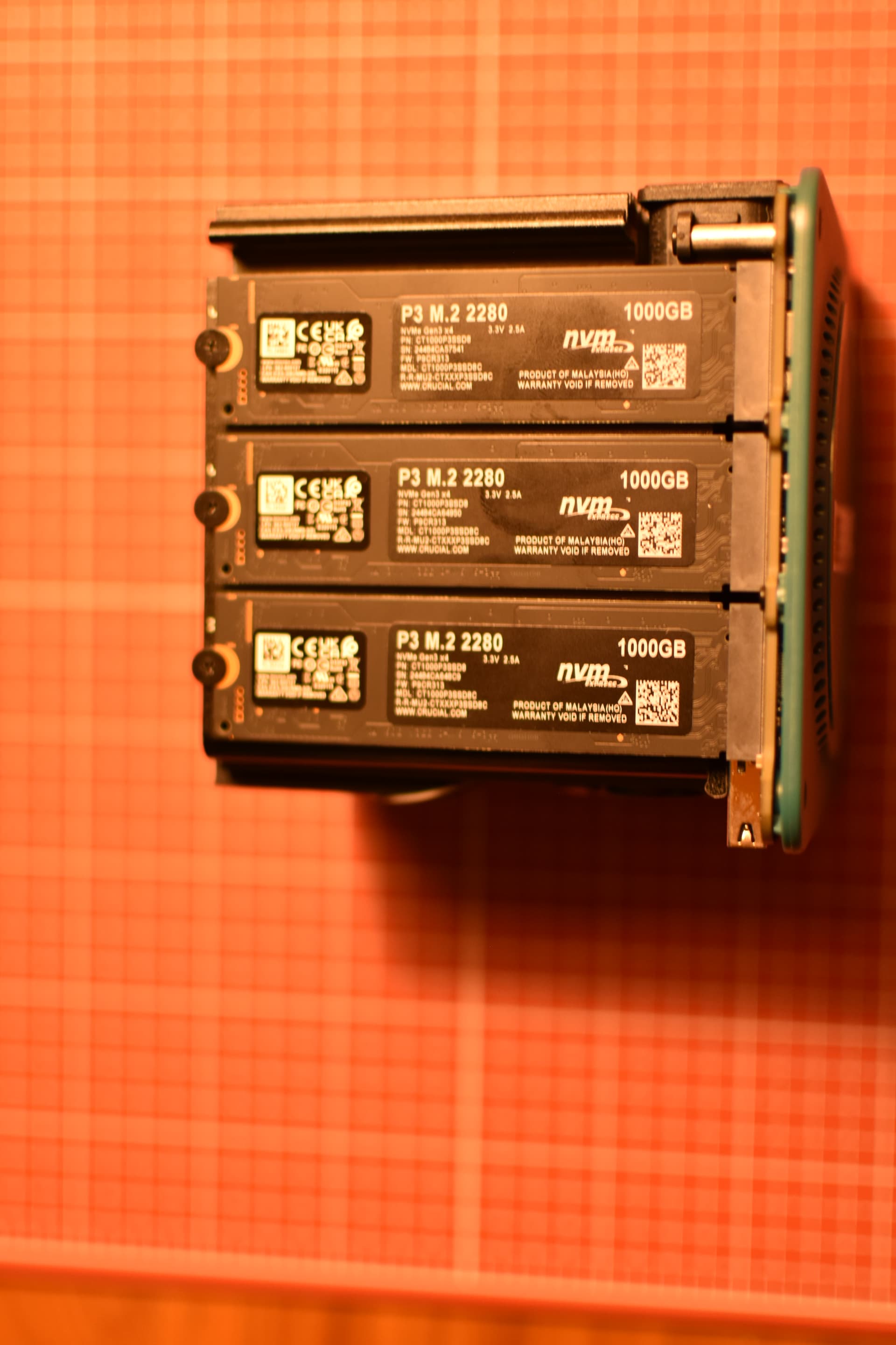

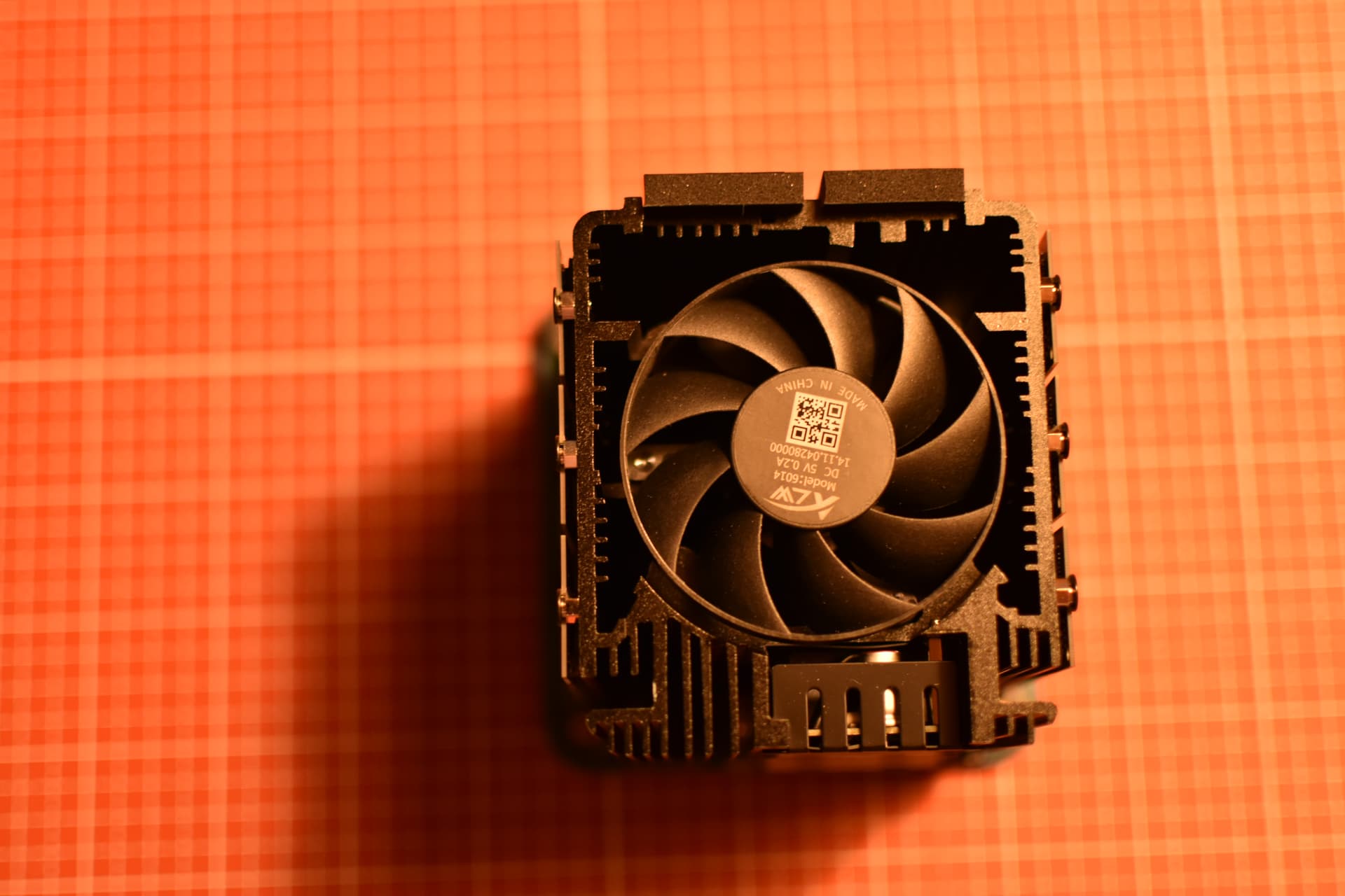

Looking closely at the hardware the really clever design - you have to give them that - mounts the components to be cooled on the outside with a giant cooler and a ventilator in the centre. Similar to Apple’s infamous “trash can”, I guess, at a fraction of the price.
This shows how the SSDs are mounted on two of the four sides:

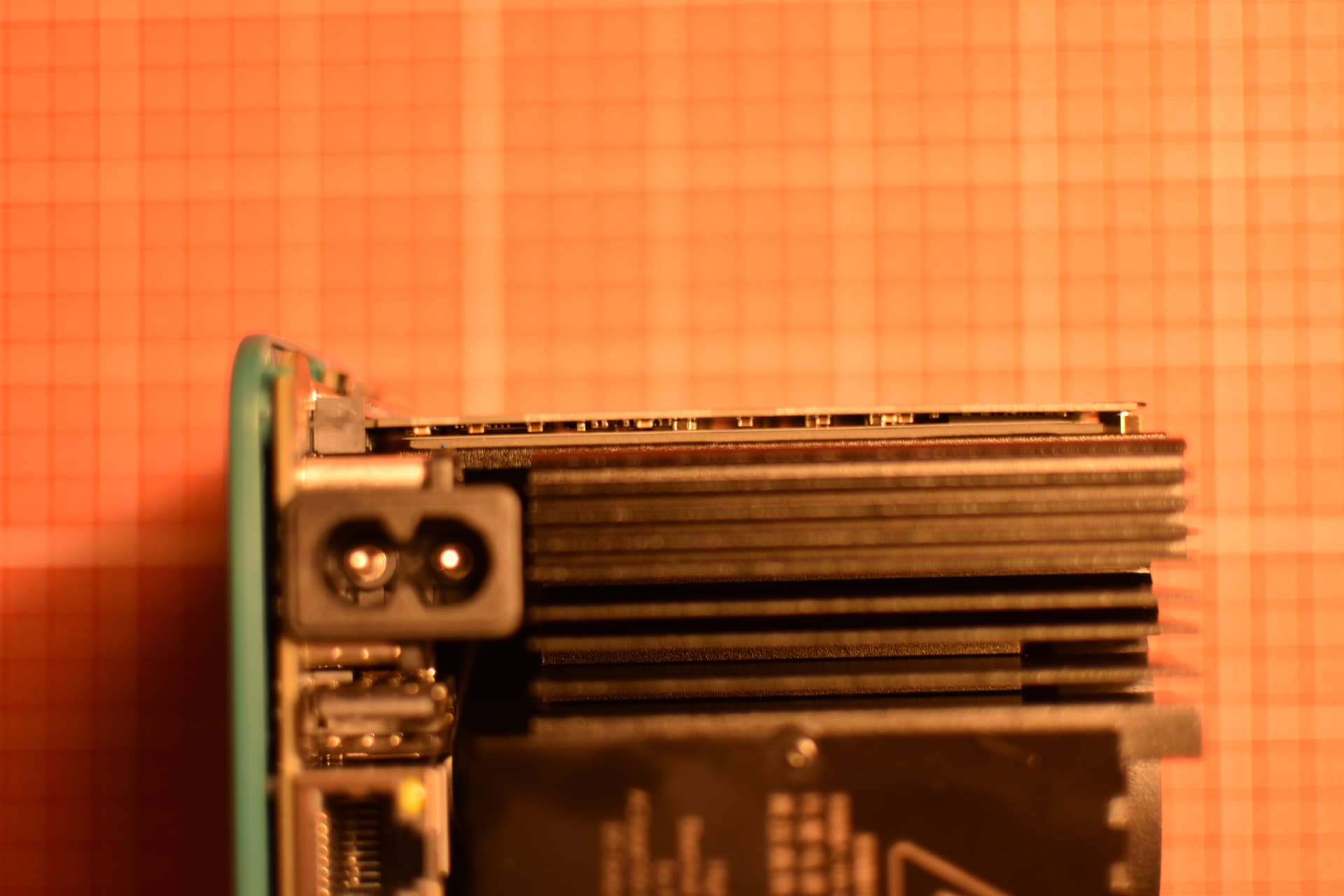

But if you tilt the assembly another 90 degrees and look closely - the SSDs are supposed to be thermally connected to that cooler via thermal pads, but:
After tightening the screws they clearly bend a little bit outwards - I tried multiple refittings pushing them down in the middle to no avail.
And, even if they were perfectly flat they would still not have good contact to that thermal pad.
So that might be one reason for SSDs overheating and failing.

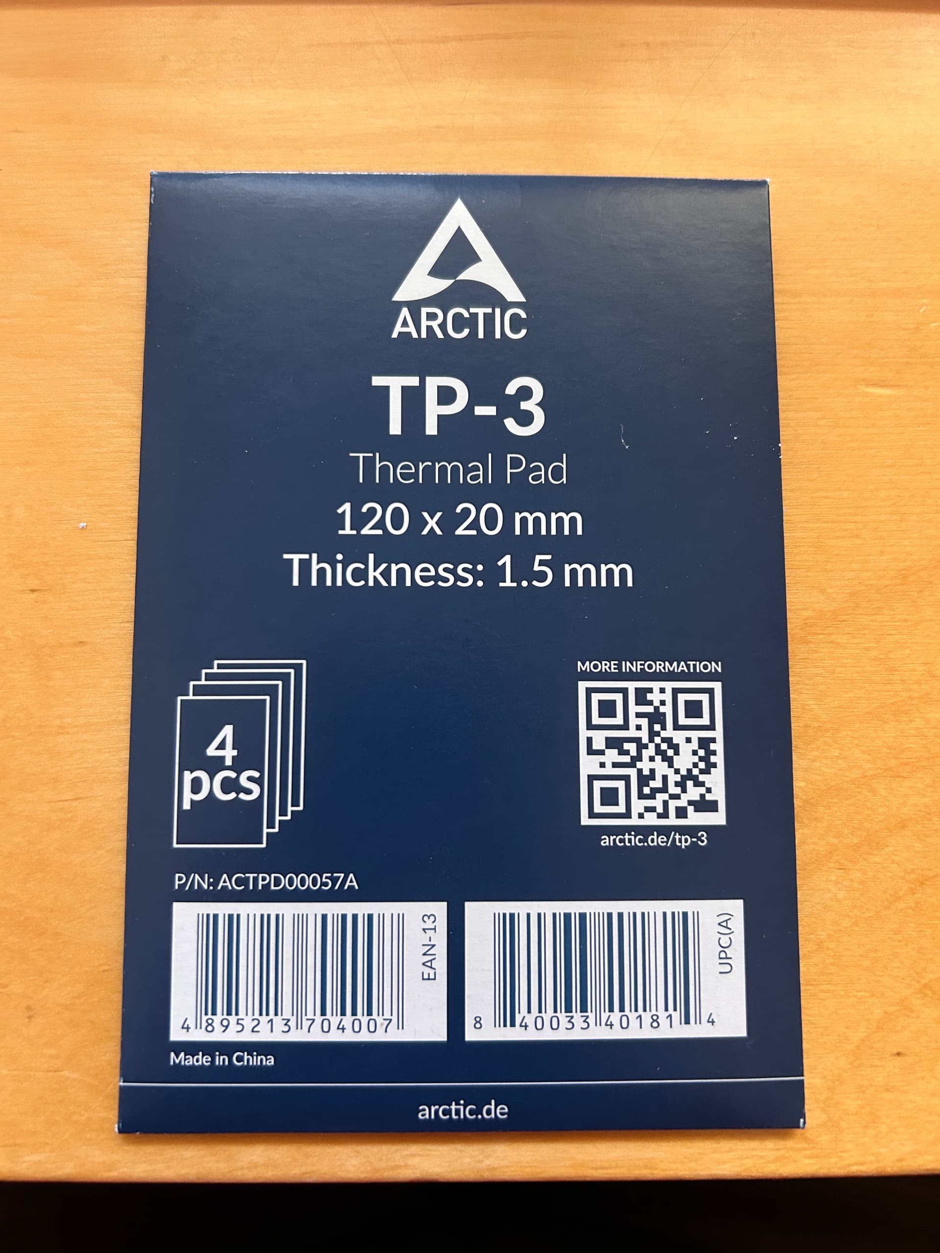

I ordered these and they are really soft and mold well to components of various height. They are not elastic, though, won’t bounce back into their old thickness once used. Like play-dough.
That pack of four is enough - you can cut them to length and then use two pieces of the leftovers each for the last two SSDs.

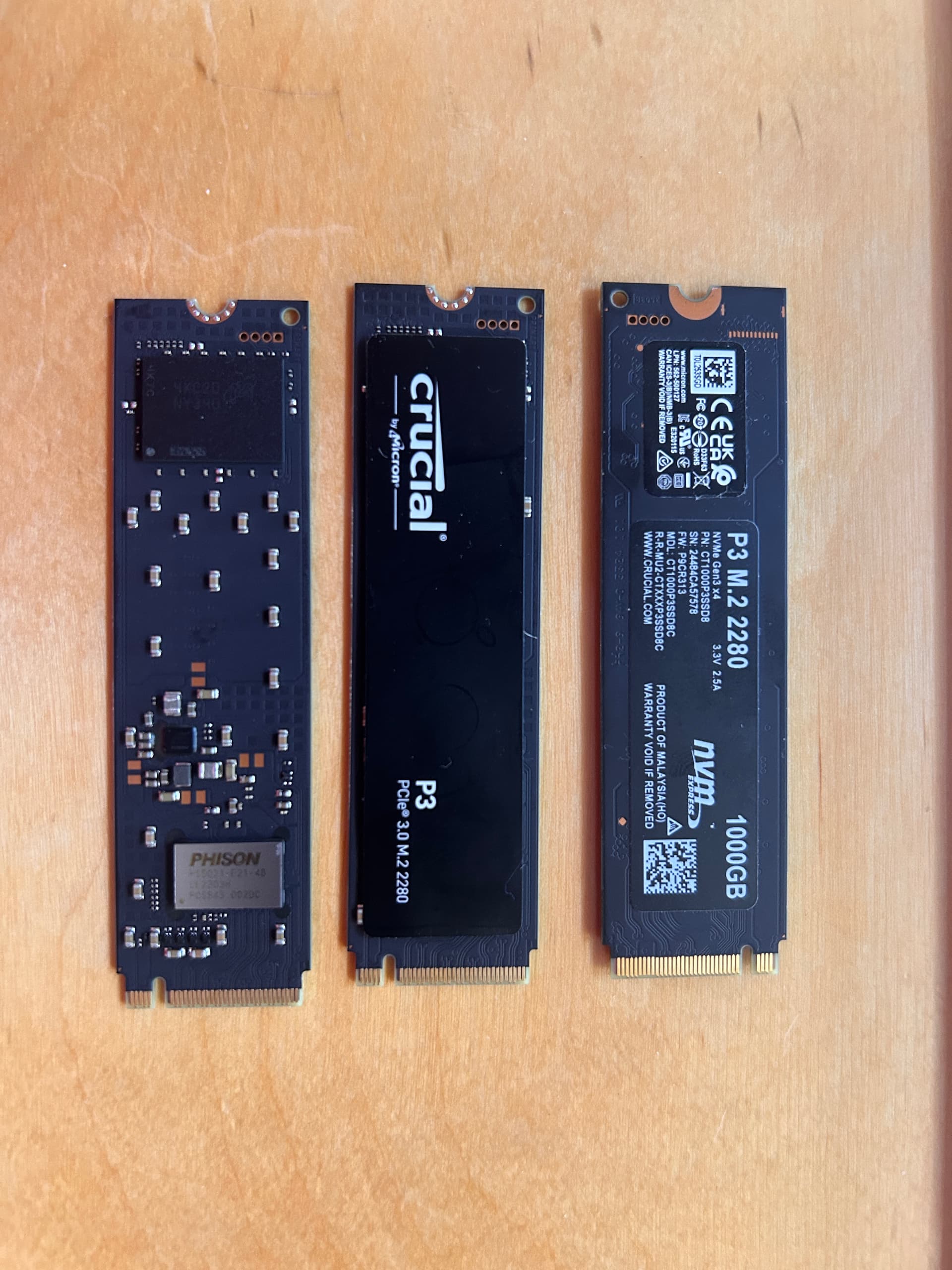

I also removed the paper sticker Crucial put on top of the components.
Right shows PCB side - outside when mounted. Center is component side with sticker, left is component side without sticker.
I have now run 10 concurrent dd jobs with compression disabled - CPU maxed out - and the temperature does not go above 46 Celsius compared to 55 before. Idle temperature is below 30 Celsius now and was 46.
Quite an improvement for 10€ :wink:
