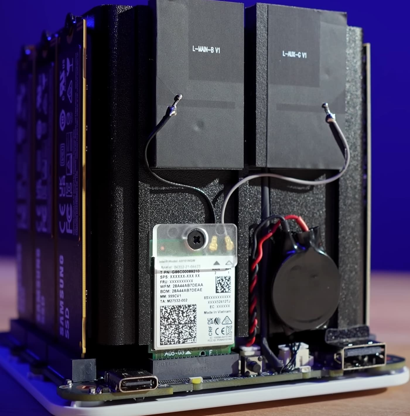

Looks like the Wifi card is an AX101NGW in M.2 2230 form factor, rather than mPCIE. The card uses a CNVio2 interface..
Do we know if that M.2 slot has PCIE lanes?
If the PCIE lanes are present, we can use an A+E-key → M-key adapter, or get a native A+E-key SSD like the Cervoz T425 or Advantech SQF-C3A 720.
Easy enough to find out if there is a usable PCI lane as the M2 A+E to M adapter was only $7 … I know most desktops have usable PCI lanes but a lot of laptops with CNV interfaces do not. I also noted that there is absolutely no room behind the existing wifi/bt card. I guess when the adapter shows up I will find out one way or there other.
– Update
Used an A+E to M Adapter and a WD_Black 2230 sn770m 1TB NVMe but no luck, BIOS did not show/recognize it. As it only cost me $7 it was worth the try.

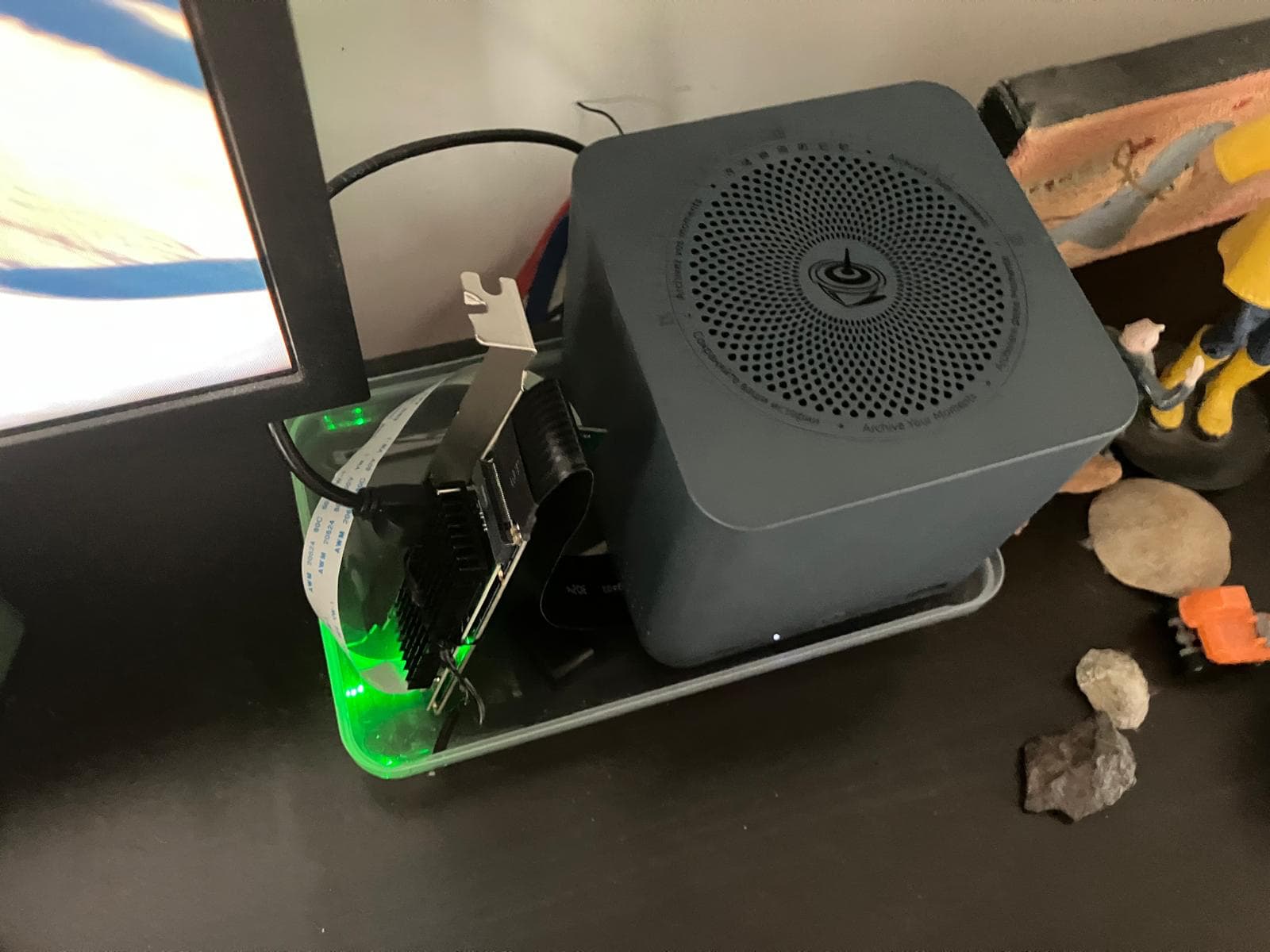

Here are some pics and temp readings posted in another Beelink thread

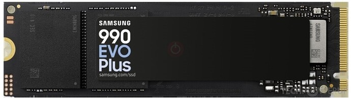

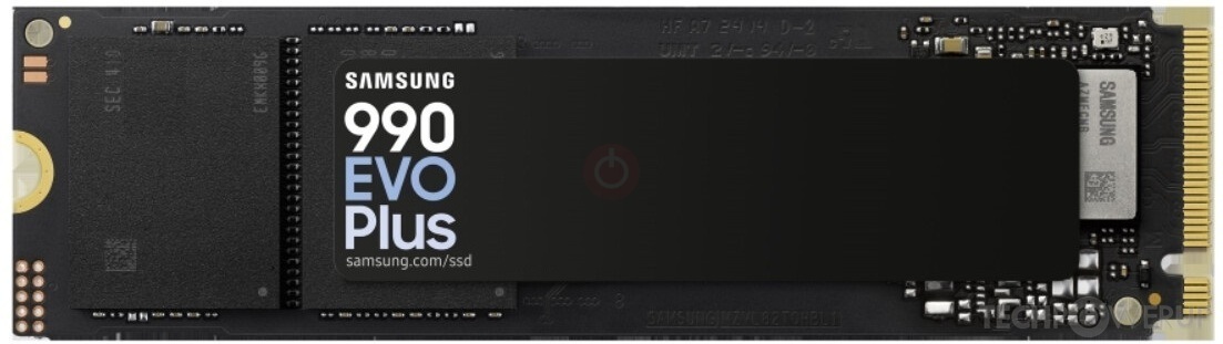

According to this test:
the Samsungs draw 4.6 W maximum. So you are well inside the specs of the server.

I’ll also recommend the WD SN7100. They’re single sided so work well with the heatsink and are some of the most power efficient drives out there currently. Slightly below the Crucial P3 Plus in power consumption but TLC and with a very high TBW. Max power draw for a 2TB one is 4.6W in SMART and significantly less in reality. It’s a very new generation of controller and NAND so you benefit from that.
