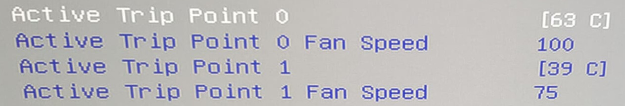

Try setting the fan mode in the bios to “Full On” so it runs 100% all the time. Then see if it remains stable with the lid on. Might just need to tune the fan settings later if that’s the case.
I tried adjusting the fan speed trigger point per @adaciuk’s comment, prior to putting the case back on. I’ve also adjust down the PL1 and PL2 to 10W.
