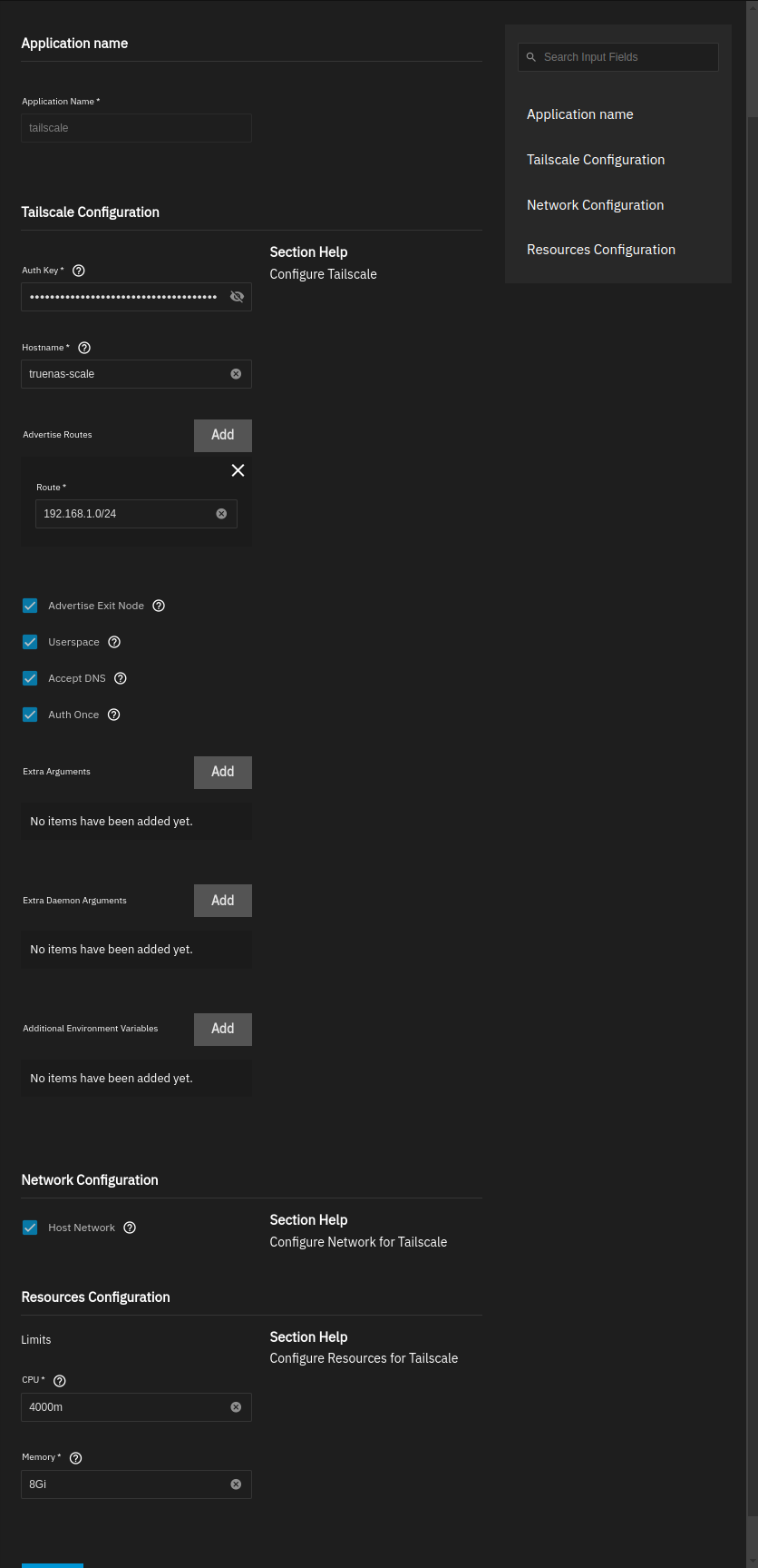

You can set Advertise Routes under the App-Edit-Page.
Here you have a section Advertise Routes under Tailscale Configuration.
I added here my home network 192.168.15.0/24 and my pbx-telefon-system from my office network with 192.168.222.77/32.

These are all of my app settings on Dragonfish-24.04.2.5. All I did was look at the IP range of my network (192.168.1.0/24) and type it in. If I had an isolated network e.g. wifi at 192.168.2.0 or something I would put that in instead. If I wanted both, I am not sure what I would type.
It means I can connect from outside my LAN (e.g. 4G phone) and listen for example to my own music collection stored in a share on my TN box.
You just Add another Advertise Routes entrie and put in the other route.

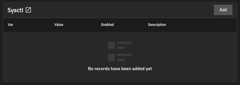

As far as any other settings are concerned, I didn’t do anything else. My sysctl looks like this:
I added the following:

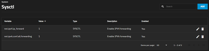

Well it works withadding those 2 lines to the sysctl
FYI I´m about 99% sure since truenas has following filepath /etc/sysctl.d/
That you could initialize this with a post install script or commands as per tailscale instructions. But it´s not needed since this just works, at least for me.
