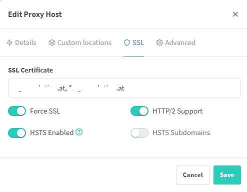

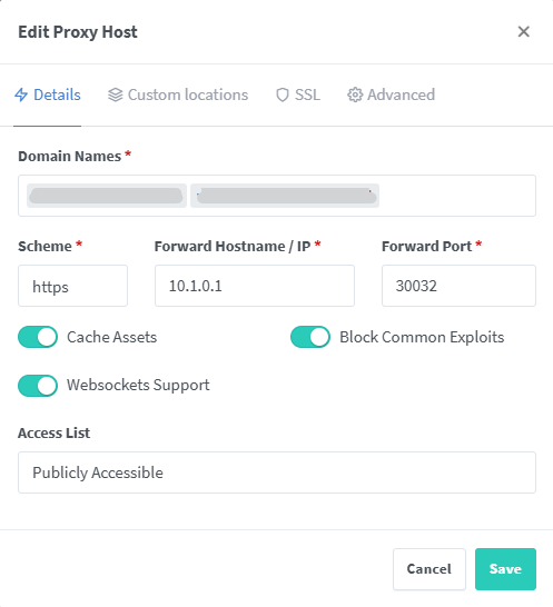

NPM settings.

Have you already tried to change schema on NPM from https to http?
Yup tried both and it didn’t change.
