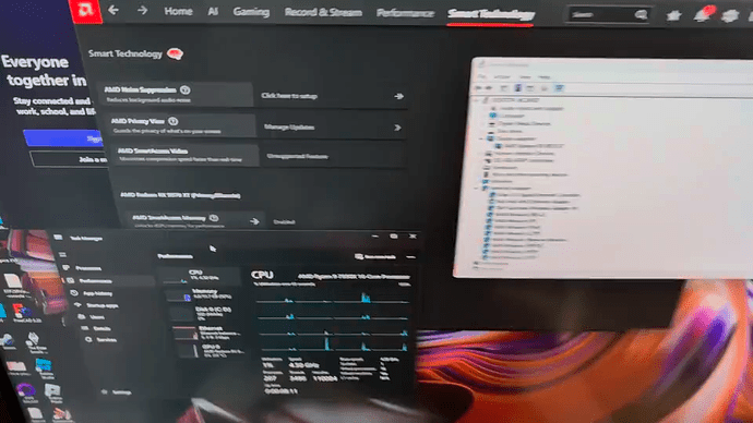

I’m trying to GPU passthrough the new 9070 XT, but an not having any luck. From what I’m seeing someone else was successful with getting passthrough to work on the latest and greatest firmware, kernel, and drivers:
Seeing as 25.04 is coming out supporting kernel 6.12, which should be the minimum kernel supported by the 9070 XT, I wanted to bring up this issue in hopes the new stable release will have current enough drivers and firmware to be able to actually use the 9070 XT.
If not, would I be able to update the relevant firmware manually myself? I could use some guidance on that.
