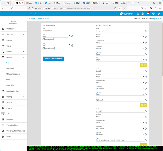

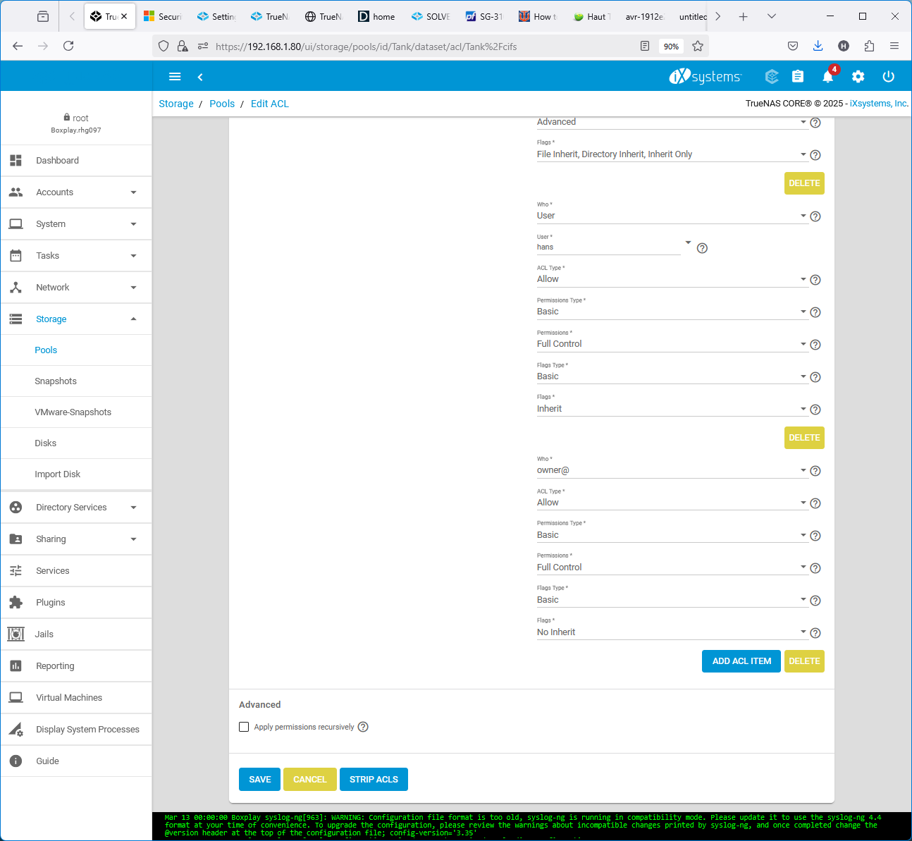

Can you share screenshots of your dataset ACL and did you make any changes to the default share ACL?
No changes to the default share ACL.

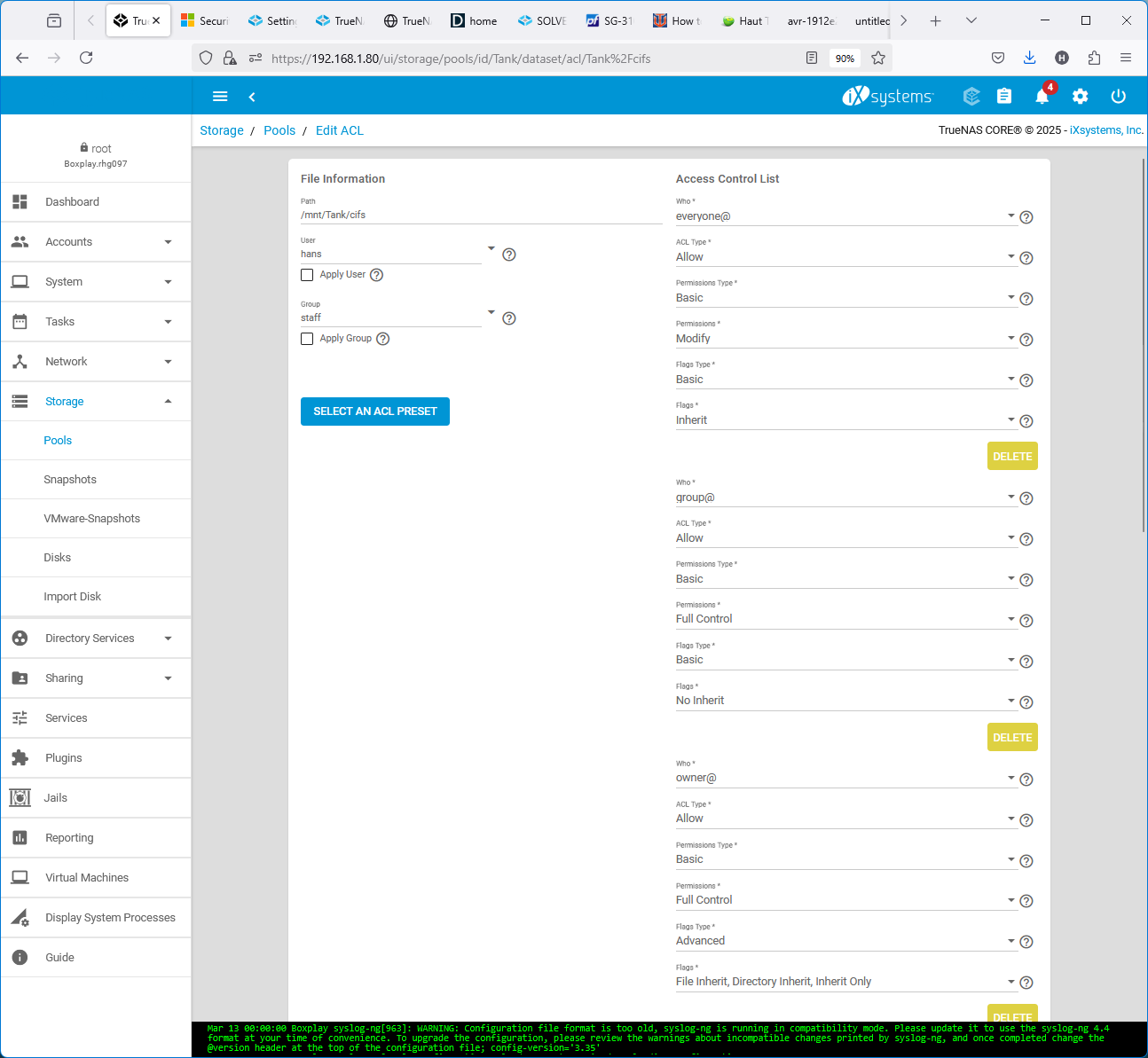

Dataset ACL below. Two images since too large for one browser page.
Personally I leave user and group alone so root and wheel. I’d then remove the everyone@ group@ and user@ and just have one entry for my user or group. I find this gives best results.
The User entry wasn’t there at first, it appeared after I mounted this share from a powershell terminal using
net use /persistent:yes
net use * \\server\sharename *
And after that it hasn’t given me any grief, at least not yet.
