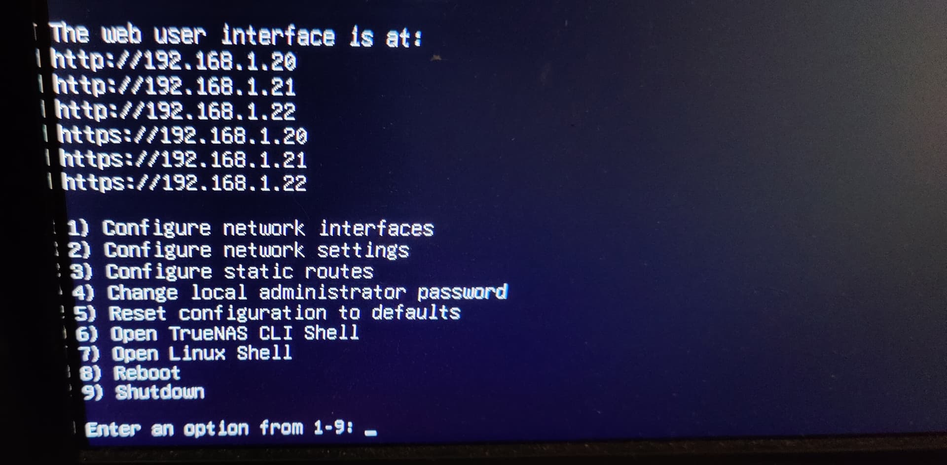

Looking at your previous response, it is more and more seemingly an issue with the OS. When you boot up, using a screen connected directly to the server, does it give you any ip for the web interface? What have you done in any of those options?
Have you set any of the interfaces to static? if so have you made sure your subnet and default gateway are set right? Sub: is generaly 255.255.255.0 on ipv4 and default gateway is usally the ip of the router. Dns should not matter unless you are trying to do updates or something that requires access to the internet.
Oh, and since you ahev mutiple NIC’s, are you sure you are plugged into the one set as default? I do not know if you have any sticker near them or on the back plate that has the MAC address to verify you are plugged into the correct NIC.
On that screen I’ve tried the options I mentioned in my first message (option 1 on your screen), and also just opening a Linux shell (option 7) and setting a static ip via ifconfig. The ip, subnet and the rest are correct, because as soon as I unplug from the switch and connect to the router, it works. Move the cable back to the switch, and it doesn’t.
