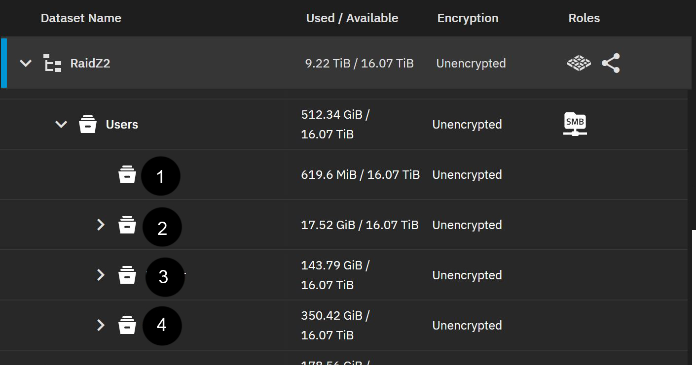

Ok, so I thought I had a grasp on Snapshots but I am clearly doing something wrong. I made a mistake on a file and to my surprise when I went to previous version the folder showed empty. This is my setup. Raidz2 has “Users”. Inside Users is people’s names (lets just call it 1,2,3,and 4 for simplicity).

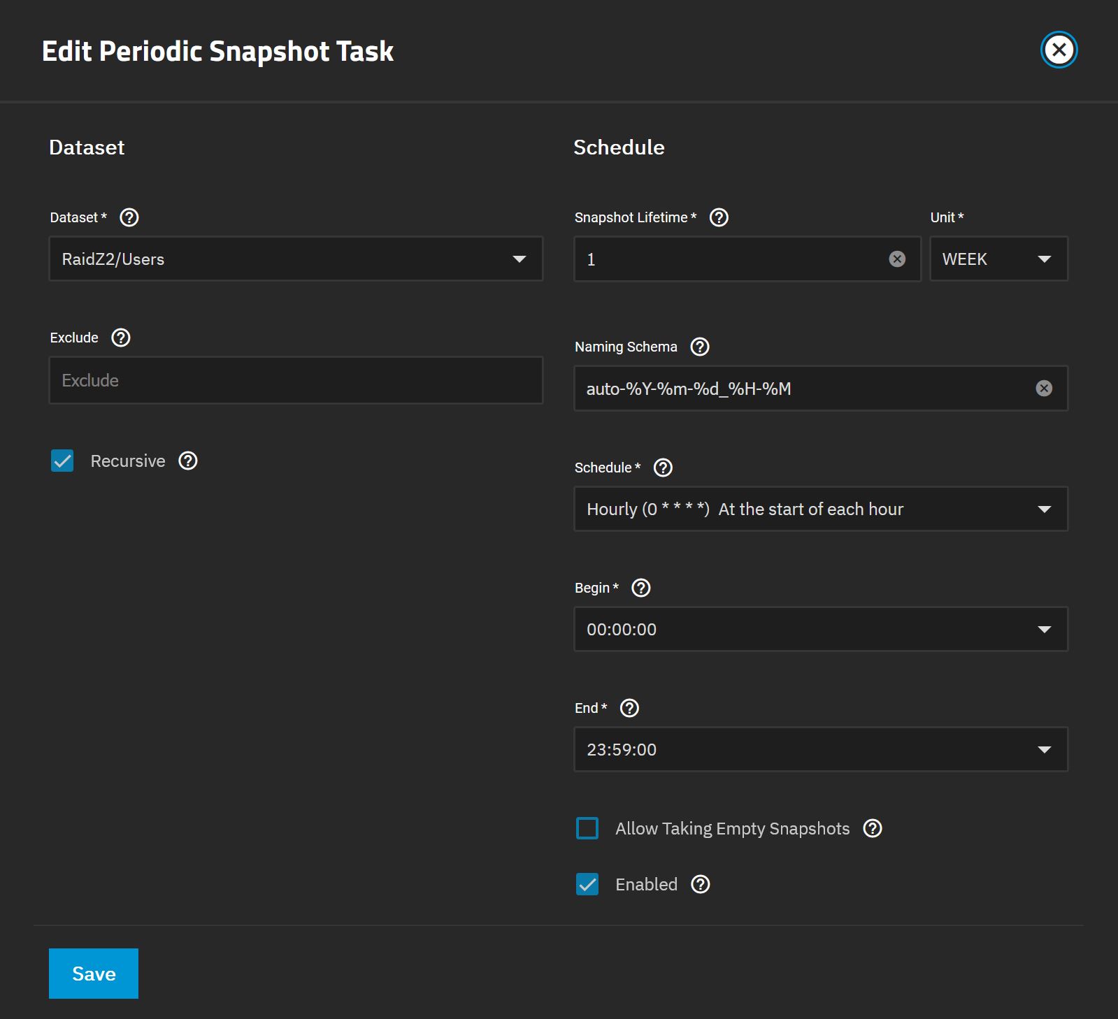

I want everything in here to have snapshots taken. I thought I had it set up that every 5 minutes it will take a snapshot and keep them for an hour.
Then take one every hour and keep them for a week.
And every one day take one and keep it for 3 months.

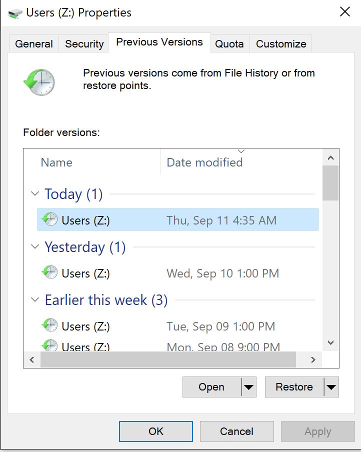

When I go to previous versions of User 1 I am met with this.
When I go to previous versions on the Users folder I see a bunch of snapshot had been taken but…
All of them just show as empty.

So you don’t see anything wrong with how I have the snapshot tasks set?
No that all looks good to me. Like I say the only alarm bells are the nested datasets shared out via one share which isn’t the end of the world but generally discouraged.

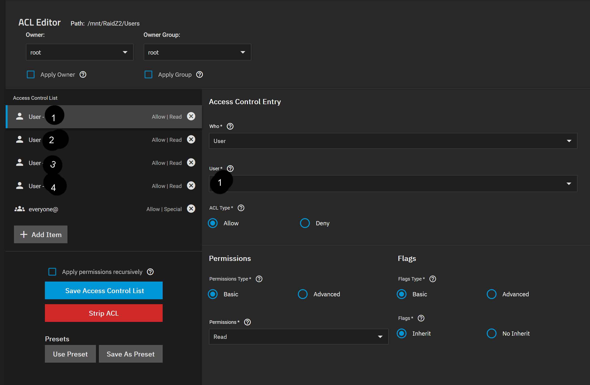

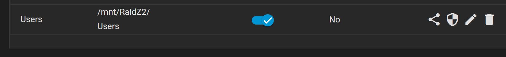

Can you share a screenshot of your share config.
and also permissions on one of the datasets.

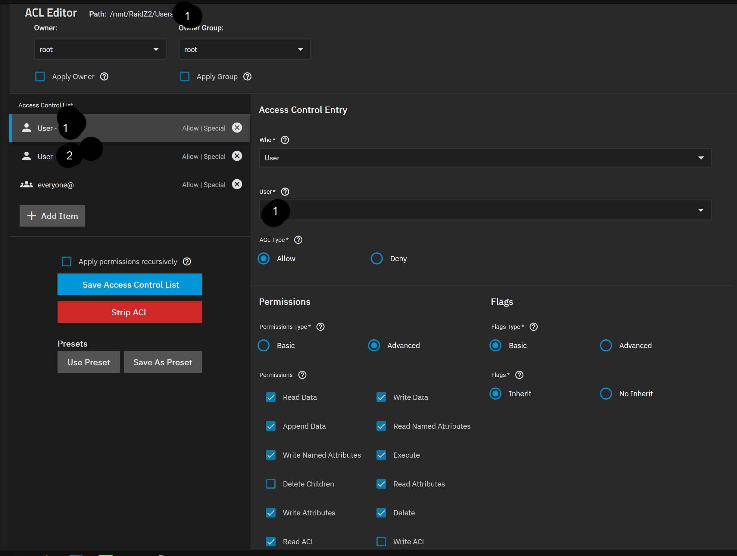

Here is everything from the share section…
and this is the permission on “1” which is the user account I’m using.

There is a possibility that one task (hourly expiry) is inadvertently pruning the snapshots of the other tasks (weekly and three-monthly expiry).
I don’t want to jump to conclusions, but it might be related to this. I’m thinking I need to rewrite that post for the new forums and make it easier to read.
There’s just not enough information and confirmation to go by to know if this is what is happening or if the issue is less severe, such as nested snapshots not presenting themselves through Windows File Explorer properly.
This had crossed my mind also. Perhaps try staggering the periodic snapshot schedules so they don’t overlap. For example make your hour for a week snapshot happen at 1 minute past the hour etc.
Also I modify the naming schema with just a simple -1d or -1w on the end to denote the length of time the snapshot will last. Makes sorting easier if you ever have to manually prune. Can also be useful in complex three-way replication setups.

Snapshot Task For Dataset “RaidZ2/Users” failed: cannot create snapshot ‘RaidZ2/Users@auto-2025-09-26_14-55’: dataset already exists cannot create snapshot ‘RaidZ2/Users/user2@auto-2025-09-26_14-55’: dataset already exists no snapshots were created…
I’m going to change the naming and see what happens. What you say makes sense.
