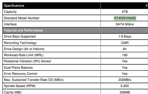

I think a RAIDZ1 for 4TB disks is optimal. Higher capacity drives you should start considering RAIDZ2 due to risks during long resilver times. If you post the drive models I can help you confirm if it is CMR or SMR… multiple posts on why SMR is to be avoided; short version is poor performance on ZFS, instability, and high risk + long resilver times during replacement.
I am currently running 2 Seagate IronWolf ST4000VN006 4TB 5400 RPM 256MB Cache SATA 6.0Gb/s, and was going to buy a 3rd for rz1. I believe these to be CMR though I could be wrong.

Also, afaik your 4tb drives are CMR. I agree with the raidz1 solution

Confirmed CMR - I agree with the cache drive brought up by oxyde. Generally, unless you have a very specific use case, more ram will always be the best upgrade over L2ARC, ZIL, or SLOG.
