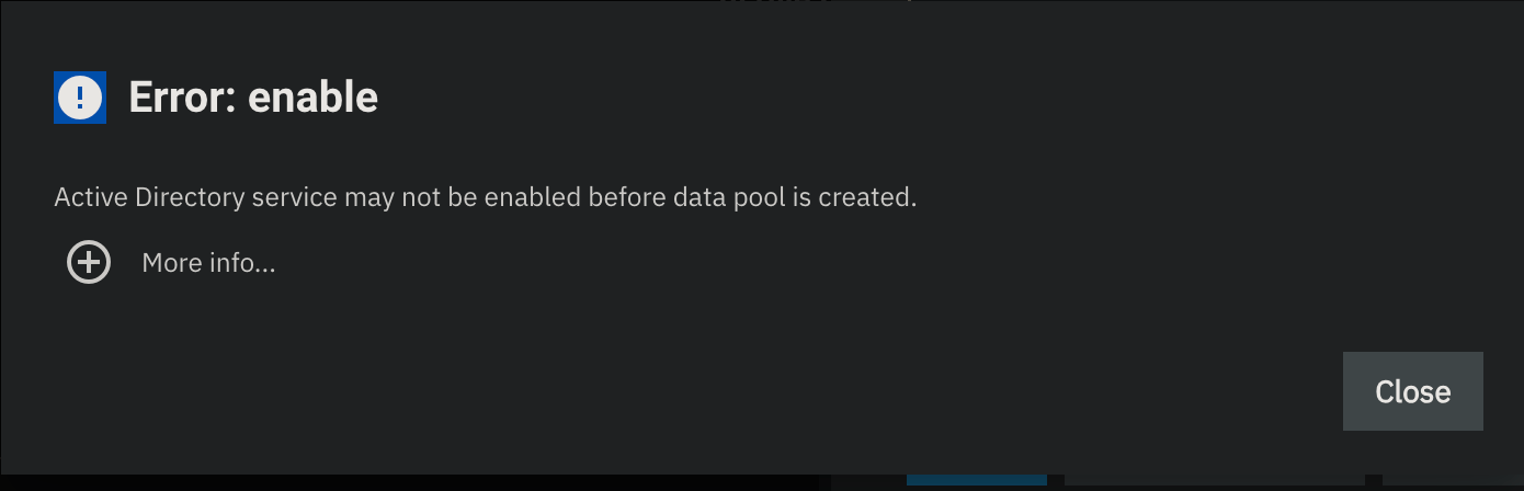

Why can't i use the boot pool for Active Directory?
I am intrigued as to why i can’t use the boot pool for Active Directory, its not something i really want to have on a data pool that might be exported…
any idea why the restriction exists?
any way to tweak around it?

This has more to do with our HA product than anything else. In that case the system dataset always resides on the data pool and so AD state moves between storage controllers. I don’t anticipate us making changes any time soon for the stable product, but maybe in a future release we can consider it. Generally in enterprise people aren’t exporting / importing pools regularly (or rebooting servers for that matter).

Question, is it possible for me to move the .system datapool back to the boot drive (which is a mirrored pair of PLP NVME drives and as such gives me better protection on write consistency than my my data pools)
Yes, this is under System → Advanced → Storage. Expect services that depend on the .system dataset to stop and start.
Perfect, thanks, just the solution, i don’t think the requirement to have a data pool should be needed to install AD as all that is needed is the .system dataset to exists (but I cosnider that a VERY low prio fix) as the config is put in .system and that is moved automatically when a data pool comes along - seems a pointless, but ultimately harmless pre-check. It only blocked me until i got some data drives installed.

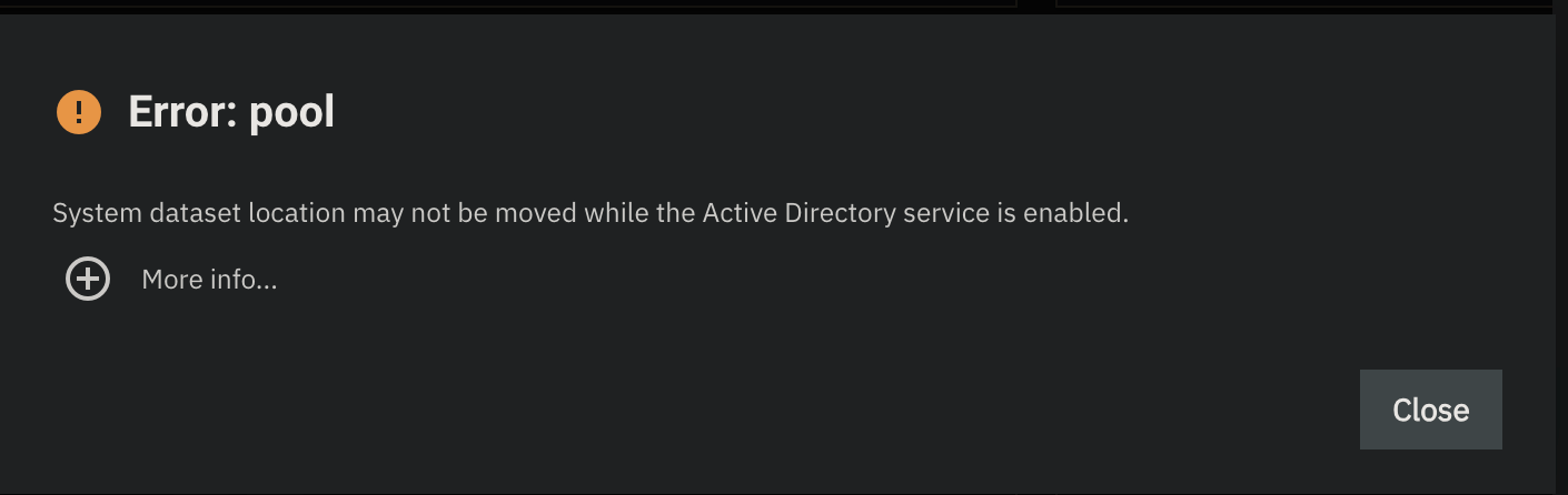

Moving the pool worked - though interestingly it warned me SMB would be stopped, asked me to verify and the blocked me because the AD service was still enabled - would be nice if it stopped and started the AD service for me too!
