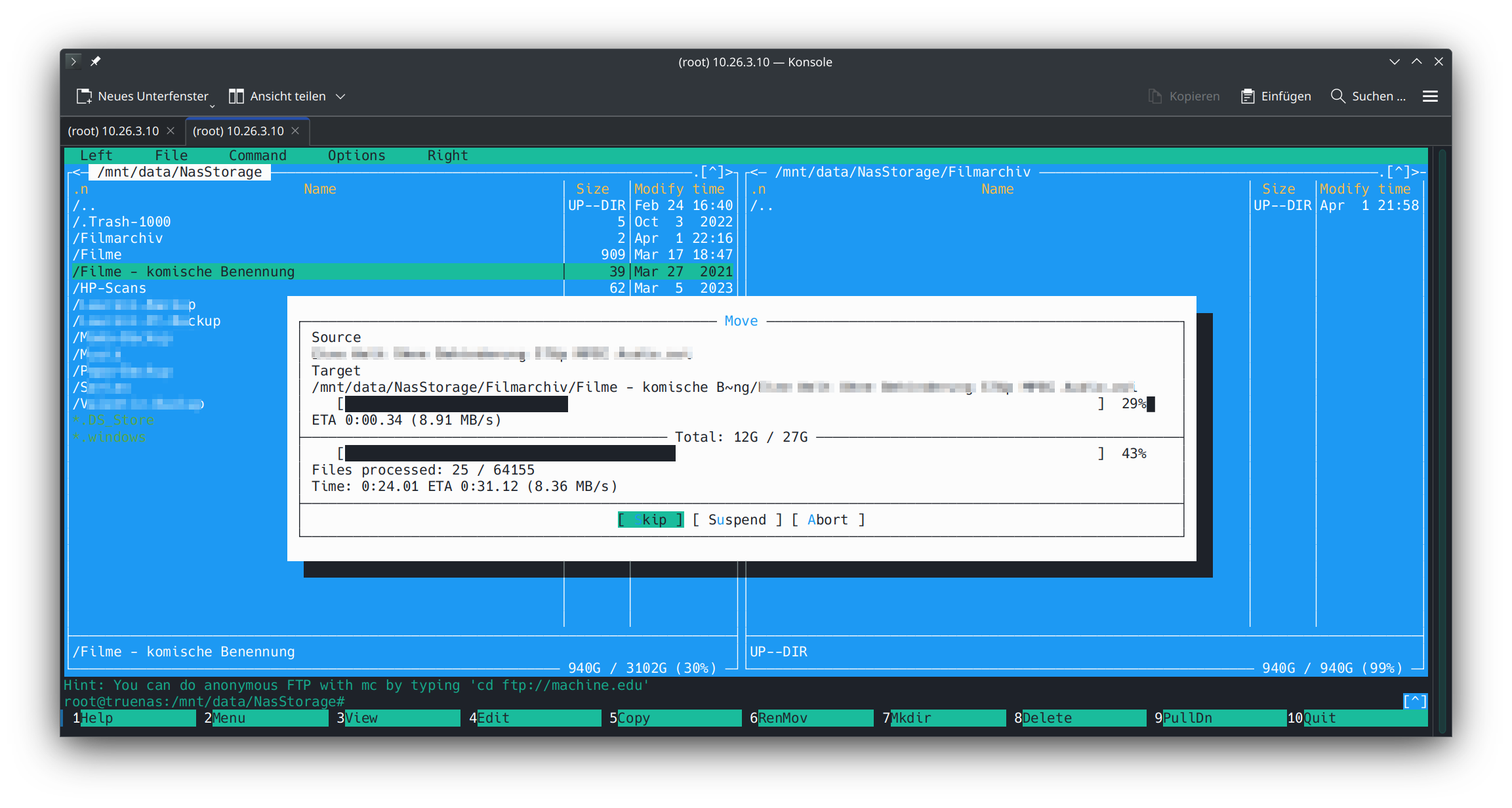

I first tried to move the files using the regular mv command, but this took forever with no indication of progress, so I aborted it and tried it again using the in-built Midnight Commander.
This showed me that the move (or rather a copy, because apparently inter-dataset moves copy the files from one file system to another) is just at around 6-8 MB/s.
I think this is way slower than expected, since my pool is on a RAIDZ1 array, consisting of 4 SSDs (regular SATA ones).
I think something around 150-500 MB/s should be realistic, right?

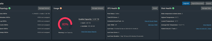

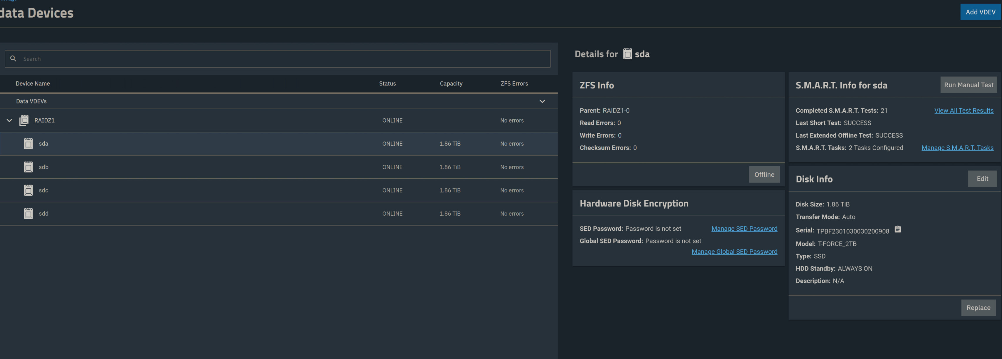

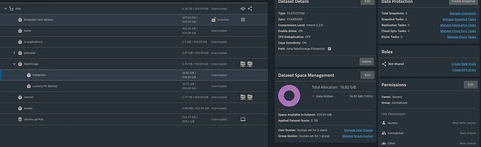

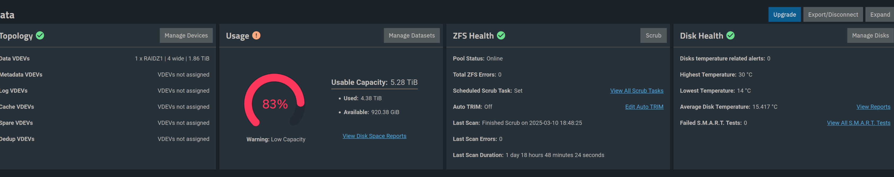

Here are some screenshot from the TrueNas UI, in case the help:

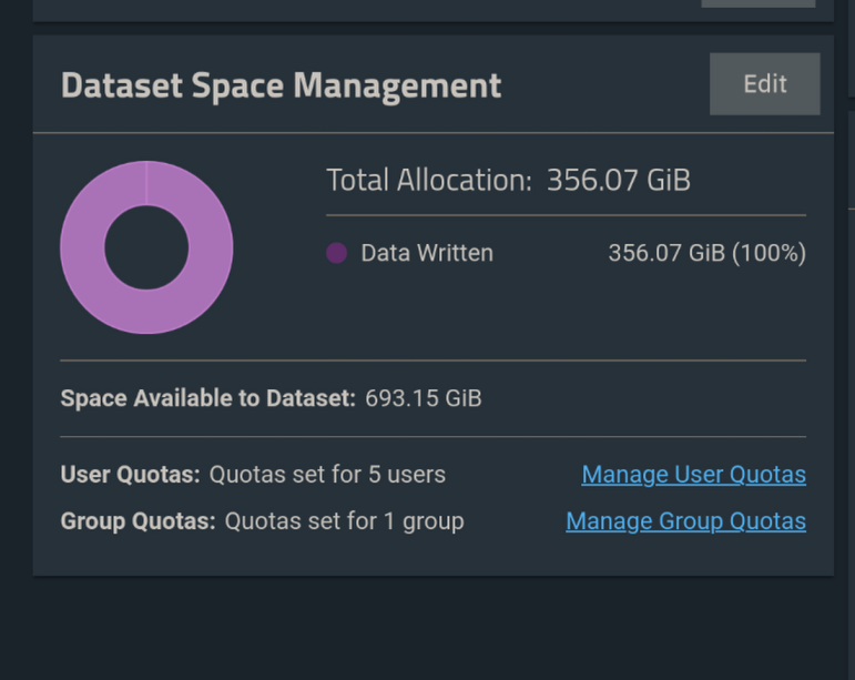

I’m not an expert but I see the is a quota applied to the target dataset and I remember reading that quota can lead to lower performance then expected.
Someone with more knowledge about it can correct me if I’m wrong.
What speed do you see when copying on a target dataset without quota or from a source outside the same pool? Do you see the same slow speed or is it normal?

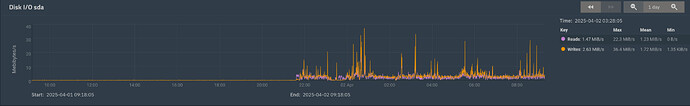

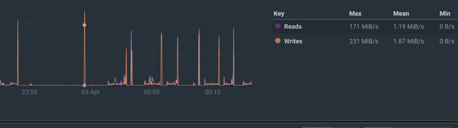

Looking at the TrueNAS stats (just one drive), it looks even worse:

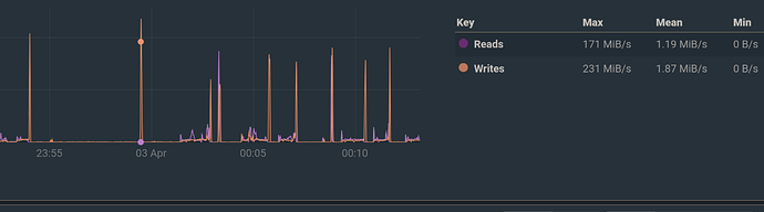

Furthermore, the whole system becomes really slow with the copying in process, even tho the system load is quite low:
I cannot use my Nextcloud instance anymore because of this.

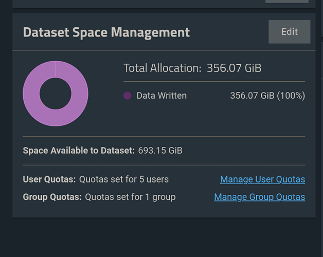

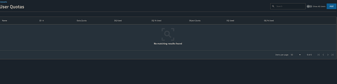

Btw: TrueNas still tells me that I have some user/ group quotas for the dataset
But when i click on the link, nothing appears:

I noticed that the copy speed varies a lot, even tho the directory consist almost exclusively of files larger than 1GB.
This can also be seen in the statistics, where some transfer speed spikes go to hundreds of MiB/s but most of the time it remains much lower:
