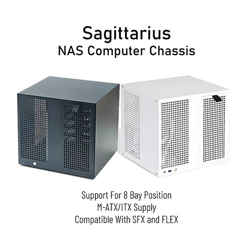

I ordered this Saggitarius case from AliExpress, still waiting shipment. Based on reviews the hdd temperatures stay real low in this one. It has a well separated dual-chamber layout. I want also to upgrade my game with a bigger case and I found this one very interesting.
It has a nice backplane. One 4 pin molex connector per two disks, so 4 molex power connectors total. I like this, the voltage drop on 12V cables should be low thanks to this.
But there is no drive activity LEDs.

The Sagittarius is available in this country too for a higher price from NewEgg. With shipping, it comes out to a similar cost as ordering direct with AliExpress. Or there is a similar B10 case that can allegedly hold 10 3.5" HDDs and they even show off their backplanes. If you go back to AliExpress, you can see that it’s similar to Sagittarius in that you have HDDs in the front, a up to ATX motherboard mounted on the ground behind the HDDs and the ATX PSU mounted above the motherboard (see here)
To me, that’s pretty tight and the CPU better not need extensive cooling or the HX will interfere with the ATX PSU above. I am also unimpressed with there not being a wall of fans behind the HDDs. The two fans they do show in the diagram upstream of the HDDs are only cooling 8 out of 10 HDDs. So this is potentially a HDD cooker.
The B10 looks very compact and still supports M-ATX boards. Regarding HDD temps, I’m sure they will be cooking in there, because there is not enough air pressure difference from the rear fans. I mean, the rear case fans will pull air from the side vents and a little bit only from the HDD cage (air resistance). This very same issue prevented me from buying something like the Inter-Tech NAS-8 which otherwise would be my dream NAS case. With some case modding though it actually could work.

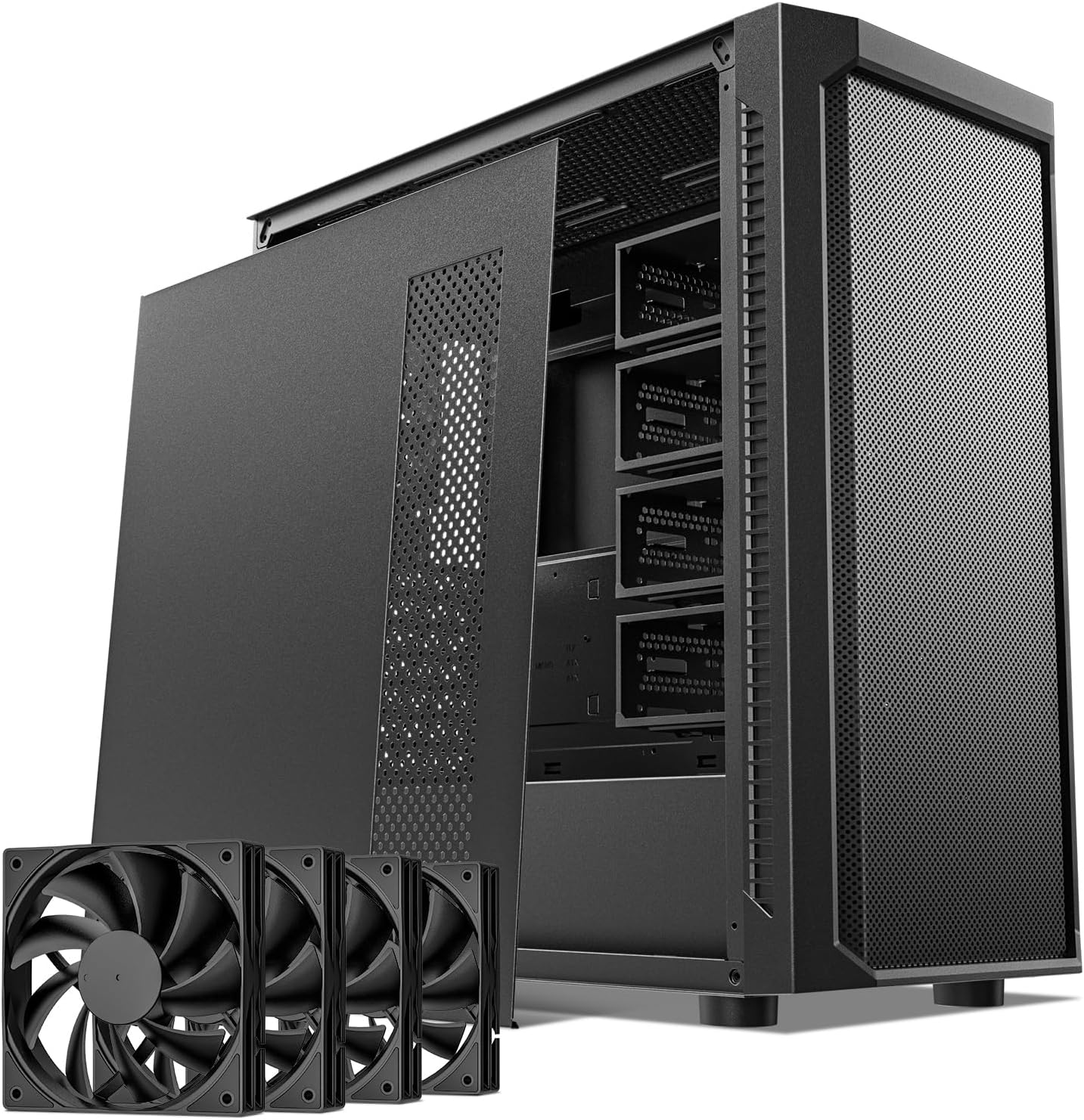

I picked up this case most recently for one of my NAS’s
That looks eerily identical to what I made with drive cages from other cases & a left over tower I had from an old build - down to the glass panels that block all airflow & require creative solutions. Drilling holes & bolting in cages looks downright silly when this thing is $90…
Edit: oh, this thing has perforated side panels - this is much less stupid than what I made. Didn’t notice until I actually looked at the listing.
