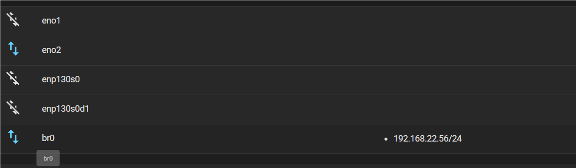

truenas-scale network is classic configuration.

I found the problem. My wg device name was not configured correctly. It was not eth0.
