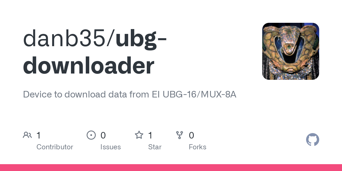

I remember the Teensy[1]. It was key to this project of mine (for which I used Eagle for the PCB layout):

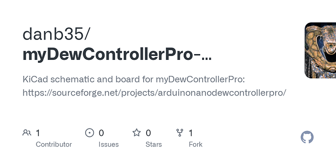

KiCad seems pretty good these days, and has a pretty extensive parts library, though still probably not as large as Eagle’s. But it worked for this:

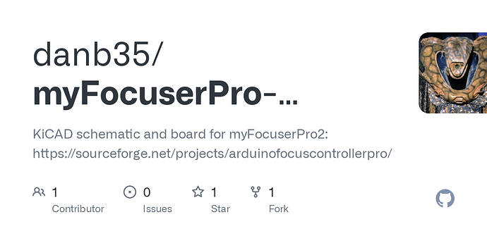

and this:
