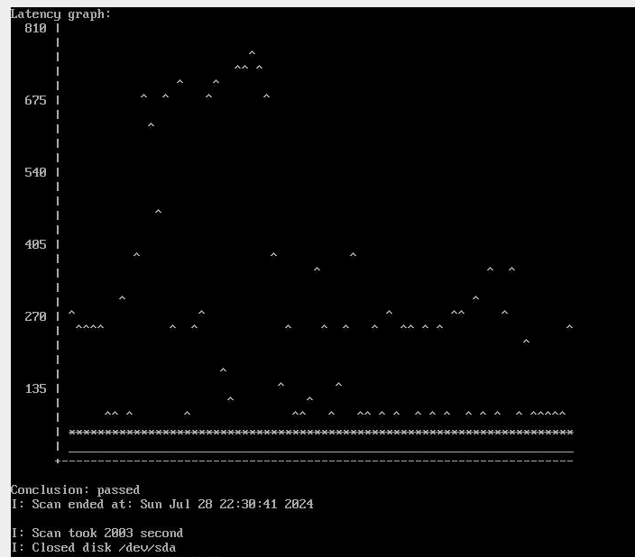

If you’re looking at this in the future trying to solve the issue. Download a live distro, I used “hrmph” (funny name but loaded with useful utils) or install TrueNAS on another disk and check SMART. Both drives had an ungodly amount of errors. Only grabbed this screenshot. If it had been one drive I would not have been tripped up but, being both I assumed it must be something else.

Updates: the disk that seems to always throw the FPDMA error passed an entire run of diskscan. Running the other drive through now. Next will be sdparm. I am guessing that the same command is never being used by this test though so that could be why. The first disk (/dev/sda- photo attached) is 64GB and took nearly 33 min. The second is 16GB and took 4 minutes (/dev/sdb - photo attached). Not sure how useful either are but this issue is so weird that I am having a hard time knowing what to do without a second working system to test components on.
diskscan /dev/sdb result:
diskscan /dev/sda result:
