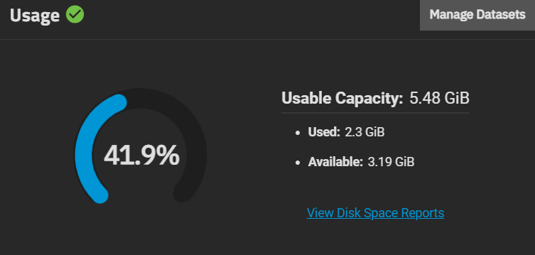

Anyway…I made a fresh install to see if the problem comes back. After few changes the storage was at 2,5% so I installed immich. I saw that there is in storage a hide folder called .ix-apps. After installation my pool is used for 41,9% (2.3 GiB) but again it has no sense. According with ‘sudo dh -h’ that folder is more then 4.5G

while ‘zpool list’ says 5.0G free
truenas_admin@sharednas[/mnt]$ sudo zpool list tank
NAME   SIZE  ALLOC   FREE  CKPOINT  EXPANDSZ   FRAG    CAP  DEDUP    HEALTH  ALTROOT
tank  8.50G  3.45G  5.05G        -         -     3%    40%  1.00x    ONLINE  /mnt
and ‘Usage widget’ report 2.3GiB
I’m very confused !
Alex
Not running dh as sudo means that it doesn’t include any data you don’t have access to. Running it with sudo has given you reasonable numbers.
The discrepancy between du reporting 4.5GB of actual data (the size in bytes of your data) and zpool list reporting 3.45GB (the disk space actually used) can be accounted for by the default ZFS compression.
