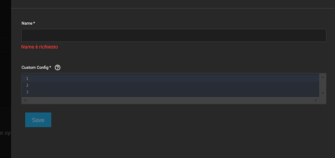

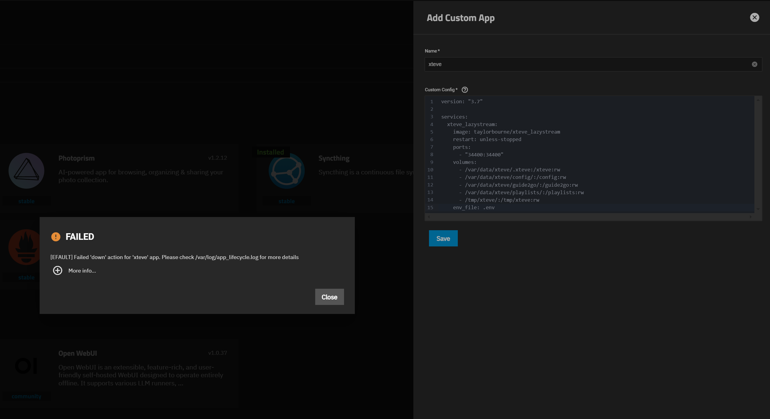

Hi and thanks for the reply… Help me fill in the fields. After clicking on “INSTALL VIA YAML” this window opens
Ok this is how i’d aproach it:
- Choose on which pool the xteve data should live and create a dataset for it.
- use the compose file linked above and adjust the paths to match the
datasets i created. - download the example .env file see if it needs to be edited and add another
mountpath for the .env file - fill in name field xteve
- copy the adjusted composefile in the field custom config
- hit save and see if the app deploys or if acls need to be adjusted on the
hostpaths.

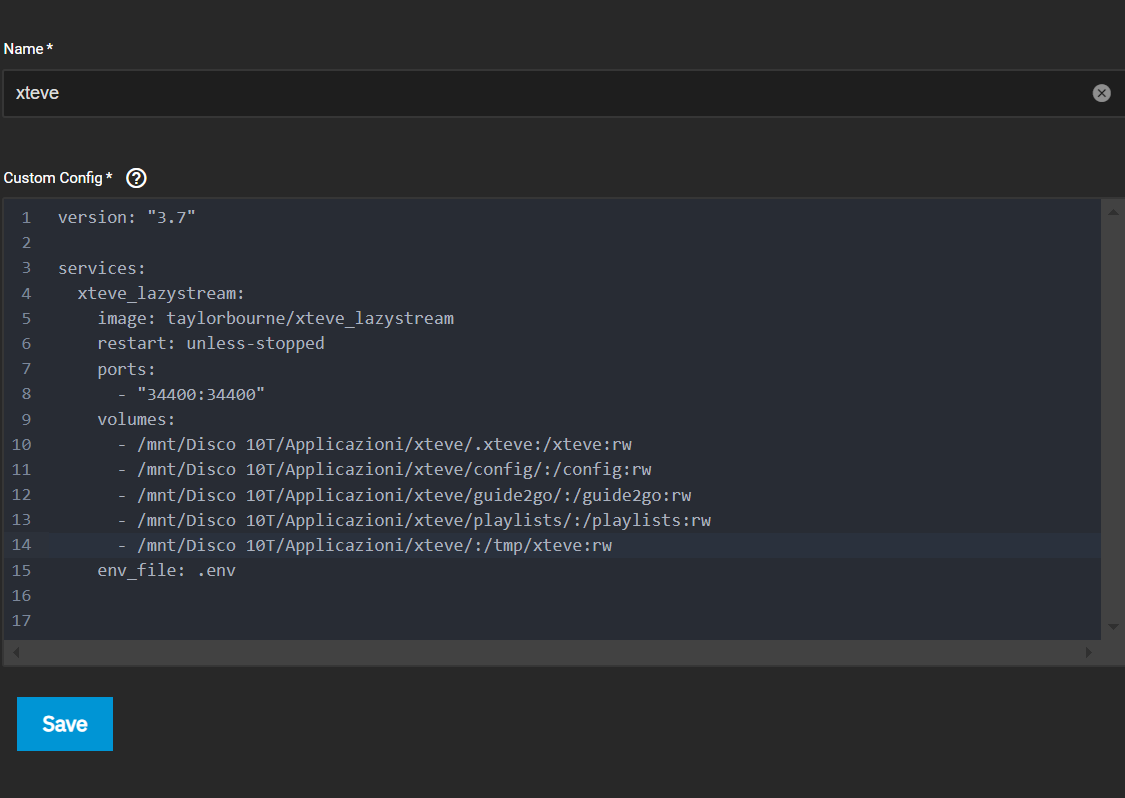

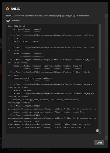

Ok i’ve taken a closer look at your compose file.
The storage paths look fine so far, apart from the space in your pool name, which may lead to problems.

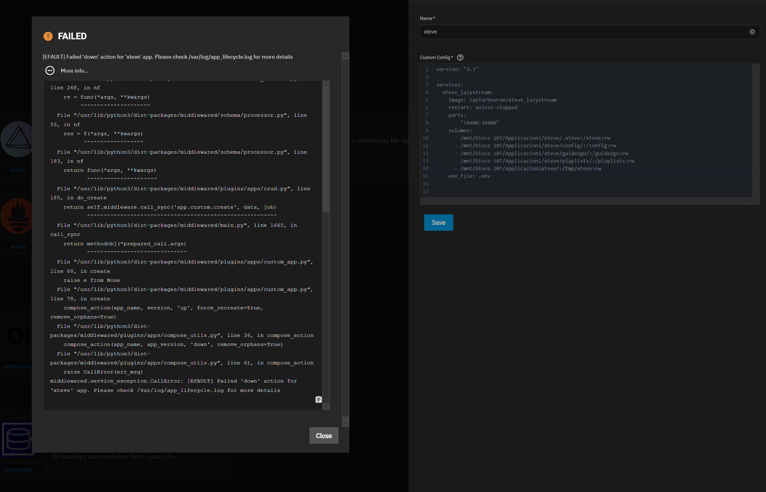

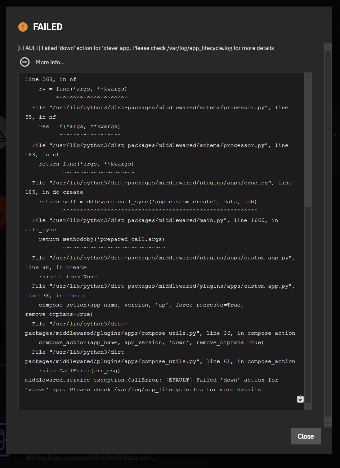

Did you download the .env file and place it in the config dataset?
Have you taken a look at the lifecycle log for further debugging?

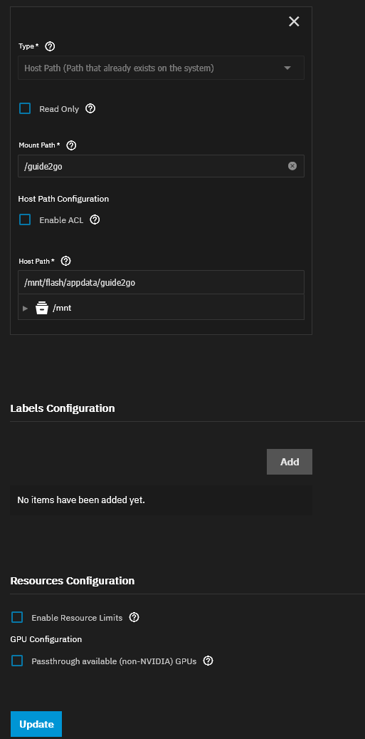

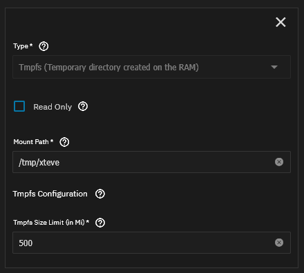

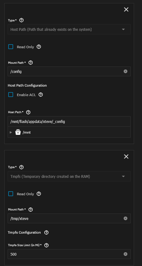

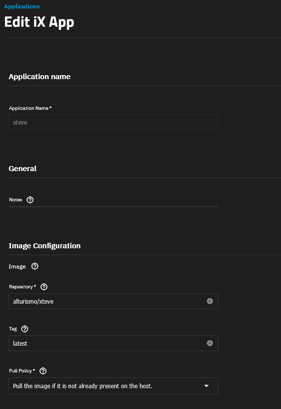

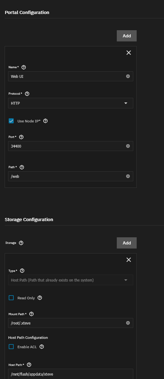

If the compose file is a struggle for you - you can do it with a regular custom app this is how I did it). I used the repository of alturismo/xteve:
And you will need several host paths:

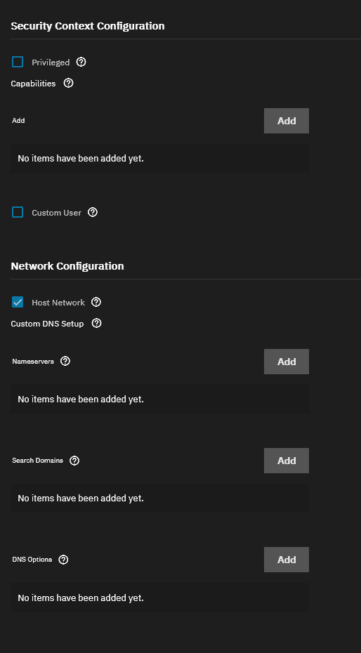

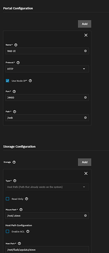

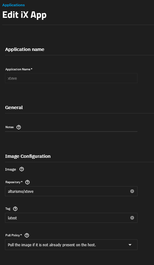

can i use this configuration, obviously changing the path of the folders?? does it work for you??
yes, sorry - noticed and edited my post now ![]()
edit: @landtools - yes, it has been working for me for a looong time
Kindly, can you give me a screenshot of the whole configuration?? Thanks

ok, I’ll copy it exactly by modifying my paths and let’s see if it works
