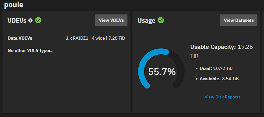

I had a 3 wide RAIDZ-1 pool of 8TB disks, and I added a 1 8TB disk. After the attach operation, the UI displayed a usable capacity of 19.26TiB and 10.72TiB of used capacity (see screenchot below)

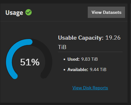

I read that after an extension of a VDEV you have to do a zfs rewrite to reorder the blocks of the pool and this helps regaining the full usable capacity. Si I did a rewrite on my whole pool, and now the UI displays this :
Doing the maths, I should have a roughly 21TiB of usable capacity with a 4 wide 8 TB pool. Why do I only have 19.26 and is that normal ?
