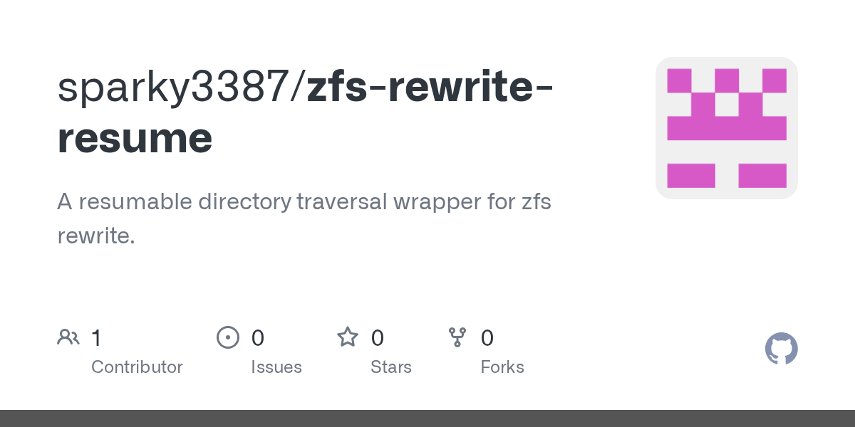

Just wanting to share my resumable ZFS rewrite
I had my ZFS REWRITE stop/pause while two programs where trying to access the same block of data (I believe thats what it was at least), and at that point i was over 24 hours in.
Instead of restarting the full zfs rewrite I wanted to just resume, this wrapper uses the same traversal method as the original zfs rewrite method so it should resume ok.

Tom’s video was what reminded me to upload the resumable zfs, i checked it against the source code and last 1000 files with a dry run to confirm traverse was the exact same
