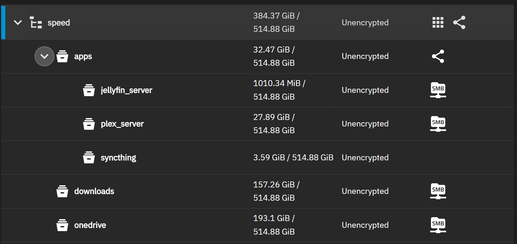

I’ve been playing around with ‘immich’. Now I wanted to start fresh and for that simply delete the child dataset ‘immich’ and then create it again.
But when creating it again:
[EINVAL] pool_dataset_create.name: Path /mnt/speed/apps/immich already exists
However the dataset clearly does not exist anymore.
But the folder with all its contents still does.
So to reuse the dataset name I have to first delete the folder manually via the shell.
  1. why does “delete dataset” not detele the data/folders?
  2. the error message is wrong and should be changed as the dataset does not exist, but a folder with this name does

  1. Via the webgui I created the child dataset ‘immich’ inside the dataset ‘apps’
  2. via the shell I created the folders required for immich inside the immich dataset: library, uploads,thumbs,profile,video,backups,postgres
  3. via the webgui I added and configured immich, pointing to the folders inside the immich dataset
  4. played around with immich until I decided its time to start fresh and deploy it ‘for real’
  5. stopped the app via the webgui
  6. via the webgui I delete the child dataset ‘immich’
  7. then via the webgui tried to create it again, got the error that it already exists
  8. rebooted TrueNAS
  9. via the webgui tried to create it again, still got the error that it already exists
  10. via the shell found that the folder ‘immich’ with all subfolders still existed
  11. deleted the folder ‘immich’ using rm -r , now I could create the child dataset
I did not remove the immich app - I only stopped it.
I should have made a screenshot of the error window in the webgui as that read ‘dataset allready exists’. :slight_smile:
You are right that the actual error message inside the collapsed window (which I posted) is correct as it says that the path exists which is how I found out.
The error message inside the window should also say “path exists” not “dataset exists”.
All the subfolders from immich were still there, I did not investigate past that. Sorry.
I went with rm -r right away.
