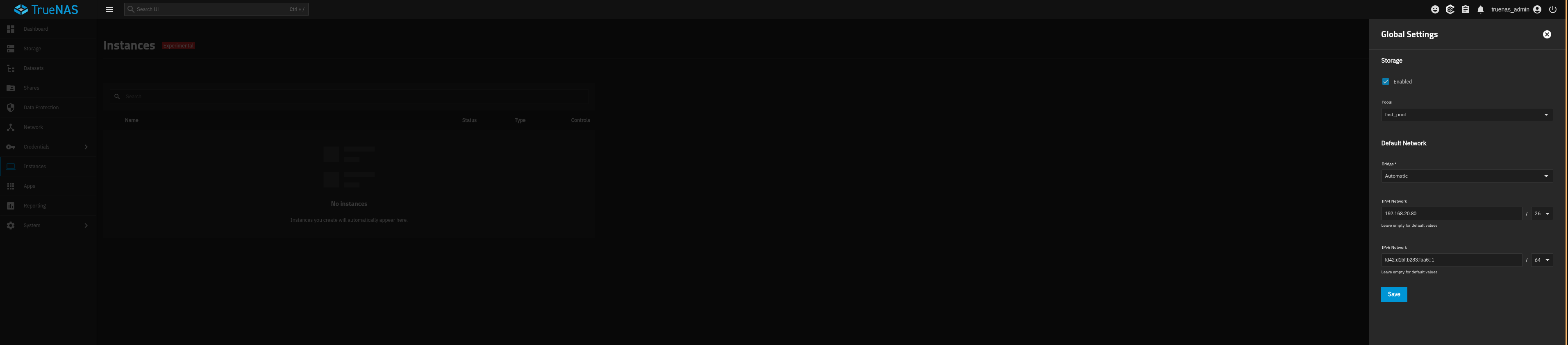

I had the same thing. All my instances were mising after upgrade, which caused a minor panic.
It seems that there is now the capability in 25.04.1 to select the pool(s) for the images. As part of the upgrade process, it picked up multiple pools (including my backup pool), and then errored because of a “Duplicate name”. Easy fix for me was to go instances->configuration->global_settings and then select only a single pool. Then, my instances list went from empty to all my old instances, which started correctly as before.
Anyway, this is just my experiance that might help.
Unforutnately, that doesn’t work either. I have two pools - but it is picking the right pool. So odd :frowning:
Curt

When I boot into 25.04.01 I get the following error:
(see top right).
When I boot into 25.04.0 - where the error is - it says has a check mark and says “inttiialized”.
I am still relatively new to truenas - can someone direct me to where I might be able to look at the log files and see what the error might be?
