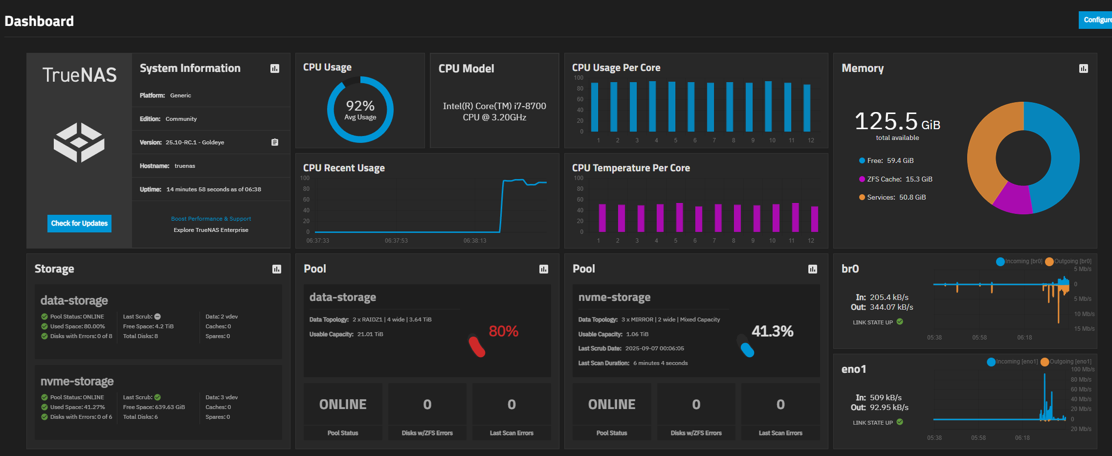

Yep sorry, was waiting for the system to come back up before I took a screeny.
No apps, no containers, just storage and 2 VM’s. I don’t know what logs to check, hence I’m asking, never had a problem before.

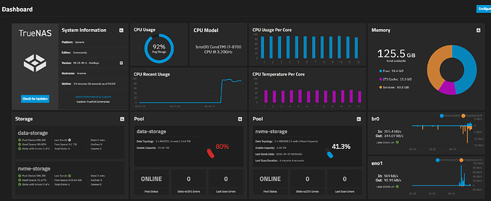

I used to have all that info in my sig on the forum will see if I can add it here.
Your pool is 80% full. That is why it is in the red and can easily cause issues. Increase the storage capacity or remove some data from the pool.
it’s a good point, I have 2 8tb drives in transit to swap with 2 4tb ones. this has been happening for a few months though, and I do believe began at around 75%.

Because of the increased overhead and performance issues when the pool os at or above 80% the system will become stressed and with the pool fragmenting to the point where it becomes very sluggish and depending upon hardware eventually non responsive which in turn makes the system non responsive as a whole. If a reboot is taking care of the responsiveness for a short period then you are, IMO, already in this phase with the hardware you are using and need to do something about it now not later. This as been explained many times in the forums and I believe is even in the docs and I think your issues will subside once you get usage back down to around 60% or less.
