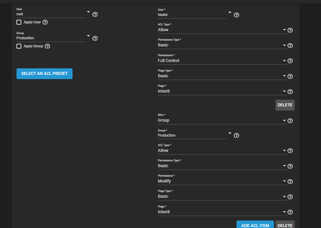

Can we take a look at how you’ve set permissions in the TrueNAS UI please.
When setting up an SMB dataset in TrueNAS I typically follow these steps:
Create the dataset and set the Share Type to SMB.
Select the dataset and click Edit Permissions.
Use the ACL presets with RESTRICTED as my preferred choice.
Leave root and wheel as owner and group.
‘Add ACL ITEM’ - Grant my users group Modify access.
‘Add ACL ITEM’ - Grant my admin group Full Control.
Remove the owner@ and group@ ACEs as they are not needed (in my case).
Click Save and proceed to share it using the default settings.

Hi there, when i complete this then all my users can access the parent folder but the folder is empty?
Why not setup a test dataset using my above suggested config and see if you get better results. If so you can then change accordingly.

Hi there, interesting creating a fresh dataset works, so why with the same settings does my datasets not work, i wonder if it is due to i remove wheel group and add my group i created.
That does indeed seem like the only noticeable difference.
