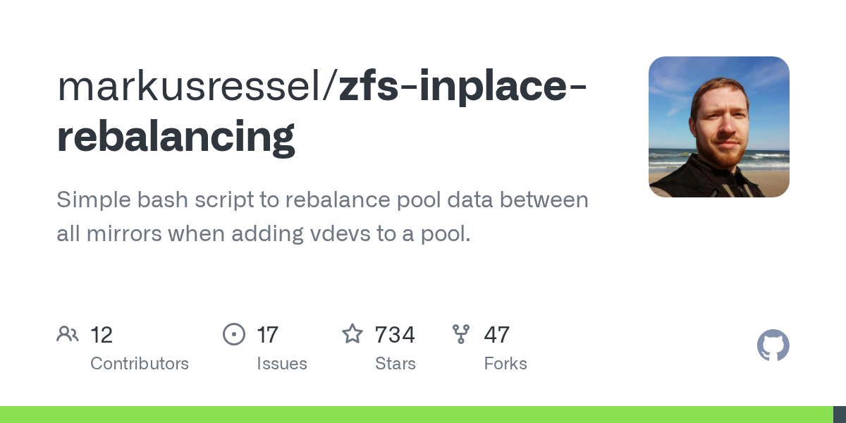

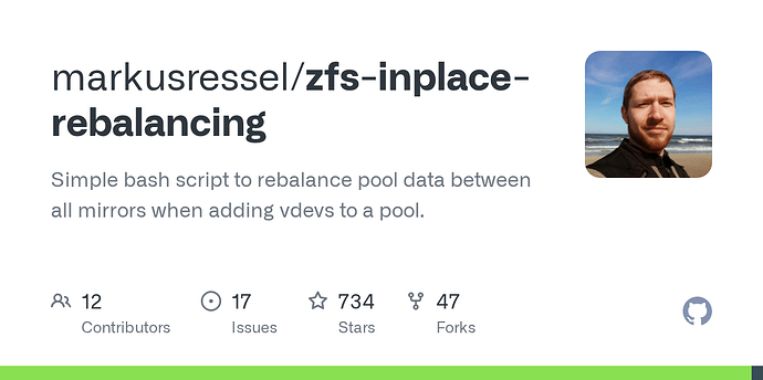

As for the exact method to use, many people use a re-write script. These forums have a link to one somewhere. Another method could be by ZFS Send & Receive, but again you need more free storage than you likely have.
