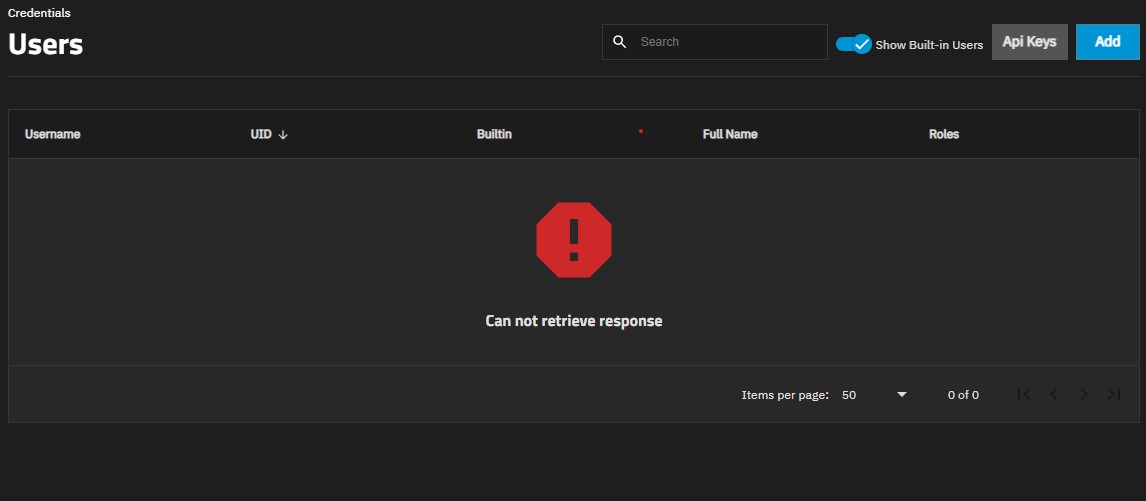

Yeah, but there are no users under credentials/users

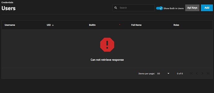

I just get ‘can not retrieve a response’ as picture shows
Thats odd. I presume you have refreshed your browser etc?
Yes I have tried everything! It’s the same on my mobile browser
Perhaps a server restart? What are your hardware specs?

I upgraded a couple of days ago, but just restarted to check and its still the same
From what?
25.04
Meaning it had recently restarted

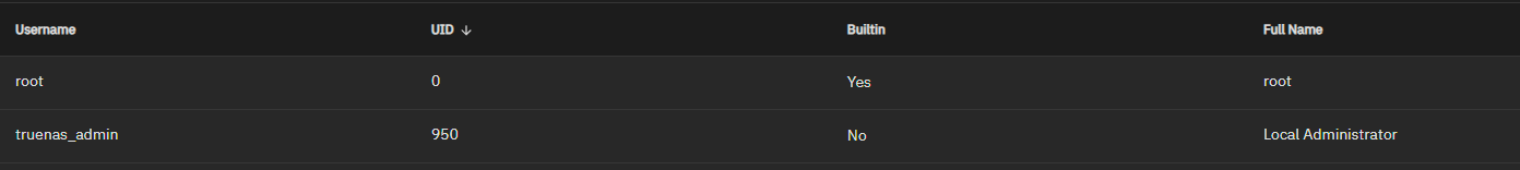

i must be doing something wrong again since both root and truenas_admin show up for me on 25.04.1 without showing the buildin users

Turns out I can see the admin user, but it wasn’t where I expected it–it’s user 3003, not user 950.
Where are you seeing that?
I appear to have something horribly wrong!
My admin user, created during initial install, has a UID 1000.
It depends on when you created it. Is 950 from the Core installs?
Nowadays it’s created with a UID in the 3000 range for “reasons”.
Naah I installed scale when 22.xx was in beta, but I’ve recently had to reset my config and during the new setup the admin user was created.
Hmm, I may be misremembering things.
My 1000 UID is from the winter/spring 2022 Angelfish release. Maybe I made my own and removed the default admin account?
No, CORE only uses root, which is UID 0. CE 25.04.1 creates truenas_admin as UID 950.
