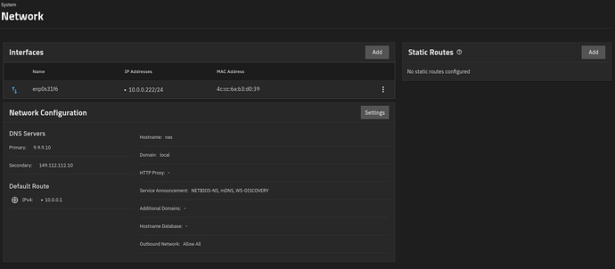

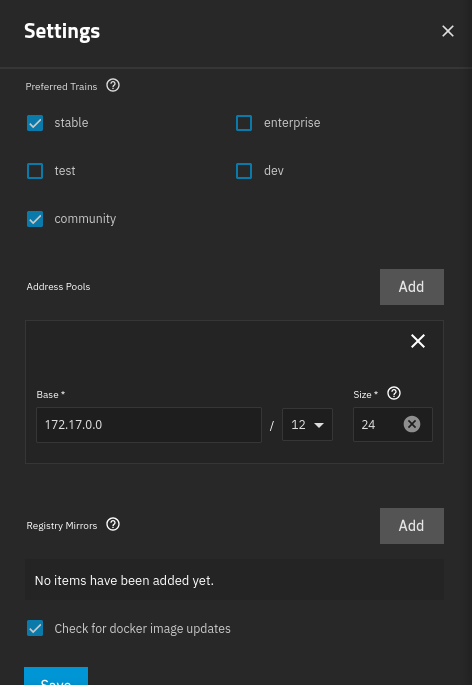

Apps service refuses to start no matter what after update
Actually finding the source issue would be nice, so ill try to figure out where the logs are then I’ll think to fix it or recover it and move to having docker separate.
I believe the Docker logs are at /var/log/daemon.log. Your app configs should be at /mnt/.ix-apps/user_config.yaml. Apps disappearing might just be as simple as the Docker overlay directory in /mnt/.ix-apps/docker/overlay2 getting confused because the hashed directories there don’t match the app hashes any more, which might be a function of your BIOS time being out of whack. BIOS time has to be set to UTC. Run timedatectl to see if your BIOS time is out of sync with NTP.
Thanks, almost would have not copied the user_config.yaml (should have taken a look at the actual file content).
I checked the BIOS time, its synchronized.

Of which I think this might be the issue?:
dockerd[77154]: failed to start daemon: Error initializing network controller: error creating default “bridge” network: cannot create network fed59d951cb28fdc4b19e31339bb70da3296fa76d0e015114f7f2148e3531939 (docker0): conflicts with network 3587e77db42617e0a484e93067d2d0c8874fe0a344f66266171973061603c114 (docker0): networks have same bridge name
That’s the next thing I was going to suggest to check. Can you provide your TrueNAS networking configuration and the output of docker network ls?
When I run the command I get:
Cannot connect to the Docker daemon at unix:///var/run/docker.sock. Is the docker daemon running?
Try deleting /mnt/.ix-apps/docker/network/files/local-kv.db. This may allow the Docker daemon to start.
Did that, now the command runs without any output for quite some time.
Yes, Docker is rebuilding the networks cache. Monitor the daemon.log to see if it’s unhappy about something else.
Yeah its unhappy about this:
Jul 2 03:21:14 nas dockerd[86583]: time=“2026-07-02T03:21:14.078129239+02:00” level=error msg=“failed to start container” container=6e942991c78679eac44399b3051de8a291715ab86ec391706f26616889f82b51 error=“failed to set up container networking: network 466a5b1df04a6b5a95dc50c76b60f8e6838bd2c2b3a48c860942bcc1ef244286 not found”
Jul 2 03:21:14 nas systemd[1]: run-docker-netns-0e71777063c9.mount: Deactivated successfully.
Jul 2 03:21:26 nas dockerd[86583]: time=“2026-07-02T03:21:26.730718836+02:00” level=error msg=“failed to start container” container=ddac691a4d29116c486c89c13ebcc6ff691adfe1b5016ba6a83408f7caae1942 error=“failed to set up container networking: network 466a5b1df04a6b5a95dc50c76b60f8e6838bd2c2b3a48c860942bcc1ef244286 not found”
Jul 2 03:21:36 nas dockerd[86583]: time=“2026-07-02T03:21:36.438161486+02:00” level=error msg=“failed to start container” container=d36377f71aa3b57f27741d78073e49a0c21f9fab9b21996c99d8fc7bef32589e error=“failed to set up container networking: network 73b0be6b1647ff3db582dc9f0a22bc0fd21cf00945e88fba133868228e45a70d not found”
Jul 2 03:21:39 nas systemd[1]: docker.service: State ‘stop-sigterm’ timed out. Killing.
Jul 2 03:21:39 nas systemd[1]: docker.service: Killing process 86583 (dockerd) with signal SIGKILL.
Jul 2 03:21:40 nas systemd[1]: docker.service: Main process exited, code=killed, status=9/KILL
Jul 2 03:21:40 nas systemd[1]: docker.service: Failed with result ‘timeout’.

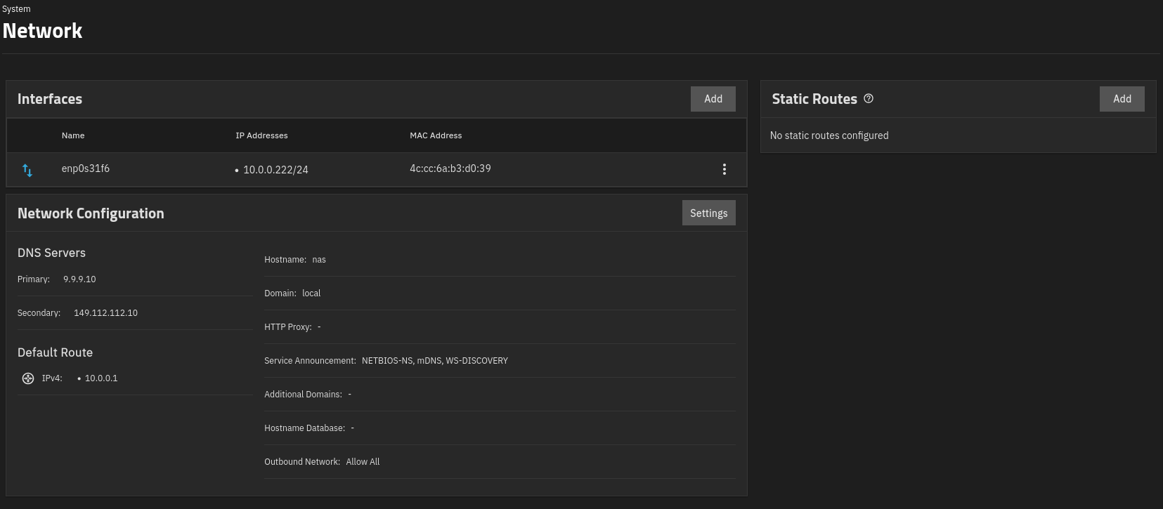

Can you show your TrueNAS network configuration? You may need to recreate the system-level bridge.
OK, that’s part of the reason why things didn’t carry over with the upgrade. You’ll need to create a bridge interface br1, with enp0s31f6 as a member. Disable DHCP on enp0s31f6 and enable DHCP on br1, if you’re using DHCP; otherwise, move the IP from the physical interface to the bridge interface if you’re using static addressing.
Once the IP is moved, unset & set the pool for apps to have Docker recreate new bridge interfaces for the apps; it will use the system bridge interface as the parent.
Docker still fails to start:

Wondering if you have a similar issue that I happen to get after boot where something wonky is happening in my networking (I blame my NIC & its drivers) & needs some manual cleaning on the interfaces.
Can I get the output of these?
ping google.com
ping github.com
ip address
and if you don’t mind a quick screenshot of your app settings:
Edit: Also if pinging github works, I’m curious if you’re able to go to apps > Discover & refresh the catalogue
Nothing in there for any IPs with 172.whatever?
Only thing I see there of even mild interest is a second bridge truenasbr0 but I see no way that it conflicts with anything at all really.
