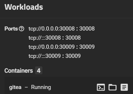

I have TrueNAS Scale running with immich and NextCloud installed.
I am trying to get Gitea installed using the same approach as for the other apps, i.e. from the TrueNAS Apps page.
I can get it installed but the WebUI says “Site Cannot be reached”. I have tried both http and https and the same.

Did you look at container log ? Any errors there ?
Gitea works out of the box for me
Err, can you tell me how to look at the container log please?
Hi @bugacha
thanks for your help. So I did a basic install of gitea using just the default answers for everything (i.e. I did not create and reference specific datasets but let the install everything on its own and it installed correctly and I can see the logs now. Thank you.
