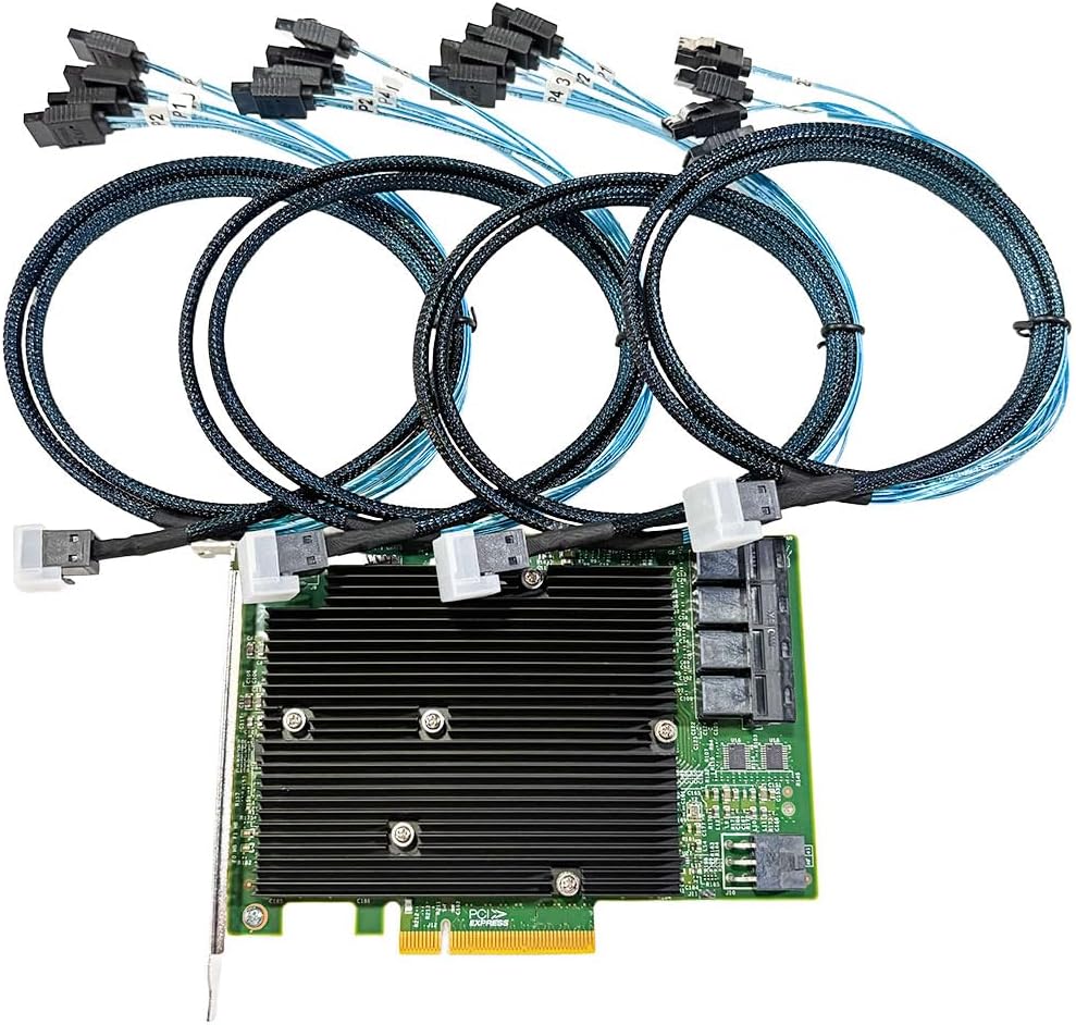

Many Thanks. I’ve been looking at this card:-
I see it has a large heat-sink attached. Do you think that would do the job and/or should I still see if I can add an additional fan? I’m not sure how I could attach a fan to the card/heatsink itself.
Thanks.
That card is not the best example. See if you can find a 9305-16i instead. The 9300-16i is a bit of a kludge (the effect is that it uses more power). It would work though
Yes you will definately need extra cooling. You can glue or screw a slim line fan to that card. Just make sure its gets lots of airflow

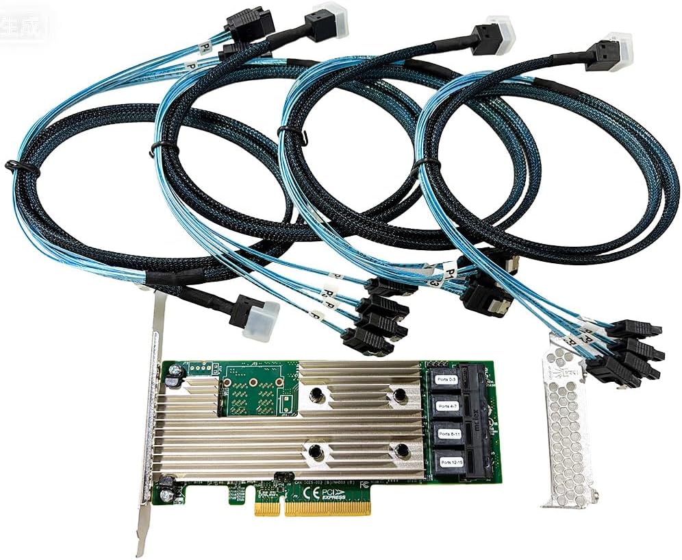

Here’s a 9305-16i card that might fit the bill:-
Would I still need an extra fan if I went for this option?
Thanks
Yes - any LSI card needs extra cooling if not in a DC type environment

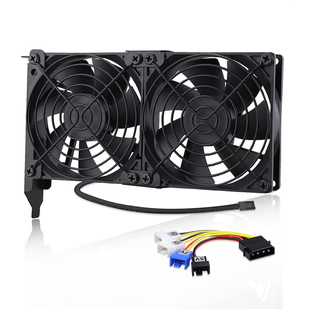

Okay, 9305 HBA card installed and working with twin fans immediately underneath it. Many thanks for your help and advice thus far. My next question is how can I check the temperature of the HBA card to ensure that the fans I’ve fitted are adequate?
This is what I’ve fitted:-
Kind Regards,
Peter
Stick your finger on the heatsink.
