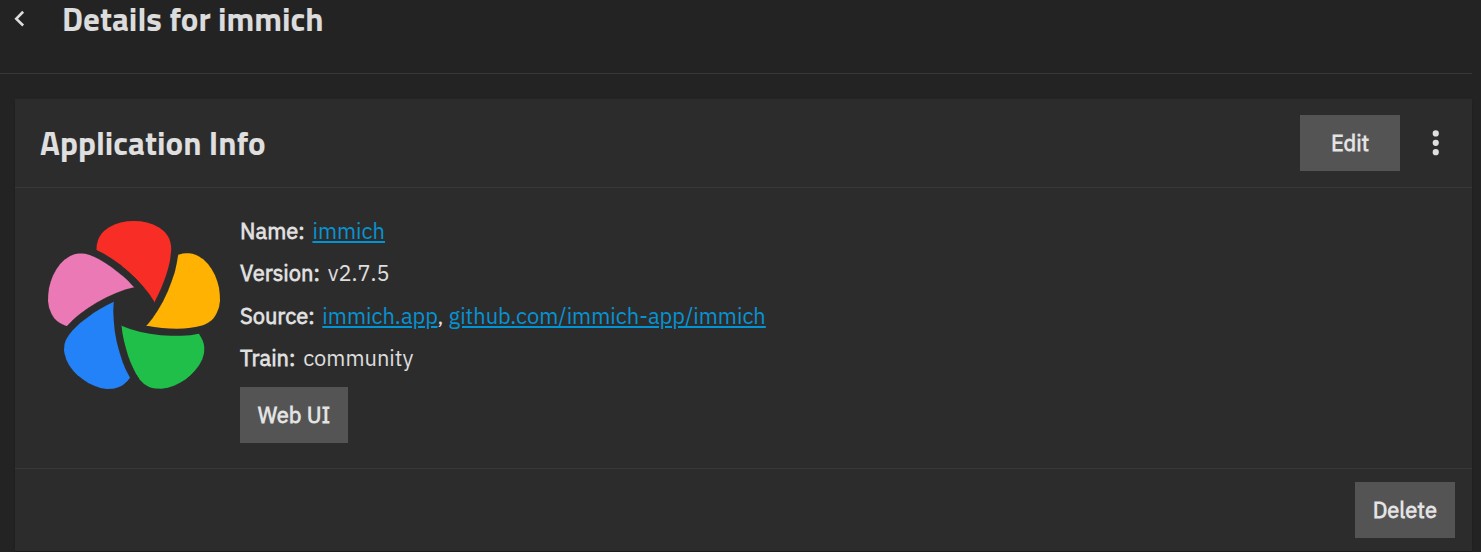

The immich version is:
App Version: v2.7.5
Version: 1.14.16

Thank you for testing that. Could I ask which version of Immich you were installing please?
App Version: v2.7.5
Version: 1.14.16

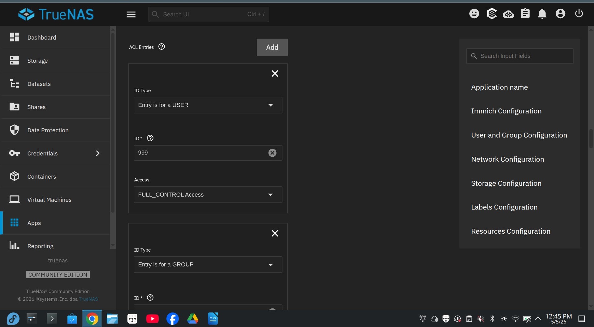

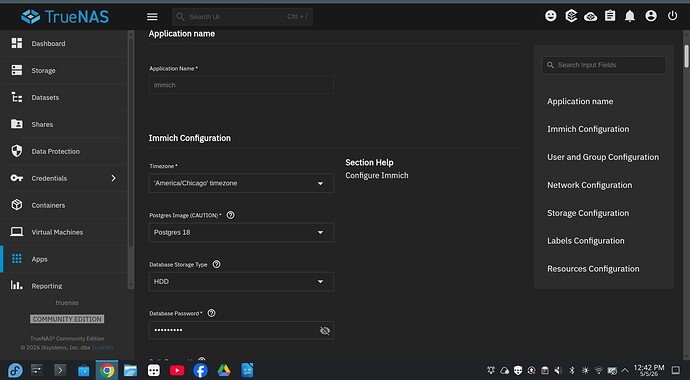

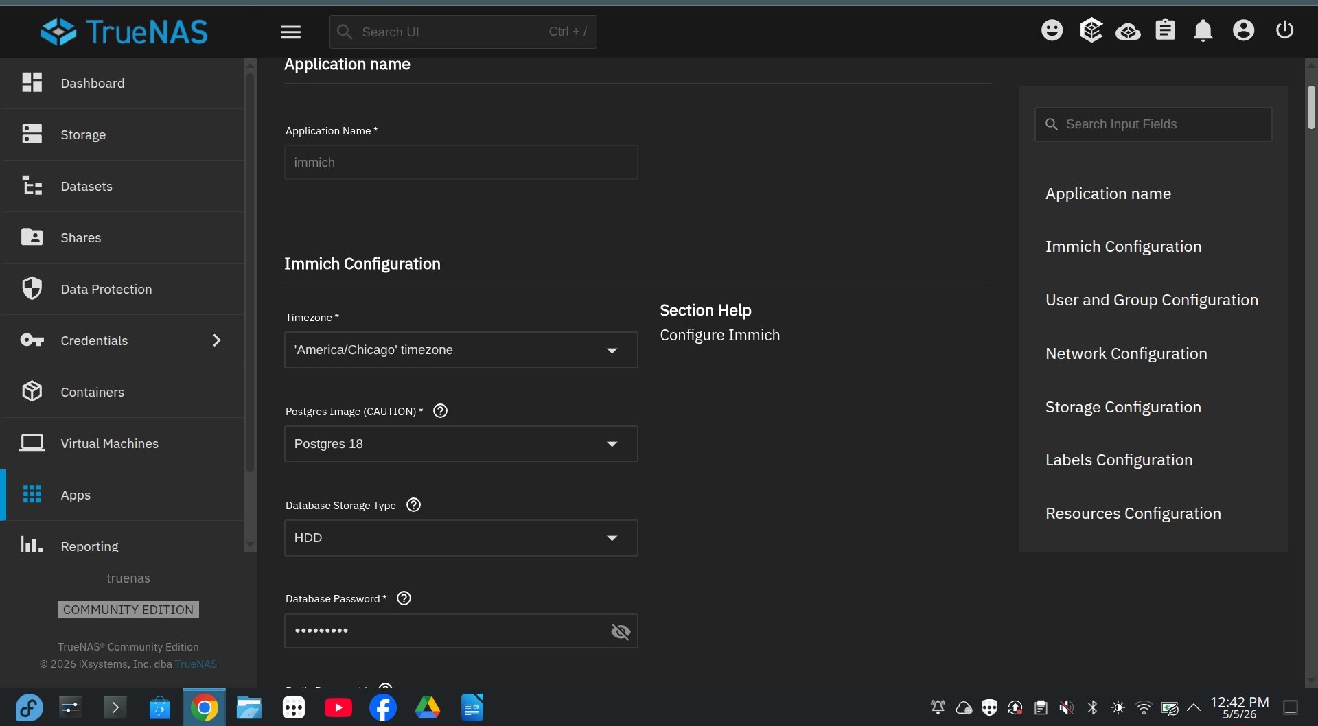

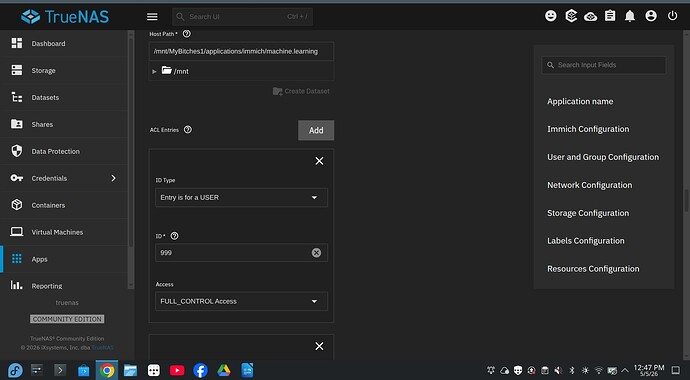

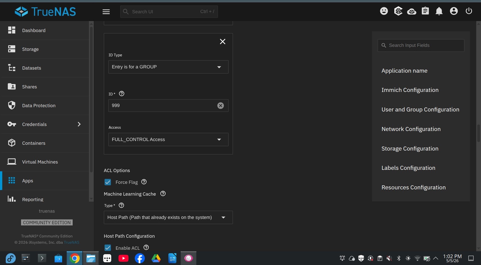

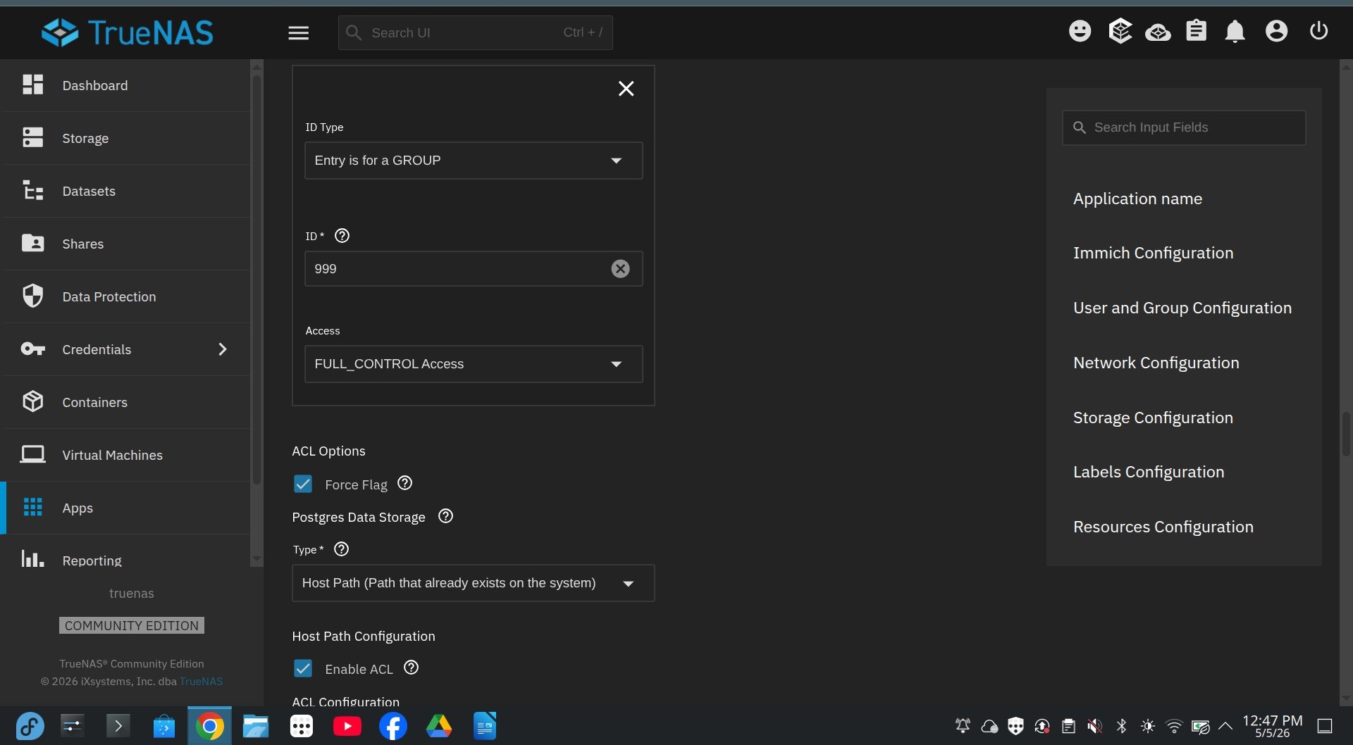

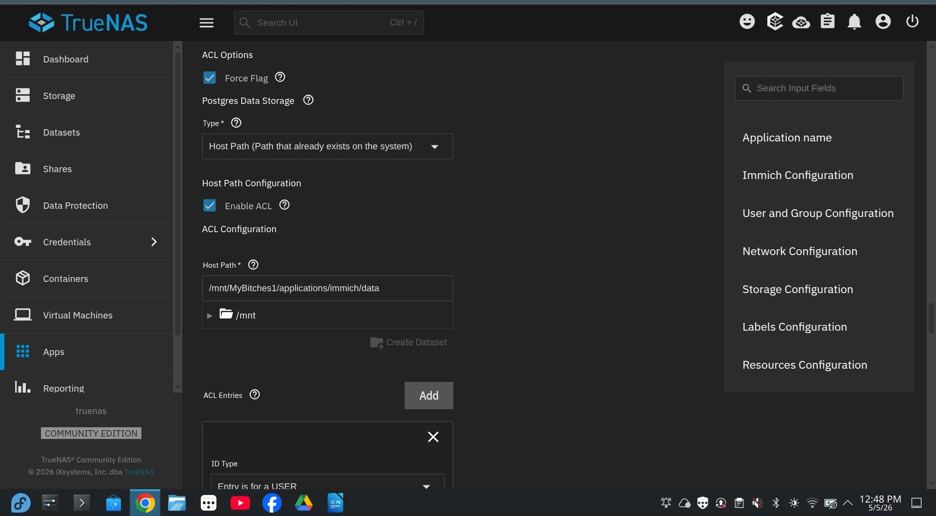

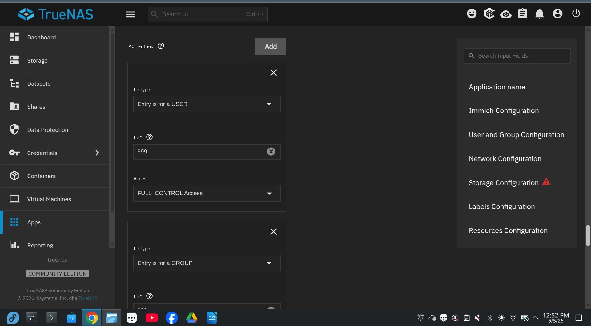

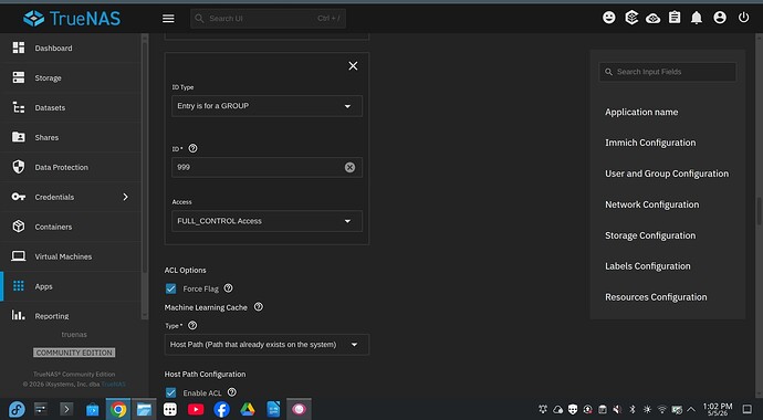

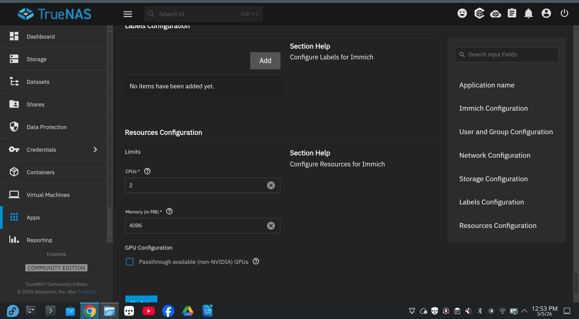

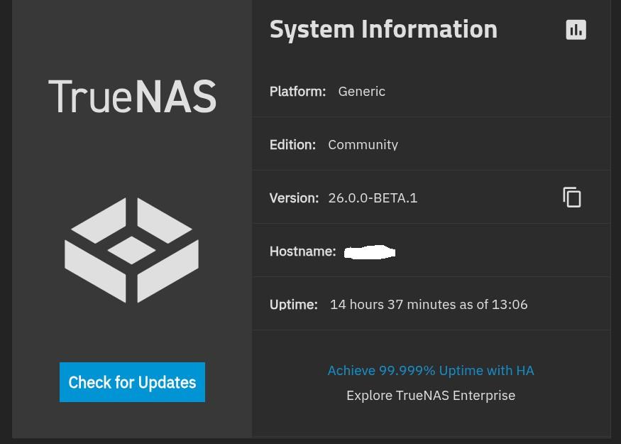

I’ve been having the problem with Immich since the Postgres upgrade to 18. I tried to force it with the trick that everyone is posting. That wouldn’t work.
I don’t know why or how, but forever reason, unless you set the ACL permissions (as you see in the attached pictures), the main at the top to 568 (999) wouldn’t work. Then for all others were you have to select a path for your data, “Force Flag” User and Group 999 and FULL CONTROL or you will get an error everytime. Basically anywhere that data needs to be written to disk. You have to force them even if you do the iX path.

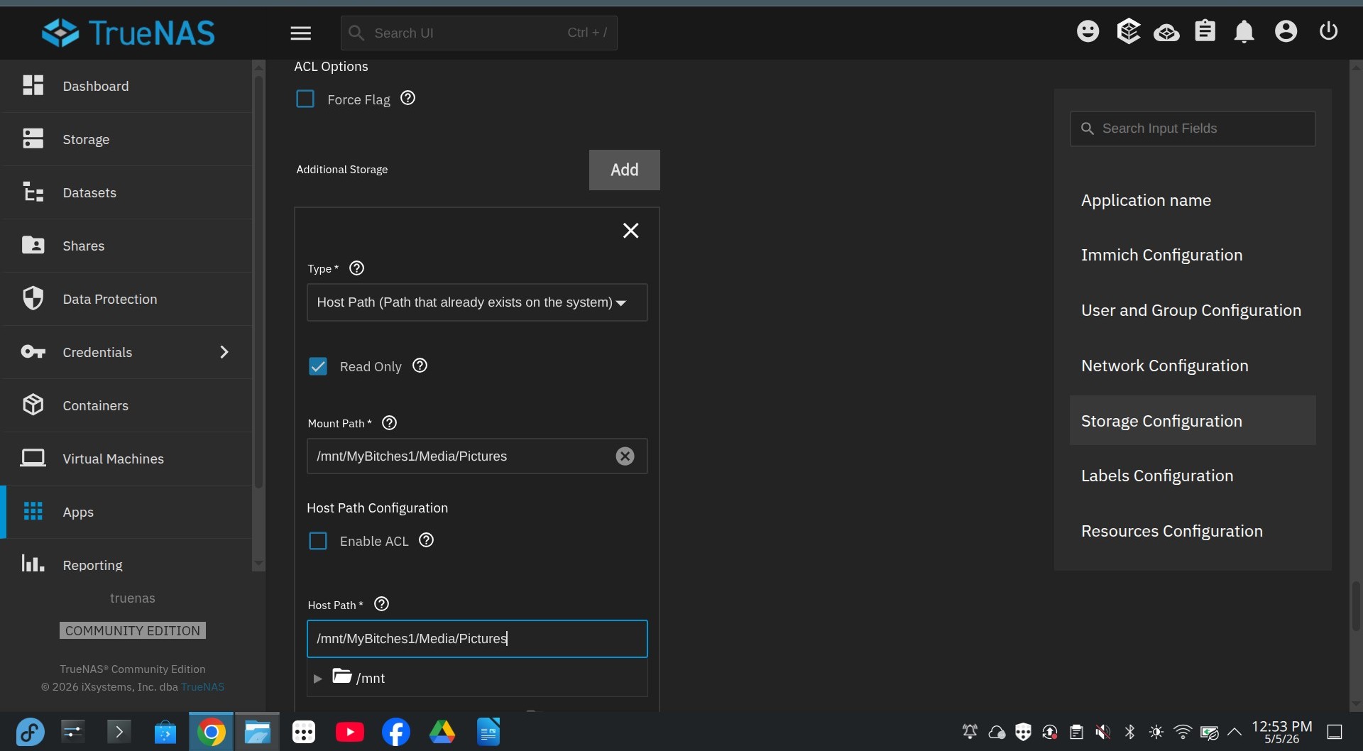

If you use additional storage, (old pictures you don’t want sync to delete) make sure you see this to read only!
I’m kind of new to this, but it seems that if TrueNas starts to load the containers and it says “running” then switches real fast to “deploying”, it’s almost always a permission issue. I had one other app, I had to do this to and specialize “addition variables” for items were the check boxes existed on the install screen.
