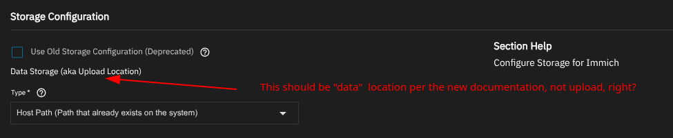

I’m running Immich in TrueNAS without any issues. One thing that would be helpful is being notified when app settings change. It would help with issues like this where the default storage location is being deprecated, but I would not have known about that if I did not go through all my app settings one by one looking for changes in the GUI for each app.
What I found is that the default location for storage is changing for Immich, being deprecated and being removed at some date in the future.

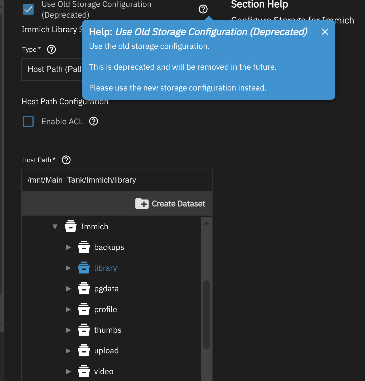

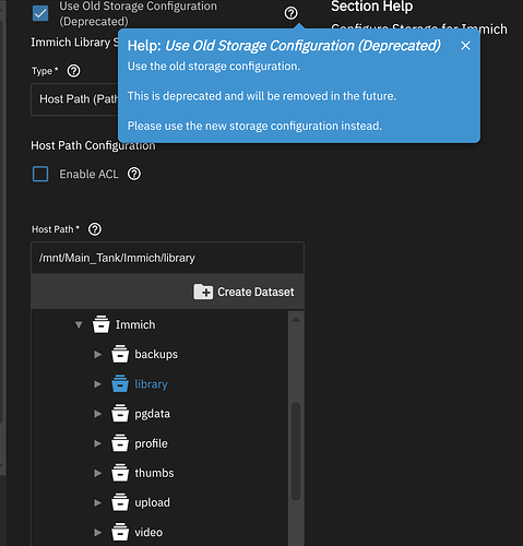

When setting up Immich, I did so following the detailed instructions provided by Immich on their site. It has worked absolutely fine. In doing so, I created individual folders for backups, library, pgdata, profile, thumbs, upload, and video.

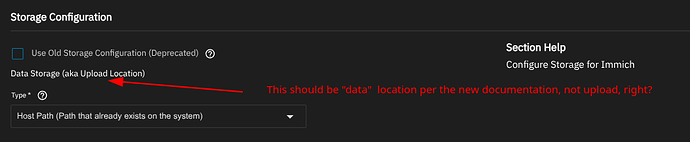

When I deselect the option to “Use Old Storage Configuration (Deprecated)”, I get only one option to select storage and it advises that this is the “upload” folder. I did this and it breaks.
There is no guidance on transitioning from the standard advised way to install the app from Immich TrueNAS [Community] | Immich or TrueNas about this adjustment and how to migrate from the old Immich advised setup to the new storage setup. To complicate this, I have my upload folder set up as a samba share so that I can review the actual images from another device outside the Immich system.
Please advise if anyone has found the proper way to do this - because the settings in the screenshot say that this will just eventually migrate (and therefore risk breaking many users’ systems).

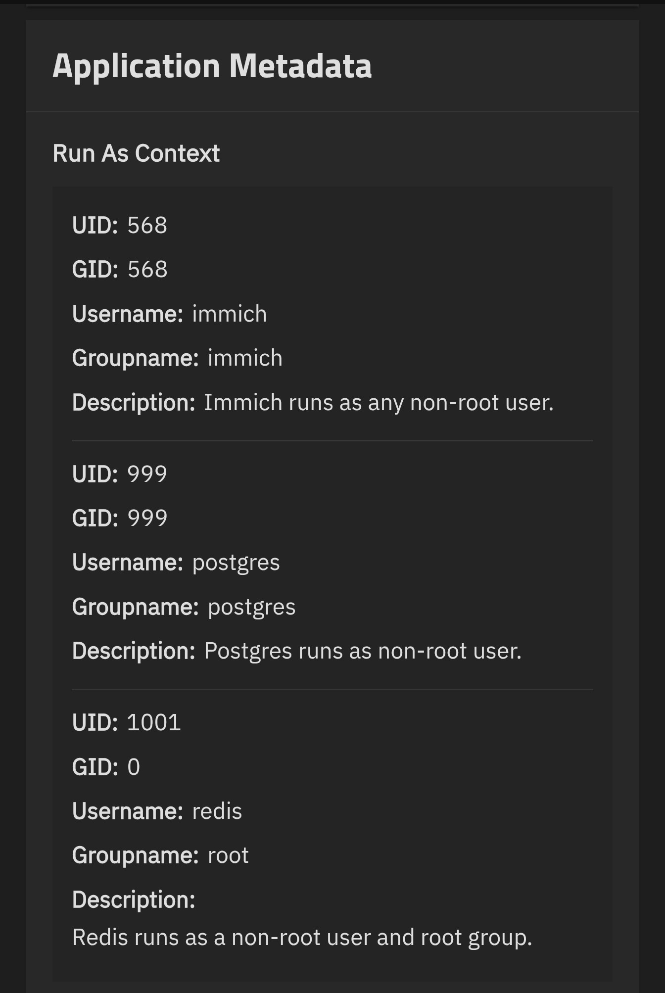

Exactly. Glad you got there. You could also add acl permissions for 999 to the PG dataset using the UI.

  1. Since I ran that command to chown the folders for 999:999 through a shell and not through the GUI, will they persist on reboot?
  2. I assume 999 is the UID for postgres per Debian’s conventions, but is that what “net-data” is per this screenshot?
Yes, they’ll persist, you’ve just changed ownership of the dataset. The builtin user:group for 999:999 corresponds to netdata:docker in Truenas–in the docker container I believe that is just docker:docker–but the important part is that you now have matching permissions for 999:999 in the container and on the host.

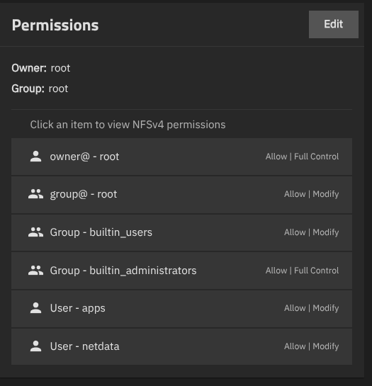

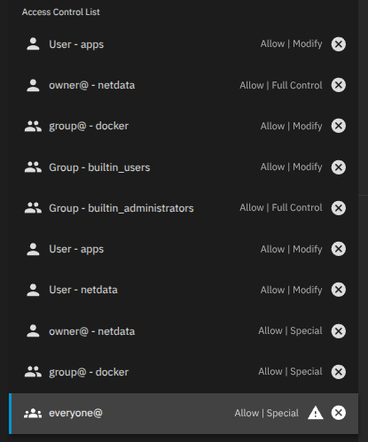

It sounds like a permission issue. If you look at my permissions in the screenshot, I believe you can copy the root permissions exactly as I have them for all datasets (recursively) to make sure that root has full access to everything. It is my understanding that Immich needs root to have full access/ownership to certain datasets. I went ahead and gave root full control and ownership to it all when I originally set it up several months ago.
The chown (change ownership) for netdata is only for the one dataset. I would not create a .immich file as it may interfere with what immich populates on its own (I don’t know).
That said, I don’t have port forwarding so if my permissions are more lax or “free spirited” I’m not worried.

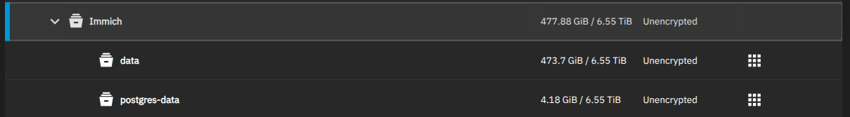

Here is the folder structure that I have now:

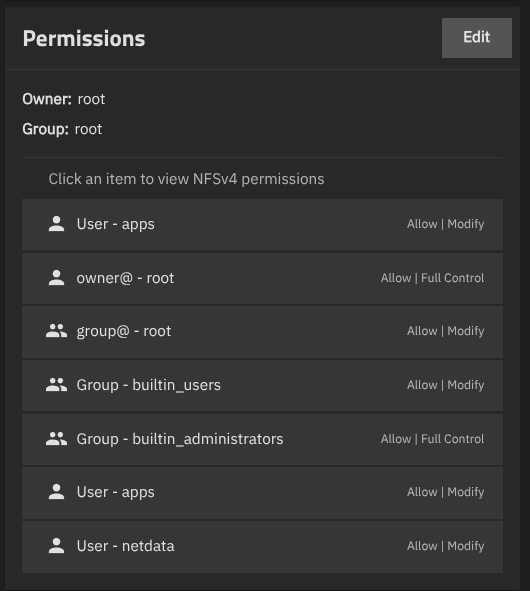

Here are my permissions for Immich:
Here are my permissions for the nested dataset “data”
And here are my permissions for nested dataset postgres-data:
You can probably not add the duplicate entries you see in my postgres data permissions. I am leaving them because right now it works. :wink:

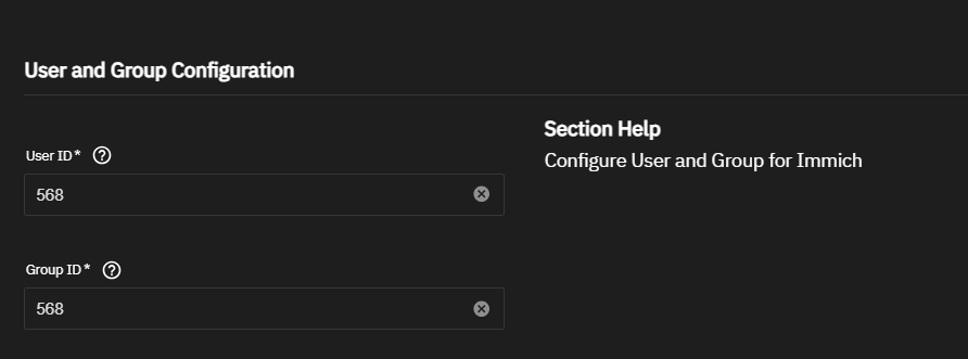

What user have you configured in the Immich settings?
